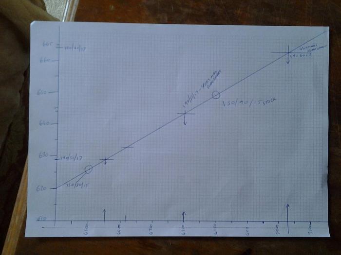

    I've done some research on tyre sizes and the effects on the gearing.
    The stock max rear is 150/90/15.....this equates to 4100rpm @ 110k
    Mates running a 150/80 and this increases the revs to 4500 at same speed..(he is always first to need fuel on a run)
    I'd hoped to fit a 190/50 but this is only marginally better at 4450rpm.
    Mono has been majorly helpful here and can supply a 190/60 with a decent profile...
    Going by the graph I drew up this would give 3850rpm at 110k
    This is more acceptable as its a lot of my time is spent in the 100-120 range....better fuel range .....and enough grunt on tap to roll on smooth....or drop a gear to kick it in the guts and rip the b'jeesus out of it....

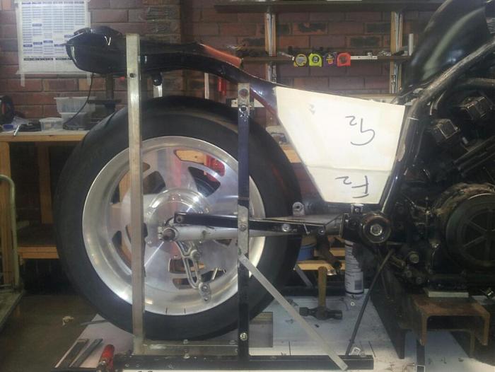

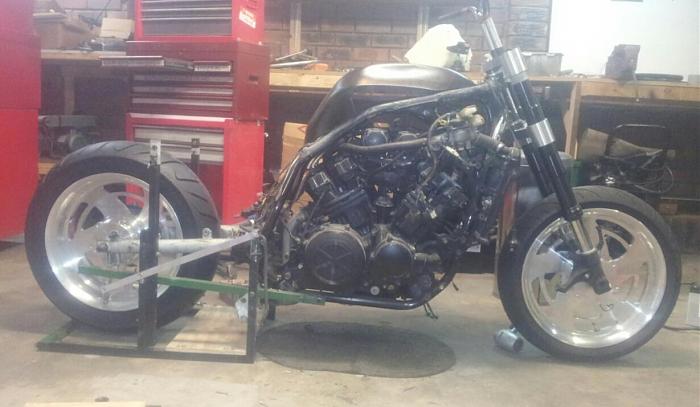

    Mono has a couple of good ones in stock that size Tony.
    There's also some 200's with very similar size (later plans...new arm,fatter tyre).
    As you see on the pics there's not even a subframe at the moment...the bike is set up level in my jig, with rake set as per xjr so whatever tyre I go for I'll build the subframe/shock mounts etc to suit.
    I looks into cos the yank forums were all like 'oh no..the gear ratios all wrong with 17"....have to change the diff'
    I politely pointed out that they could try new profile sizes....'Doh'
    Jesus died for his own sins...NOT MINE !

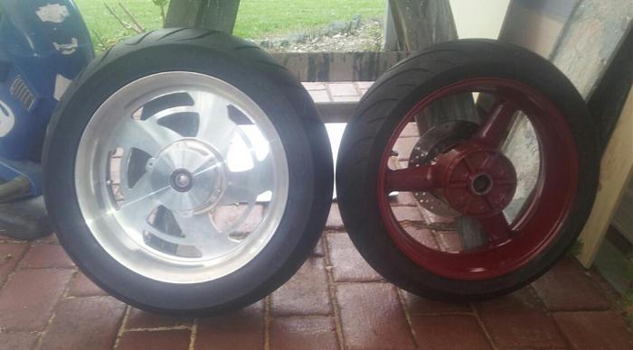

    Got the new tyre fitted today, HUGE thanks again to Mono.
Name:	2013-02-05 20.00.18-299190748.jpg
Name:	2013-02-05 17.18.35964802014.jpg

    7,146
    Looks good!
    Have you ran a tape around stock / new and compared
    the rolling distance ? I used a cloth tape around the
    wheel but just walking it across the garage floor would
    be a rough guide. What are you using for a speedo?
    stock cable drive or aftermarket?
  10. #30
    Said it before, and now I'll say it again; Love those wheels mate.
  11. #31
    Bloke with a smaller stick
    Apr 2006
    Brisbane, Qld, Australia.
    6,406
    Cheers Si,
    Stock is 2041mm, new one is 2085mm.
    Speedo is going to be electronic, acewell type, sensor mounted off the rear wheel.
    The wheels are roughly same weight as stock but lots of weight is being lost elsewhere....hopefully.

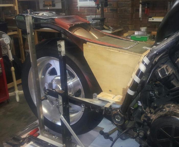

    Been working on the fuel tank of late...morphing a Suzuki across tank with the max tank...least that was the original idea....
    Decided it was easier to use the across one and custom build the under seat part.
    Started with plywood mock up to get rough shape and then made cardboard one.
    This was lined with fibreglass resin as a quick sealer to allow me to fill it with water to get capacity.
    Stock max is 15 litres...my cardboard one did away with the battery cutout and came out at 15 liters as well...plus the 4 3/4 in the across unit...sweet......
    So far I have got a COPS system sorted for it to do away with 4 stock coils, plus I'm going to mount an in tank fuel pump.
    There is also an ignition unit on the market that can run the vboost module...the size of a fag packet...(stock is huge)

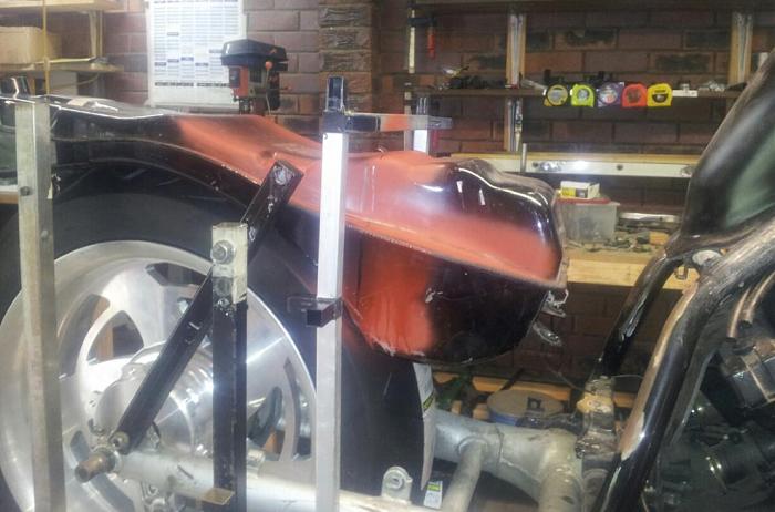

    Started the steel one today....1.2mm cold rolled.
    Had a go at bending sheet....just one weld instead of using 5 separate pieces...worked a treat.

    when you finish it mate it might be a good idea to use one of those fuel tank sealing kits to stop it rusting
  18. #38
    Apr 2006
    6,406
    I will mate...tank will be sandblasted in and out, powdercoated and then sealed inside.
    It will have and inspection plate on the top,under riders seat so I can make sure its fully coated.
