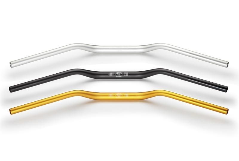

I thought I'd lash out on the bars though and not do the usual renthal fatties I had on the R1 so I went ABM Superbike bars in Black..

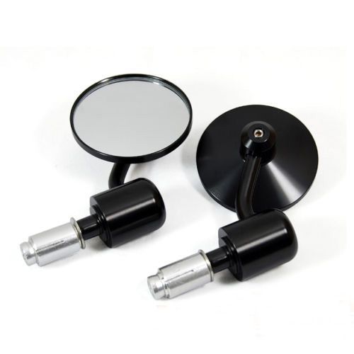

Good old bar end mirrors were the go to I have a thing for them

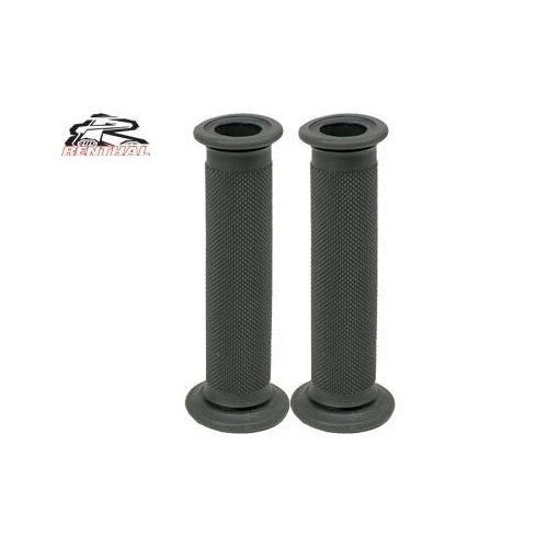

Also went for some Renthal road race grips never tried em but heard they were alright.

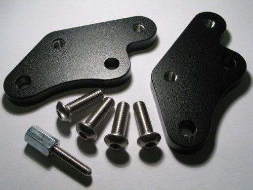

Because I'm a lanky fucker I found these riser/lowering plates for the rearsets so 1" back and 1" down to maybe make it a lil bit more comfortable.

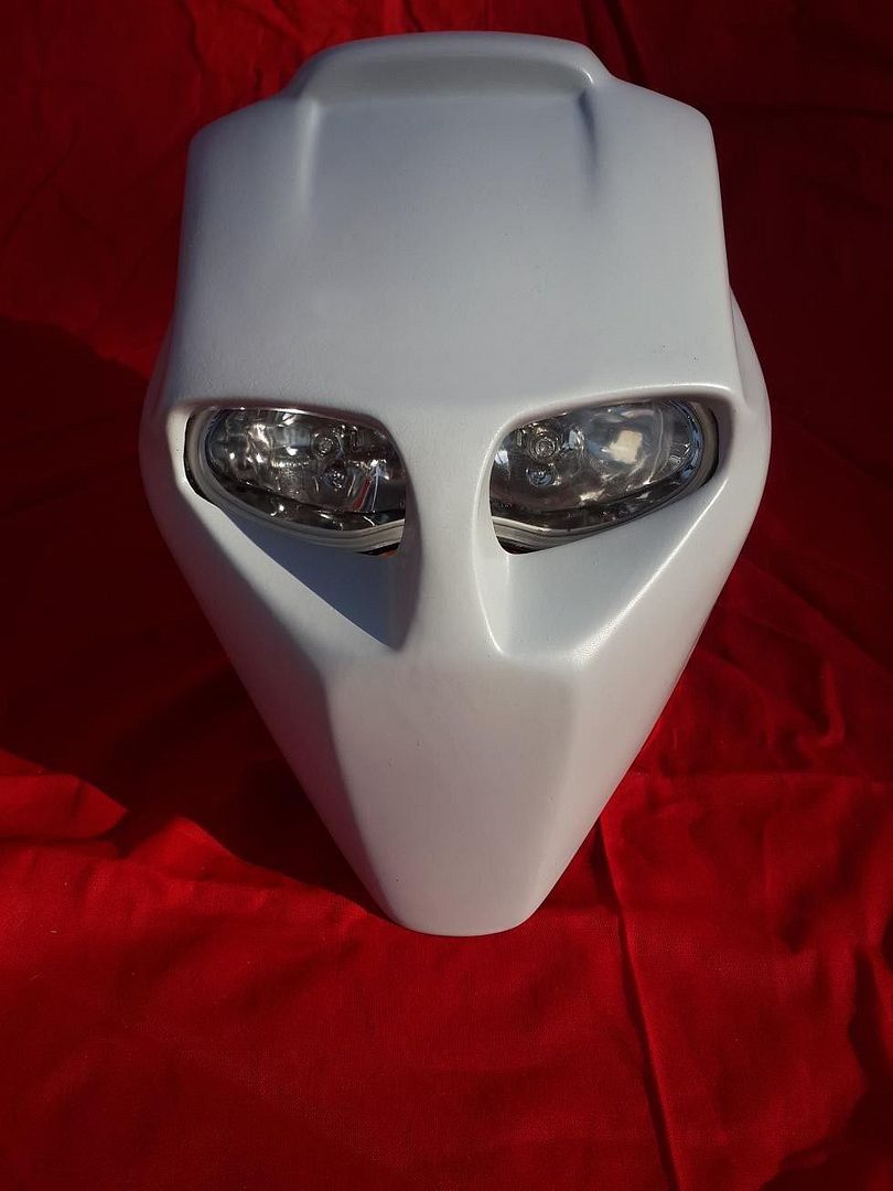

And went for this headlight unit, I've always liked them so I thought why not..

Good stuff Gitzy, love the motivation. By the way, I have those Oberon bar end mirrors and they are a serious pain in the arse. They are fully clamped with hex grub screwes so you can't adjust as you ride. You will spend hours getting them set up and set. If you leave them slightly open on the grub they slip and even then, you only have lateral movement. They do look good though.... :)
Nothing like NFR looming to kick you in the arse Si, them mirrors are actually el cheapo $28 I did put a set of Oberon ones on the R1 and know exactly what you're talking about though. I have these cheapys on the bandit and DARE I say I actually think they're better quality than the $160 Oberons.

Also pulled off the rearsets tidied them right up and refitted with the lowering plates, came up a treat and should give me a little more leg room. Fitted a new brake clevis too from vandriver left over one from the TL collection.

Risers came in the post today, drilled them bad boys and now we have some funbars..
