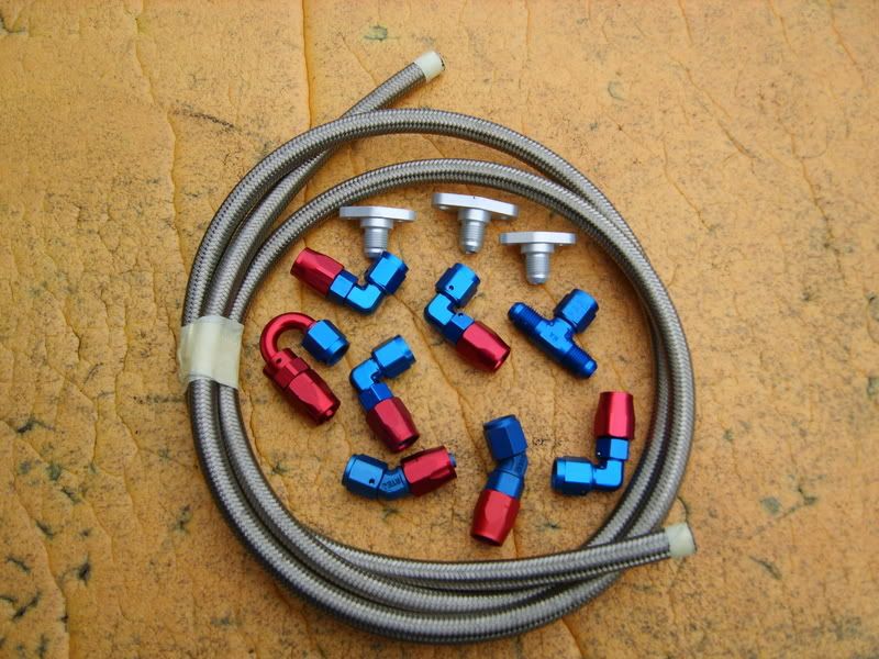

The progress is at a standstill at the mo, due to the fecking easter holidays and no feckin postal service :( Bunch o cunts, ive gotta work so why cant they :D. Im on solid late shifts for the next 3 weeks so at least i'll be indoors for the posty to arrive and can squeeze a few hours work on the bike daily before work ;) Today i striped all the anodising off the Noz kit fittings and im gonna get Sparts polishing mops on it tommorow, black snot here we come ;)

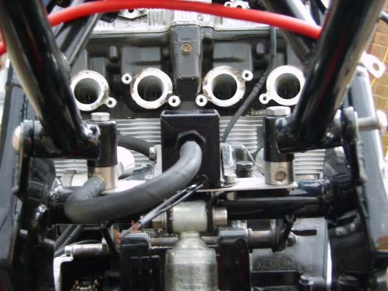

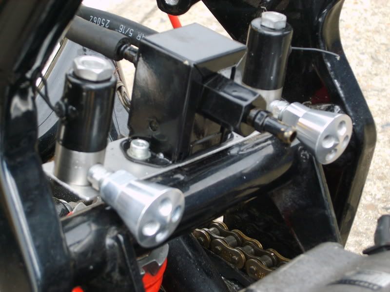

Mock up plate for the Facet fuel pump and and nitrous solonoids, they fit snug above the rear shock , on show but stealthy at the same time [8D]

Rear shot....ignore the chunky fuel line its just for the mock up:D

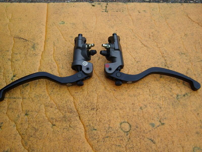

My elipsoid headlights turn up from Germany after waiting 12 feckin days and guess what.....one in black...one in chrome...DUMB CUNTS :(Also i found out that i cant get any high pressure leads for the Noz kit for another 2 weeks :( And to top it all off my clip-ons and billet fuel cap aint even getting made until next feckin week :(My patience is running extremly thin as you can tell.. The only saving grace is that i do have my Brembo master cylinders to play with ;)

had me worried for a second. looked like your subframe mounted to the nos solenoids:) looks good!!!
Im a happy bunny today :Di got these jublys to fit
http://i3.photobucket.com/albums/y61...h/nicepair.jpg
but one emblems red and the other silver. cant you send them back?

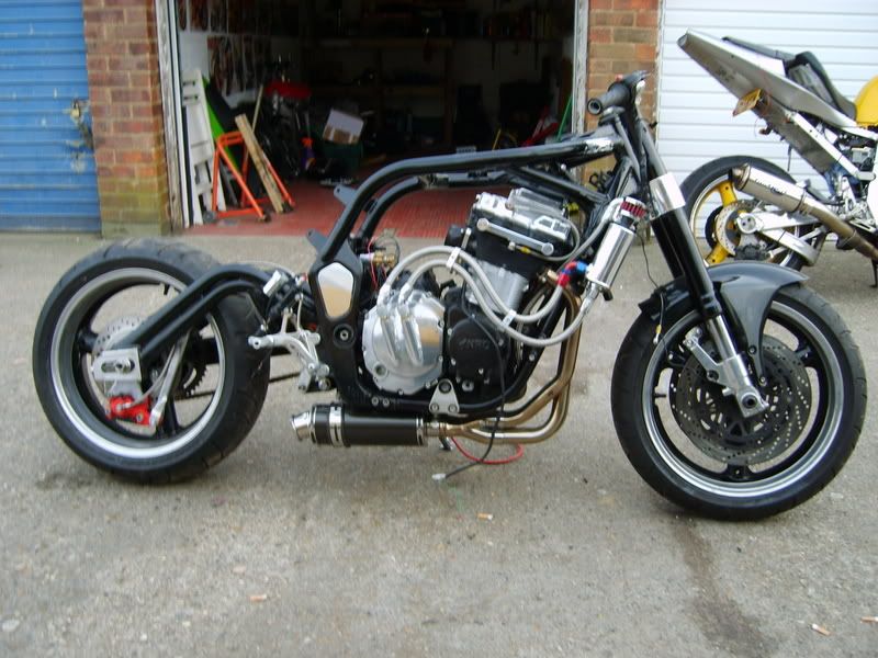

Got her all stripped down ready for all the new plumbing ;) Ive fitted the nitrous fogger adaptor plates to the carb rubbers, made a the bracket to mount the fuel pump and solonoids above the shock mount, im just waiting on the high pressure lines and thats finished. The rear cam lines are off, im gonna try something abit different with the routing of the cam feeds and bring both lines out to the nearside of the bike and up around the carbs,but i dont know if i can get the run i want or how tight this is gonna be until i get the tank back from the painters[?]All the front lines are off as they are all 3" to long, i should have new lines early next week. New switch gears fitted and a Q/A throtlle, ive gotta get some cables made up next week as these go up and over MX styley;)
http://i3.photobucket.com/albums/y61...itch/strip.jpg
I did notice that too:D, but these are the best looking pair ive seen since Pamela Anderson in that swimsuit[8D]
nothing a fine point sharpe wont take care off
That can was made for your build M8 , Fark'n Gorgeous..........Im sick and tired aswell waiting for parts.
i just noticed something interesting on your bike, the rear brake arm. How does it act under hard braking? Typically you want that pointing at your CG, its obvious why its not but it would seem to make the rear end squat heavy under hard rear braking, not locking it up ofcourse. just curious
I just noticed chocolate subframe bike is in the background as well. What's he doing? It looks less brown?
Gix, the chocolate subframed water boilers been in my garage for about a month now as Terry has bought my Blade off me. If my build takes any more turns for the worse it looks like i'll be going over to the TT on his old boot :(I will have to get a sticker made up...."THIS IS NOT MY BIKE"
Shifty, the torque arm works well, but i hardly use the back brake anyway. My m8 Spart has got the same arm and had trouble with the torque arm ripping the threads out on the upper fixing. He did the TT 2 years ago without a back brake atall and his front brakes leave much to be desired[:0]
Ive juust found out why the emblems are in different colours...the white brake is a CAST unit and the red clutch is BILLET and £40 dearer;)Quote:
