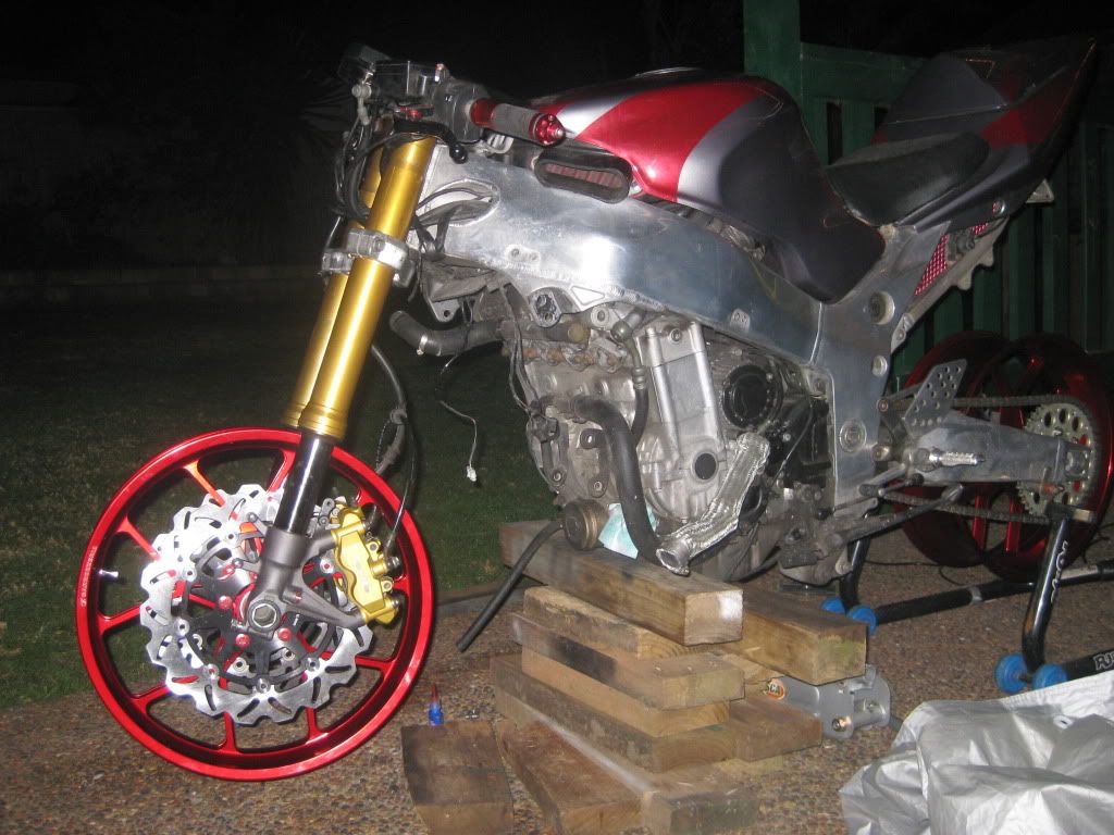

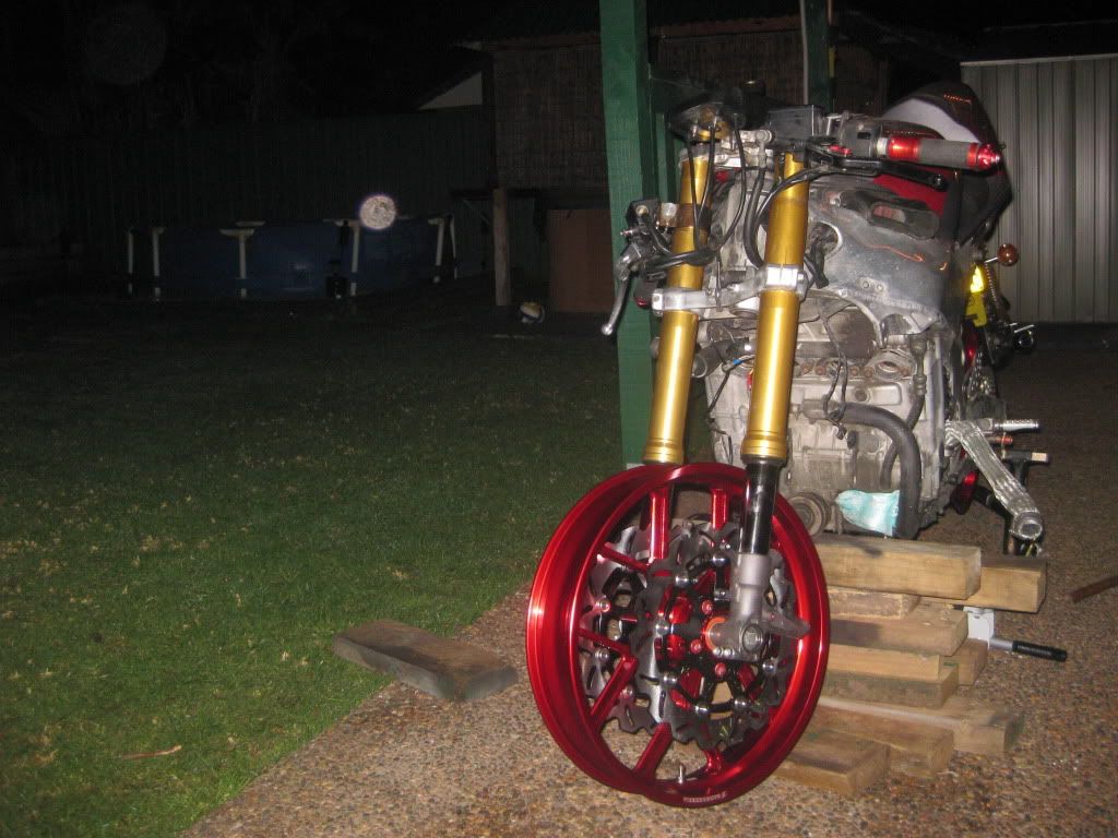

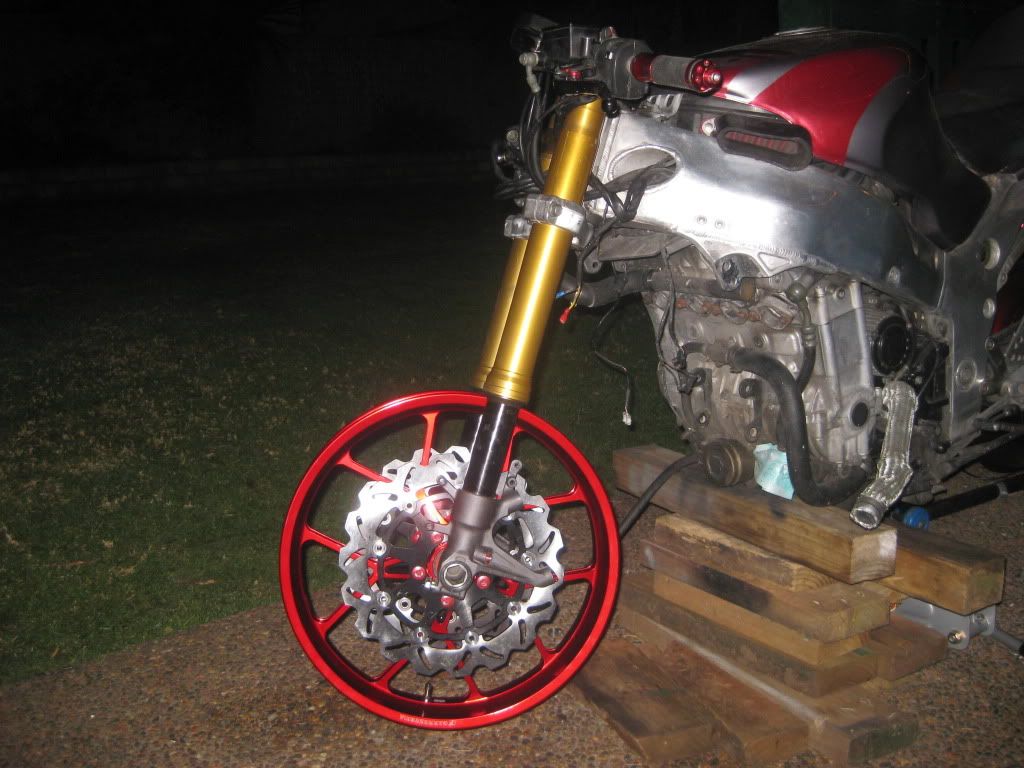

I want to use the Zx9R triples so I sanded of about 2mm from the inside of the lower yoke tube holders so the forks will fit.
For the top yoke I'll have to make some shims.
I removed a little from the subframe using a mini belt sander so now I can use the larger diameter K4 rear axel.

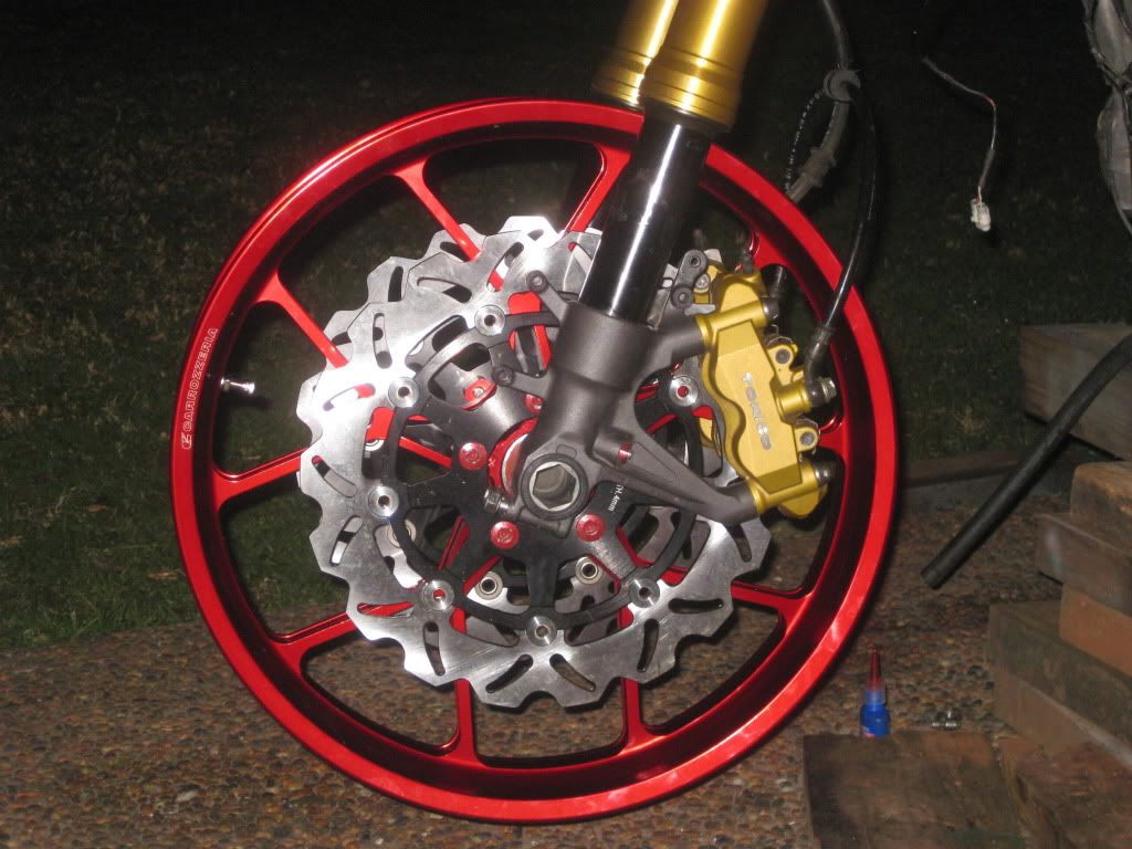

Nice wheels. When did they rock up?
fark me they look sweeeeeeet mate
Awesome rod
Thanks Guys.
Tim: He emailed me on the Friday to say the wheels were ready, they arrived the following Wedneday.

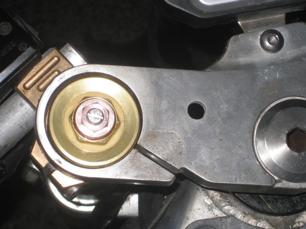

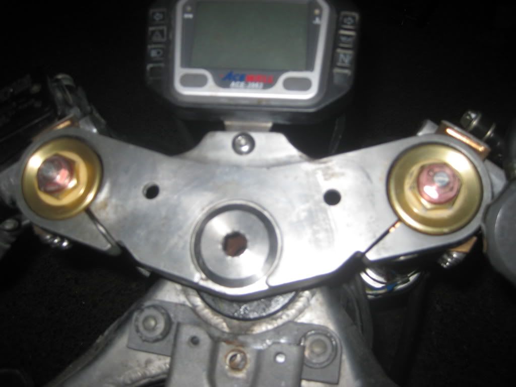

I need to make some shims for the top yoke to fit the fork stems.
http://i209.photobucket.com/albums/b...a/IMG_1101.jpg
I'm thinking 1mm thickness should do the job.
http://i209.photobucket.com/albums/b...a/IMG_1106.jpg]
