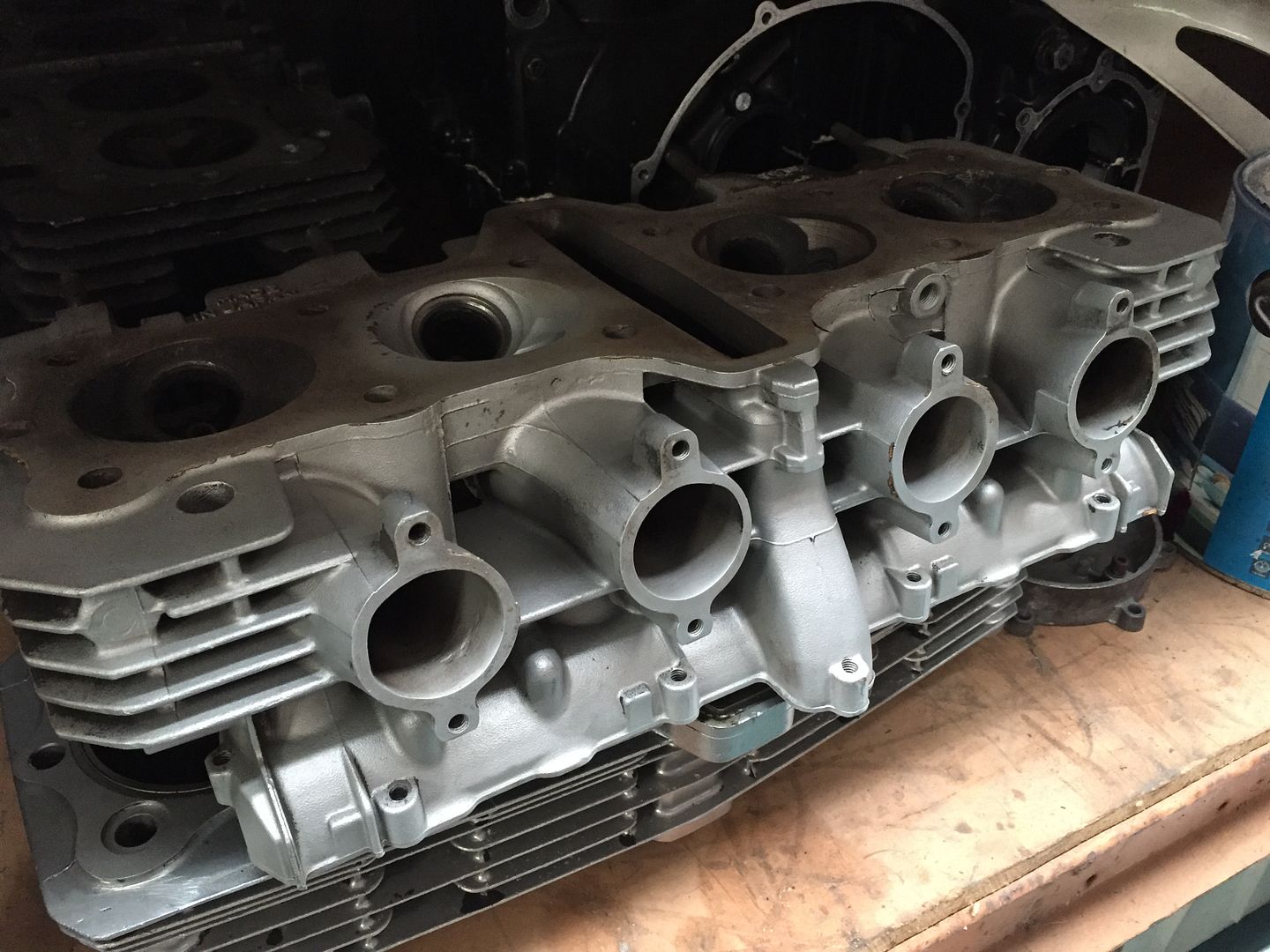

just tried it on a fucked uni track gpz 1100 head I use for mock ups
the uni track had the tuffest paint of all the z's and is a real pain to remove back to casting
using a medium glass bead that I use in the wet blaster it took it off like butter while at the same time
didn't rip the surface. Still not the tool for softer alloys but this in cognation with the wet blaster will work
very well, cut down on time and hard work on the wetblaster. All this still didn't stop it costing me nearly
1K by the time all is said and done tho...... fuck I could have built 5 bikes for what this exercise is costing me lol

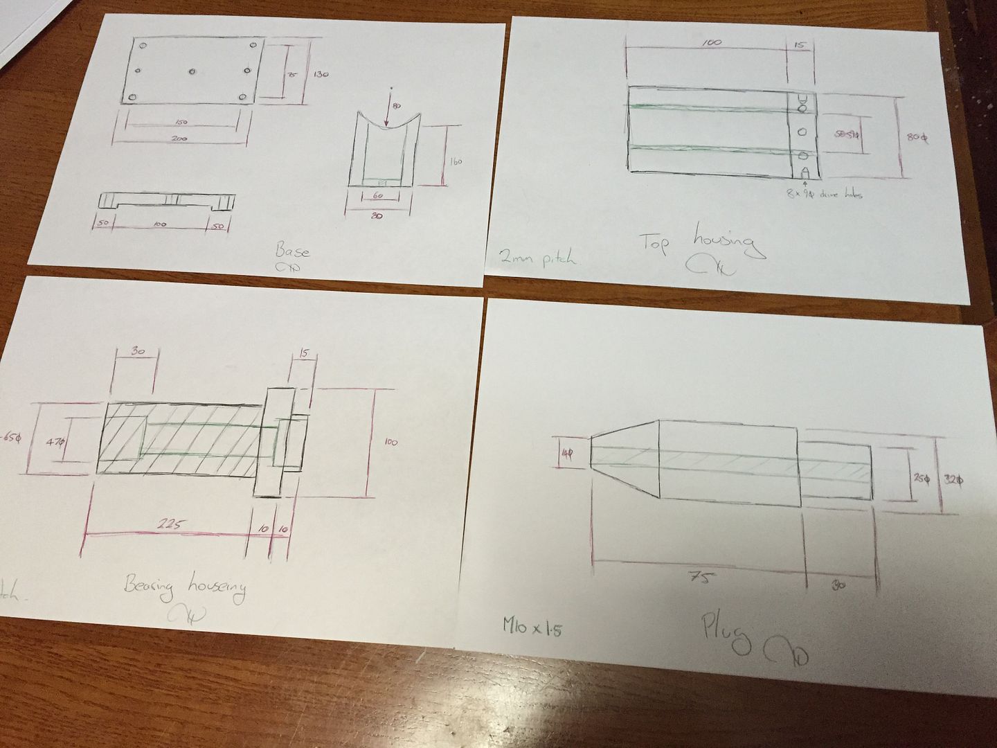

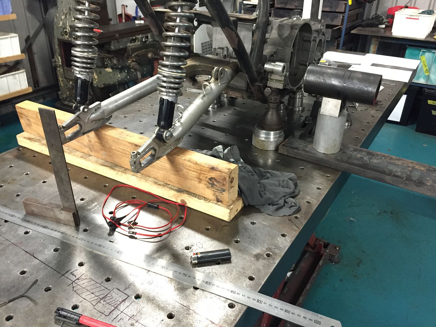

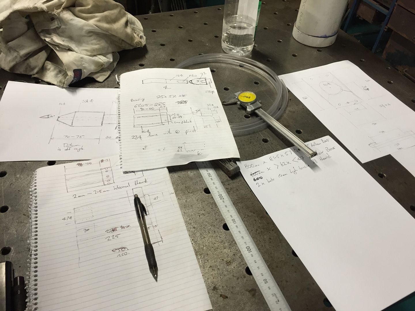

I have a sore head, started final design of the pivot mount for the frame straightening jig.
I am using a cross between a moto jig brand, motoliner brand and the automagic of japans custom jig as
a guide to a design that works with my lift jig table
http://i1136.photobucket.com/albums/...psyqbmdi11.jpg
http://i1136.photobucket.com/albums/...pskqktzlzh.jpg
turned into these
http://i1136.photobucket.com/albums/...psnwrhe5ej.jpg

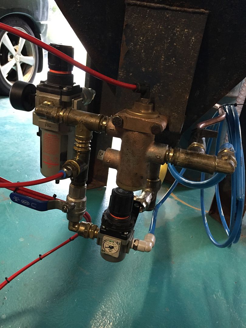

had a look and found I had almost all the spares to add the air dust blown down in the new blast cabinet
http://i1136.photobucket.com/albums/...ps49ysq8yz.jpg
the manifold is a old durin styled kit we have modified to fit the sc14, yes they are cast in bust plates.
They are atm missing the springs and yes it will be draw though. With the positive displacement
he will have constant boost no matter of rpm, spring tension is set above boost pressure. My understanding
it is only under backfire conditions that they can be pressed open and once the energy spike has passed
they shut. It has been std fair in cars and racing for some time, don't make it ideal and I can always just wind extra
spring pressure and block off but from what I have been told it should work fine.

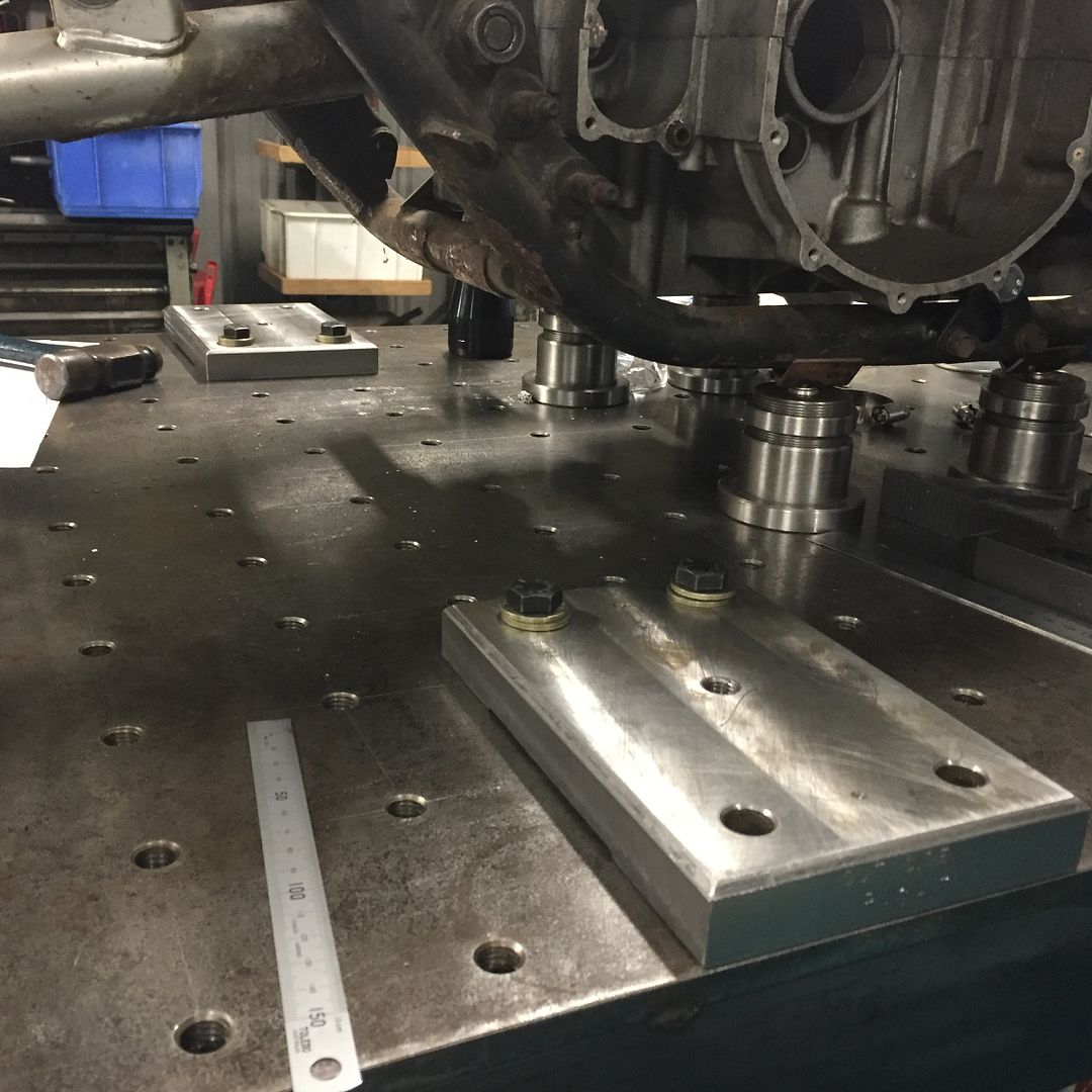

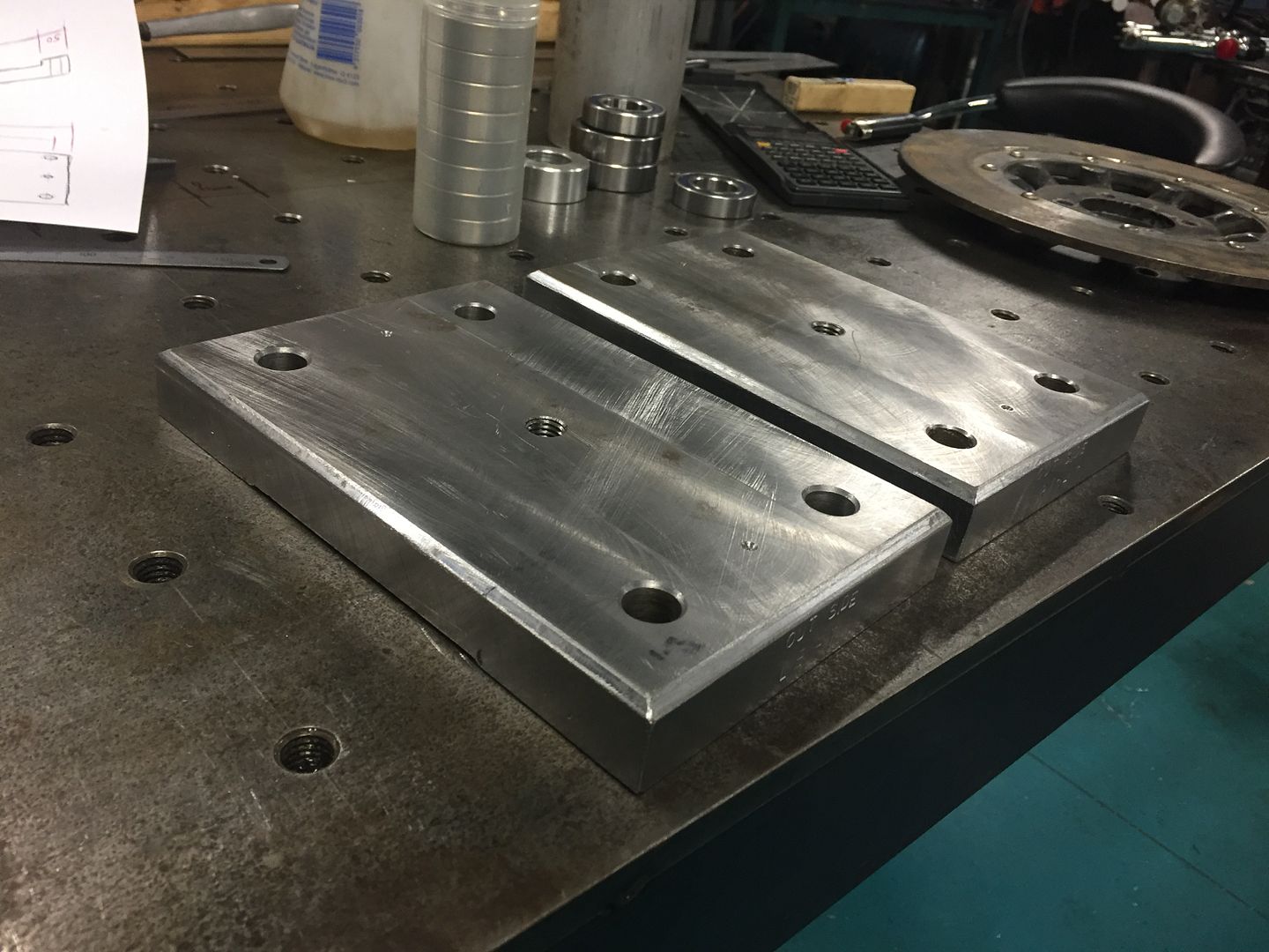

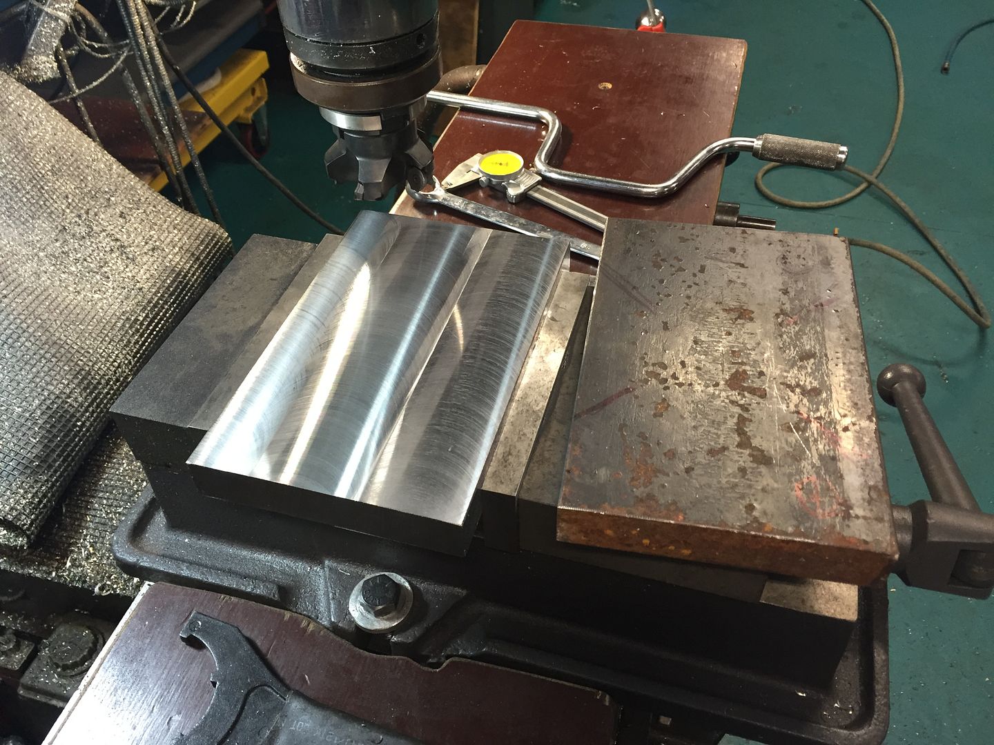

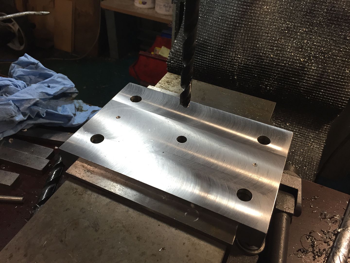

Friday night machining, these are the bases for the swing arm pivot mounts for the
Frame straightening jig. 25 x 130 plate I had laying round.
http://i1136.photobucket.com/albums/...ps52noqc4a.jpg
http://i1136.photobucket.com/albums/...psgie03akt.jpg
http://i1136.photobucket.com/albums/...pswj4n6x6r.jpg

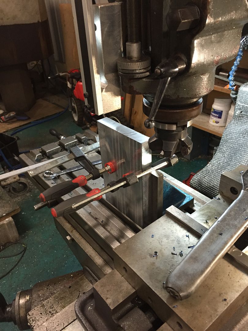

Spent the night finishing the machining on the bases of the
new frame jig. These will hold the frame through the swing arm pivot.
http://i1136.photobucket.com/albums/...psmlrfqqwq.jpg
http://i1136.photobucket.com/albums/...psuknnlckt.jpg
