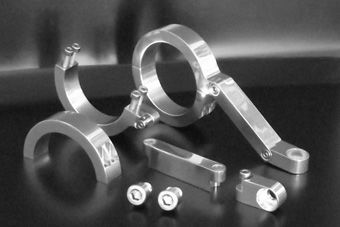

The bike is looking nice, How about something like these for the headlight mounts if you like billet>
http://i1250.photobucket.com/albums/...ps27dca924.jpg
Hmmm they do look good. Do you have a link?
All the way from Germany, They make some damn nice billet reservoirs & im sure the headlight brackets would be just the same quality, Available in many different sizes to suit just about all forks
http://translate.google.com.au/trans...ed=0CDkQ7gEwAA
http://www.ebay.com.au/sch/thospa72/..._from=&_ipg=50
http://translate.googleusercontent.c...whBJbPb5GDcuhg
Easiest way would be to email Thomas, His english is pretty good for a German>
