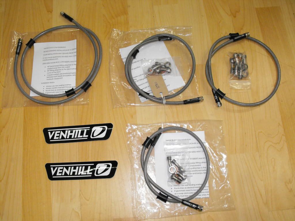

Brake/clutch lines, all extra length to reach the superbike bars.

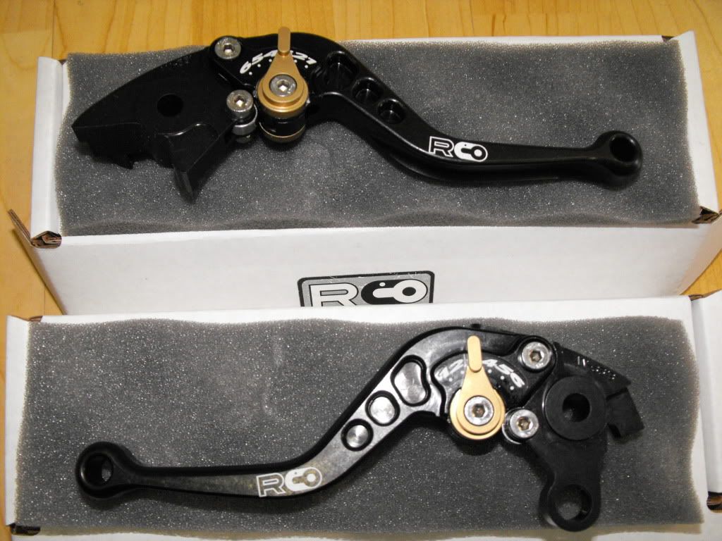

CRG Spectrum adjustable shorty brake/clutch levers,

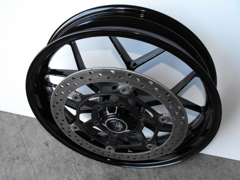

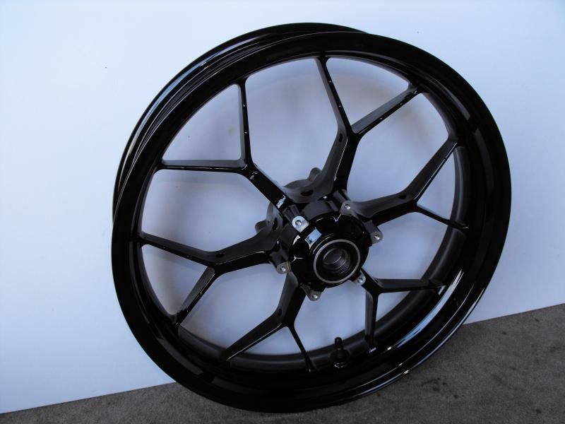

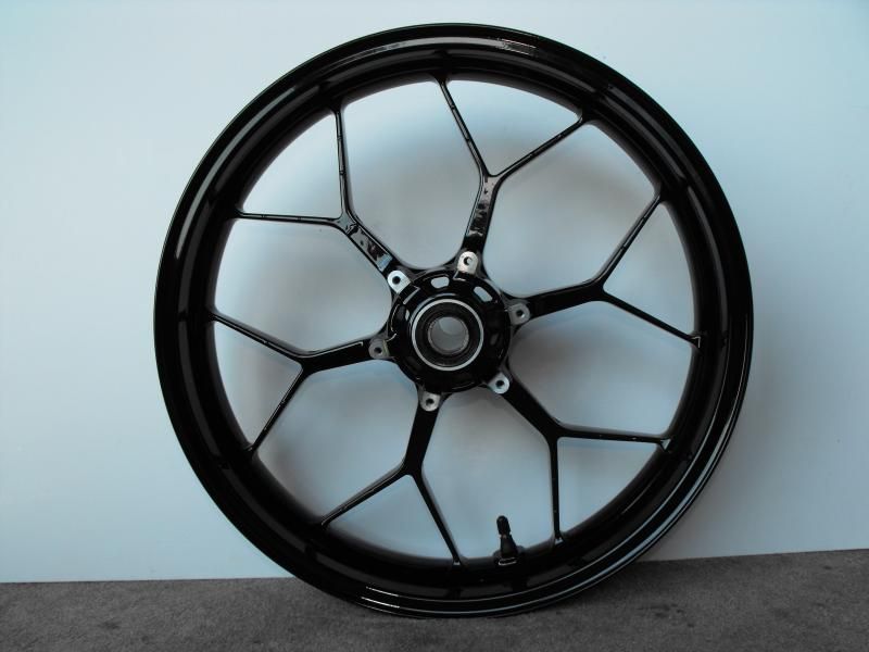

Front wheel,
http://i1101.photobucket.com/albums/...0/DSCF5059.jpg
http://i1101.photobucket.com/albums/...0/DSCF5061.jpg
http://i1101.photobucket.com/albums/...0/DSCF5075.jpg

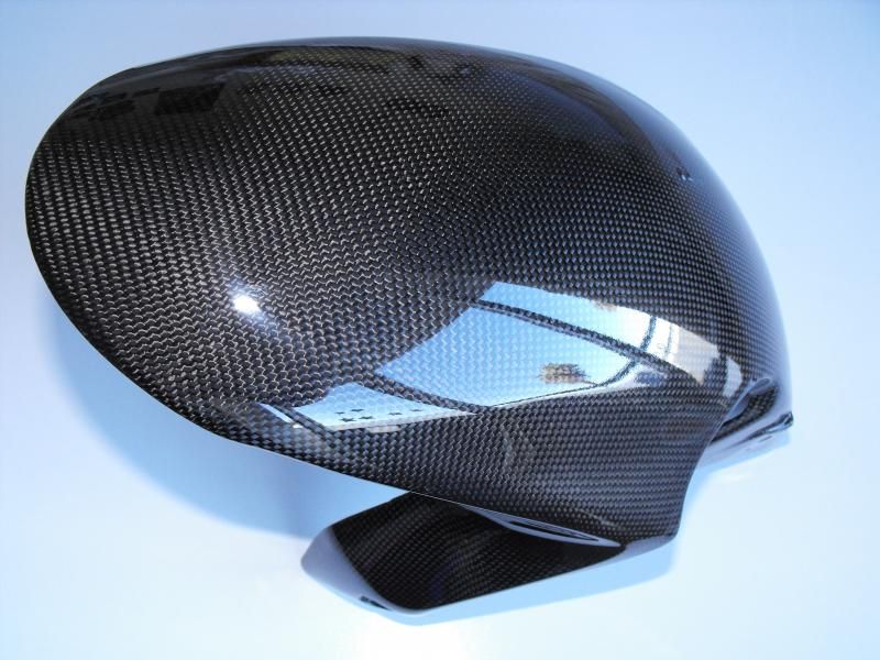

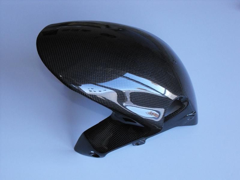

CBR1000rr carbon fiber front guard,
http://i1101.photobucket.com/albums/.../DSCF50102.jpg
http://i1101.photobucket.com/albums/.../DSCF50092.jpg
