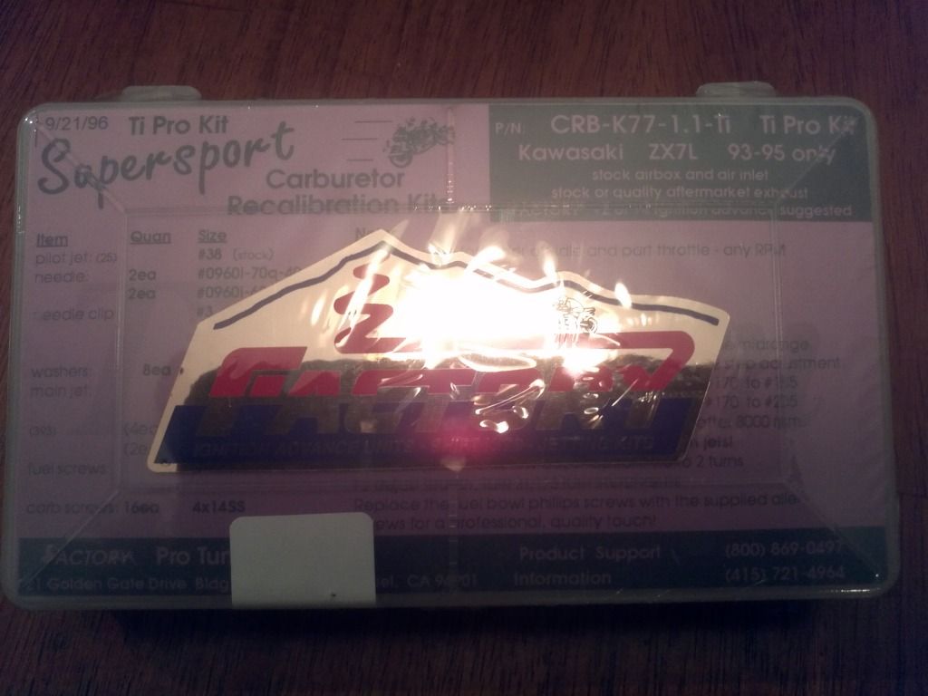

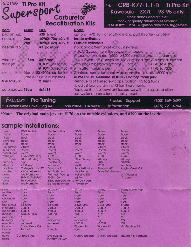

The other day I received a new Factory Pro ( CRB-K77-1.1-TI ) carb kit from the USA, It is the slightly more expensive kit with the Titanium needles
I got it for $100US including postage to Aus, Not bad considering the retail is normally $169US + postage
Basically took it out of the mail box & opened it up & laid it all out on the table & got started straight away
After doing the clean air mod / Float bowl mod it was running a bit rich with the 180 / 200 main jets so now I have gone back to 170 / 180 jets
I slid the new needles in (They are slightly different for the inner & outer cylinders, More fuel for the inner cylinders basically) & put the clips in the middle position for now
The pink sheet that comes with the Factory Pro kits have a diagram showing what jets & settings race teams have used on the same bike so I went with the one that had the same elevation (around sea level) & set it up the same, Only takes about 5 mins to remove the carby's now & about another 10 mins to put it all back together re-jetted with the new needles also
Fired it up & it is real snappy now, It was obviously a bit too rich before & hesitated a tiny bit due to the extra fuel it did not need, There is certainly no hesitation now & it revs out nicely
Its running & sounding more like a formula 1 car compared to how it was when I got it, Sounded like it was a diesel engine almost

Here you's go, Thought I would add this, A bit of a guide which may help others, Would be pretty similar for the ZX9 too

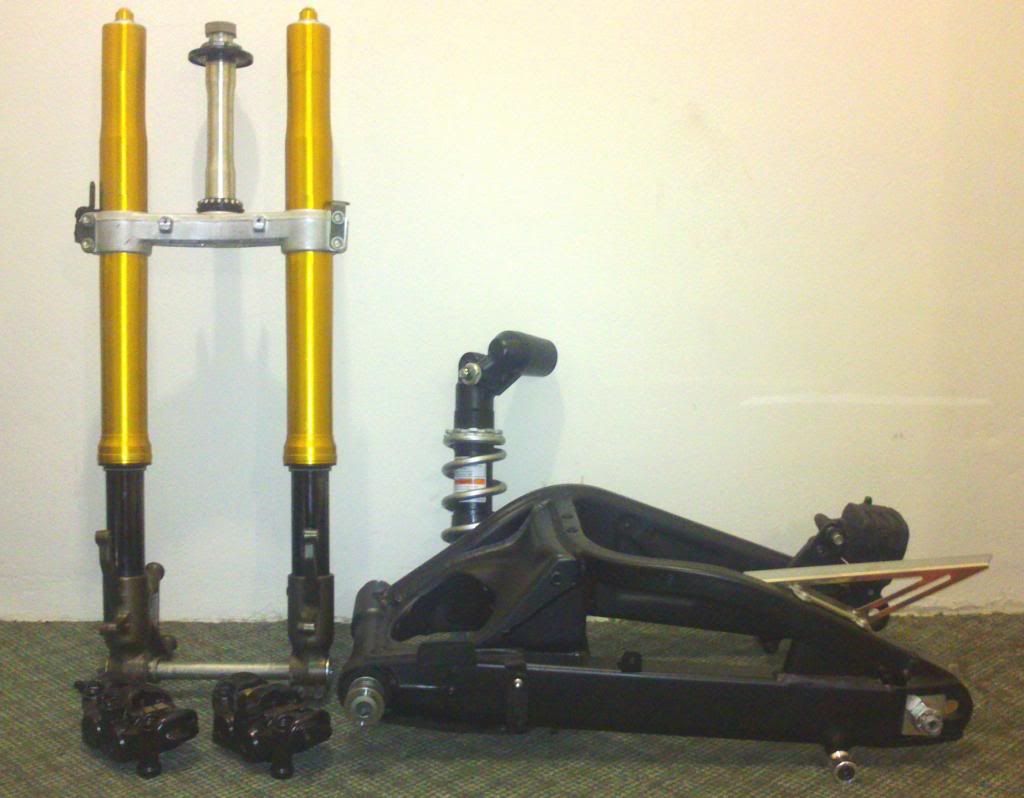

Well I could not help myself, Decided to do some major weight reduction, ZXR 750.10R coming very soon
05 FORKS N SWINGARM, 08 REAR CALIPER, 08 FRONT CALIPERS

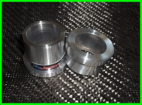

SPACERS TO FIT THE ZX10 SWINGARM INTO THE ZXR HAVE BEEN MACHINED, SWINGARM WILL GO IN TOMORROW

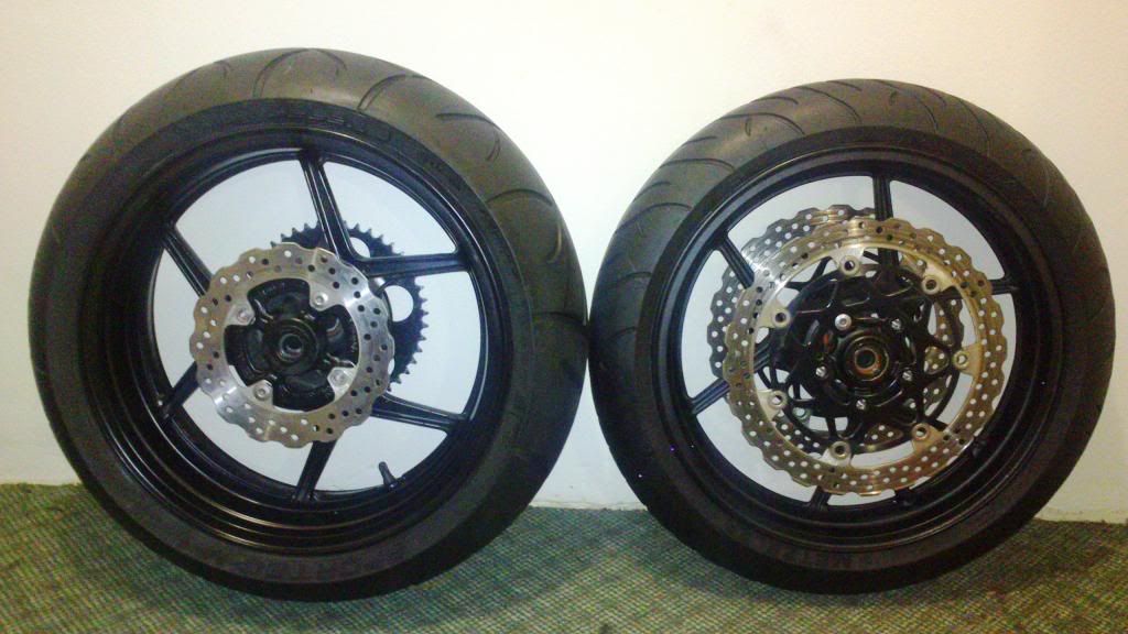

05 WHEELS (BRAND NEW FRONT WHEEL HAS NEVER HAD A TYRE FITTED BEFORE) LARGER ZX14 FRONT DISCS
WAITING ON A SET OF CALIPER & DISC BOLTS TO ARRIVE

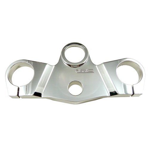

BILLET TOP CLAMP, WILL BE DRILLED FOR BAR MOUNTS (THE IGNITION IS BACK IN THE CENTER TOO)

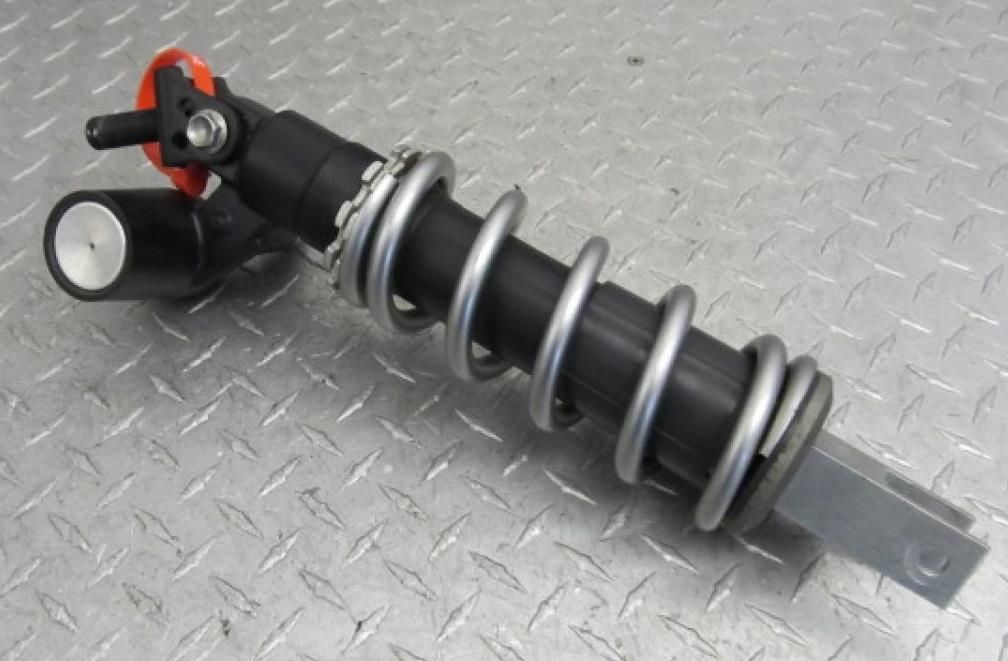

THE SHOCK IS LIKE NEW

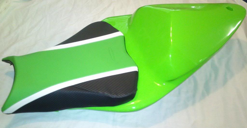

This will be the next stage maybe after rego, Just need to find a ZX6 09+ subframe & taillight & graft it on>

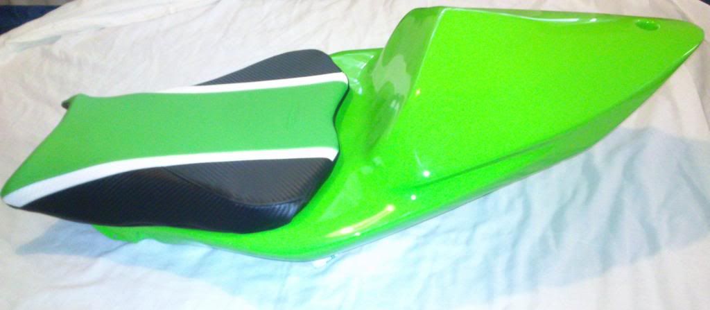

I picked up a brand new in the box ZX6 09-13 Powerbronze $293 RRP seat for $100 & the Armour Bodies 09+ ZX6 single seat tail for $155 with pretty fresh paint

Too impatient, I just fitted the swingarm & the rear wheel n caliper, Shock will go in tomorrow I spose & thats the rear end done
Waiting on an as new ZX10 black front guard & an Allballs ZXR 750 steering bearing kit to slide onto the ZX10 triple clamps, Hopefully they will be here tomorrow & I can start on the front end?
The ZX10 shock is in, The lower triple clamp now has a ZXR 750 tapered bearing, The forks are sitting in place with the front wheel & a new black front guard fitted, waiting on the top clamp to get here then the front end can be finished off

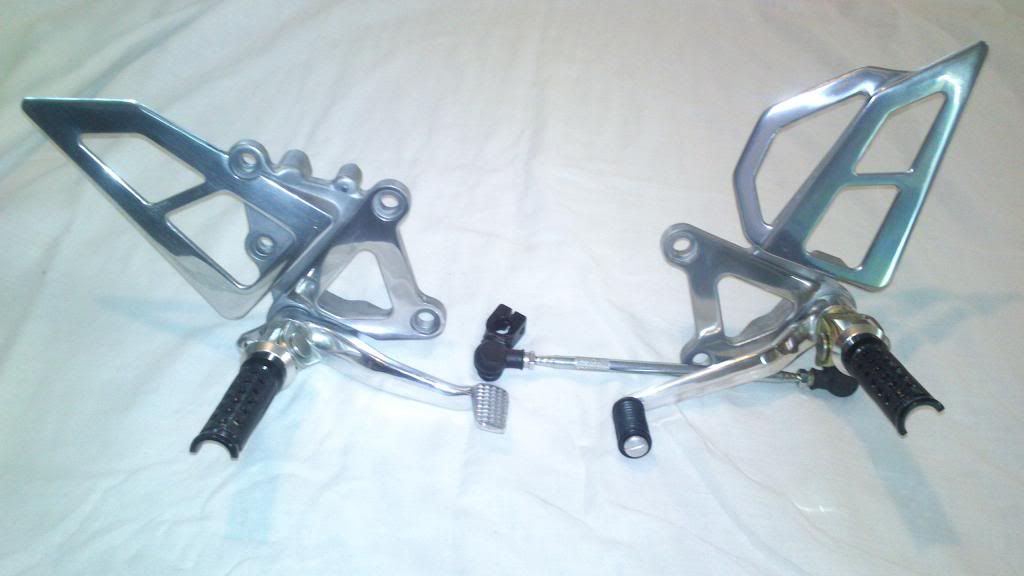

I have been slowly collecting the parts (when they pop up cheap on ebay) to put together some new stock rearsets & I finally have all the parts
I got hold of some brand new (NOS) brakets, Billet pegs, Peg mounts, Footpeg pins & circlips, Gear lever, Link rod setup & bushs for the brake pedal & gear lever, They are about as new as can be, The brake pedal is the only secondhand part
Gave the brackets, Gear lever & brake pedal a quick polish
Would be nice to find some aftermarket preferably black rearsets of some type but did not want to spend hundreds on them just yet, Anyone know of a nice reasonably priced aftermarket option? ZXR 750 & ZX7 use the same rearsets so should be a few different types available? The stock rearsets I have would be valuable to someone doing a stock style restoration on a ZXR 750 or ZX7

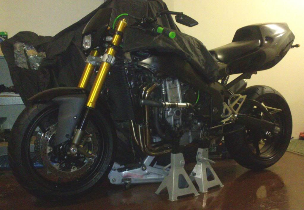

Little bit of progress, I dont like the gold forks much with all the other black going on, They will more than likely be polished soon
I have a new 520 EK MVXZ chrome chain on the way & I am still waiting on the top triple clamp to turn up, Its going through customs now so I will hopefully have it tomorrow or next week then I can get the bars back on, I have changed my mind enough here & there but the latest change was well worth it, Its time to get the little bits left to do sorted & get it on the road, I will change the tail after that
I like how the satin black frame & swingarm look & the front guard meet the satin black sides to the gloss black in the middle up to the tank & tail (when the tank is fitted anyway) The ZX10 black front guard just ties it all together nicely, Not the best pic but you's will see what I mena later on with some better pics
http://i1250.photobucket.com/albums/...ps1468122e.jpg
looks good dude.
paint the forks black too.
it needs more black.
Yeah the lower triple clamp is now black, I thought about doing the forks black but I was thinking it might be a bit too much black? Especially when the tank is back on, It is already painted in fresh gloss black the same time the tail was done
I removed just about everything possible to paint the frame but left the motor in, Lots of masking up & it looks good, You would not be able to tell really when it is all back together, I would like to rebuild either another ZXR 750 motor or get hold of a ZX9 motor for it soon so I could finish off the frame quite easily later on
I got the bar mounting sorted on the new billet triple clamp, Little bit of milling needed to be done & it is all good now, I will get some updated pics later at some stage

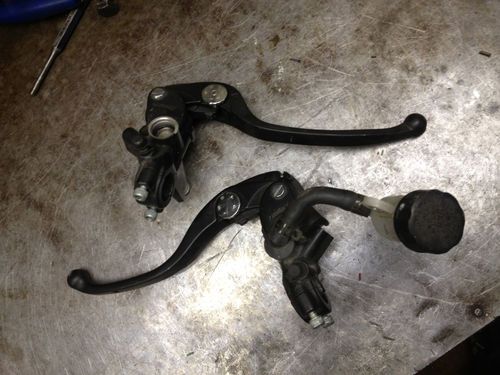

I did not want to use the typical ZX9 clutch & brake master cylinders (because I dont like the reservoirs ending up angled) so I got hold of a set of 06-11 ZX14 clutch & brake master cylinders for $60AU Including postage from the UK, The US is generally cheaper & they sell for around/average $100ea + postage over there so I got a bargain
The ZX14 brake master cylinder will be more suited to the 08 ZX10 calipers, Another bonus is that I can fit my billet reservoirs from the ZXR master cylinders, The clutch side has a billet reservoir fitted & has been connected & bled & works fine, Should work better then the stock ZXR clutch master cylinder, Feels like there is more leverage/lighter feeling & probably a more progressive feel to the clutch

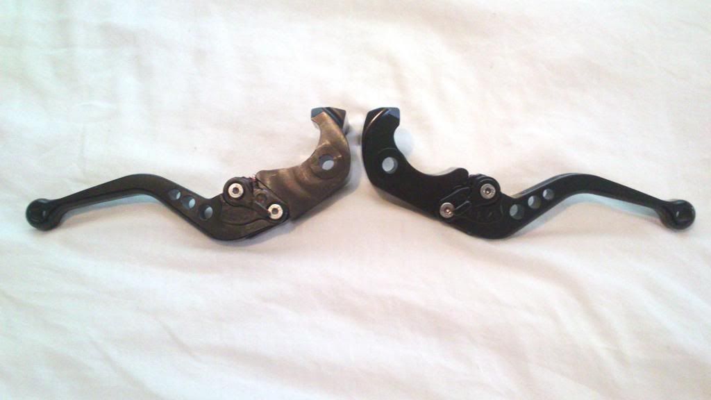

I just received a set of ZX14 shorty billet levers to fit also>

they are good masters mate i have a set for mine.
look into res's of the gtr1400 same master but nice intergrated res's if u want something else
