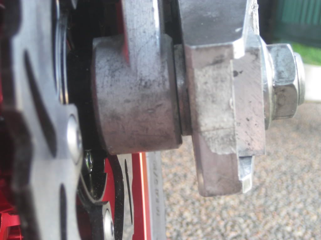

I want to use the Zx9R triples so I sanded of about 2mm from the inside of the lower yoke tube holders so the forks will fit.
For the top yoke I'll have to make some shims.
I removed a little from the subframe using a mini belt sander so now I can use the larger diameter K4 rear axel.

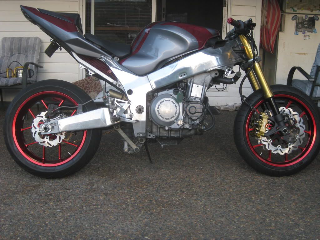

Nice wheels. When did they rock up?
fark me they look sweeeeeeet mate
Awesome rod
Thanks Guys.
Tim: He emailed me on the Friday to say the wheels were ready, they arrived the following Wedneday.
Pav: Yeah I had to relocate the Battery and remove the old battery box to fit the new shock.
Looks good Rod.

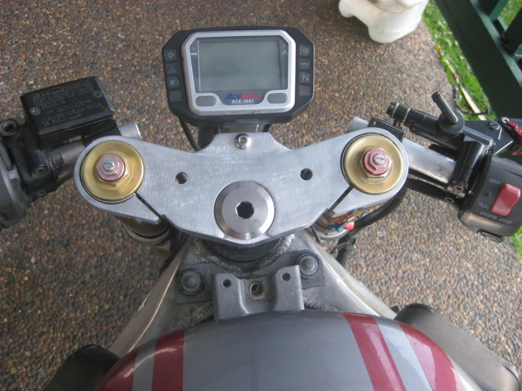

I need to make some shims for the top yoke to fit the fork stems.

I'm thinking 1mm thickness should do the job.

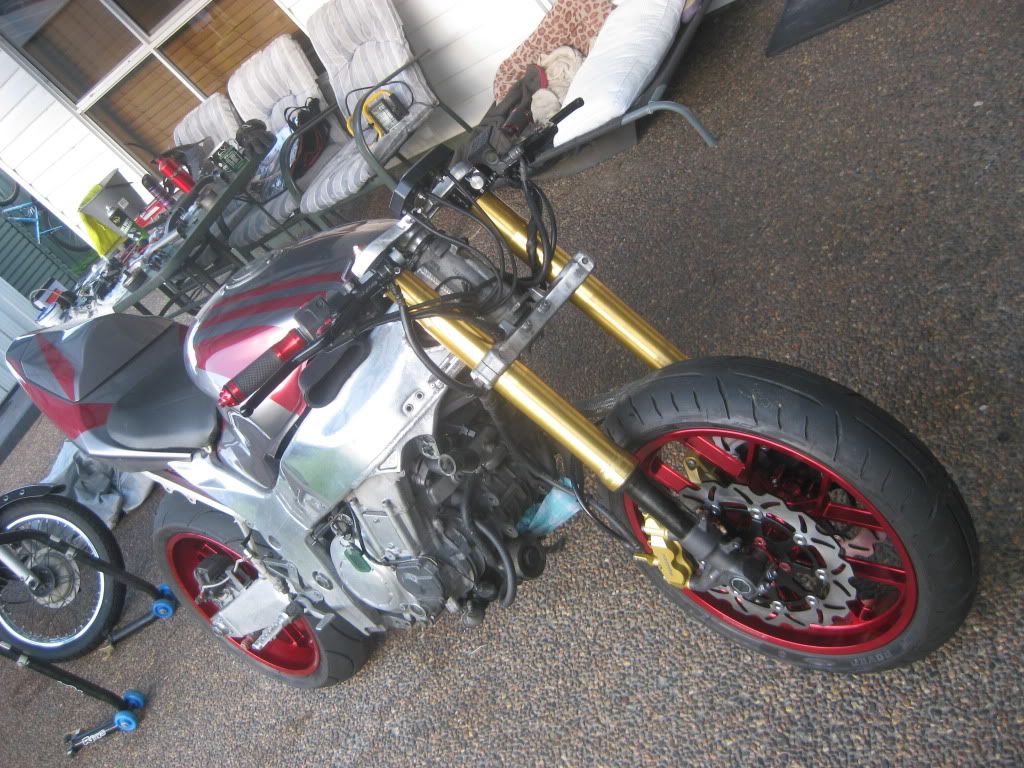

Those hoops are briljant.
I made some half shims for the top yoke. Too be honest I'm not to sure.

That looks awesome rod but I'm not sold on the shims idea I wouldn't ride it like that and I can be dodgy as fuck sometimes
Cheers Rod, yeah I made them from alloy and they seem to have bitten in ok..... but I know what you are saying

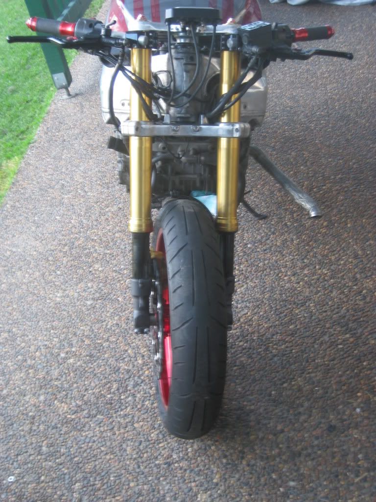

That looks wicked Rod, Just with the shims, there has been heaps of blokes swap out the front of there TL and shim the bottom yoke as they are 55mm, and people usually go with GSXR front ends which are 54mm or even 53mm with some really new ones, and they never have any dramas..
Looks great, paint and wheels looks sweet with it all together

Righto then how about using coke cans ....years ago I used to use them on my gokart to make the car by fit the barrel properly ...just cut into strips and fit at least that way you can go all the way roundQuote:

Looks real good Rod.
The wheels and forks really set it off.
Rod the bike looks great with the new forks and wheels mate, but yeah them shims arnt safe at all only being half. I wouldnt trust them.

After sleeping on it, I've decided to shave more off the shims in attempt to fit both sides in.

... would look awesome with a billet top.. would also solve the shim issue.

As Rod said mate, don't leave the shims as they are. Just get a thinner material to use and do it evenly all round
Ahh half shims.. I didnt read that bit.. yeah go wrap round Rod.. heaps better..
The way you've got them now would be trying to twist the forks I reckon.Quote:

definitely all-the-way-round shims
i've got half mm (i think) ally ones on the TL and have done thousands of k's riding like a pussie with those on
that said i dont think i would shim top and bottom yoke, but just one would be fine
