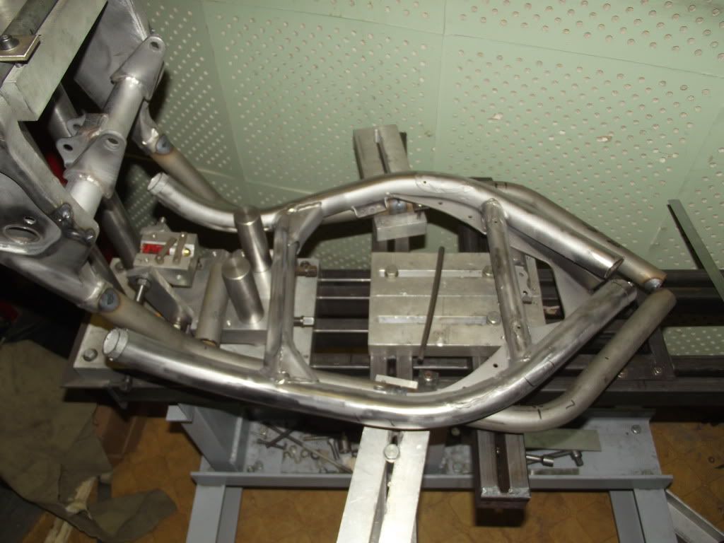

sooo yas liked the frame mates? coz i didn't! bwahahaha!

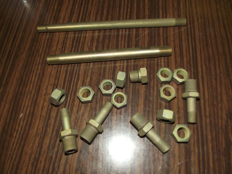

http://i1175.photobucket.com/albums/...r/DSCF4405.jpg

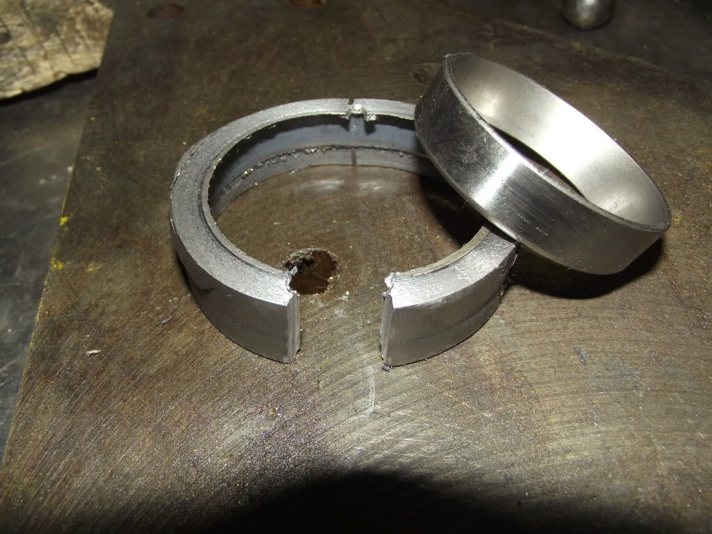

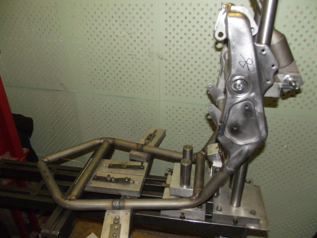

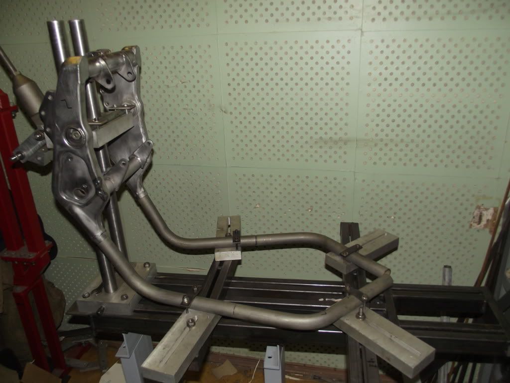

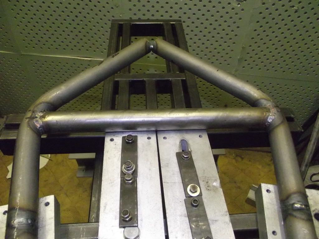

heres all the odds and bits i of cut of the frame so far, every little piece, theres nothing to cut of anymore haha

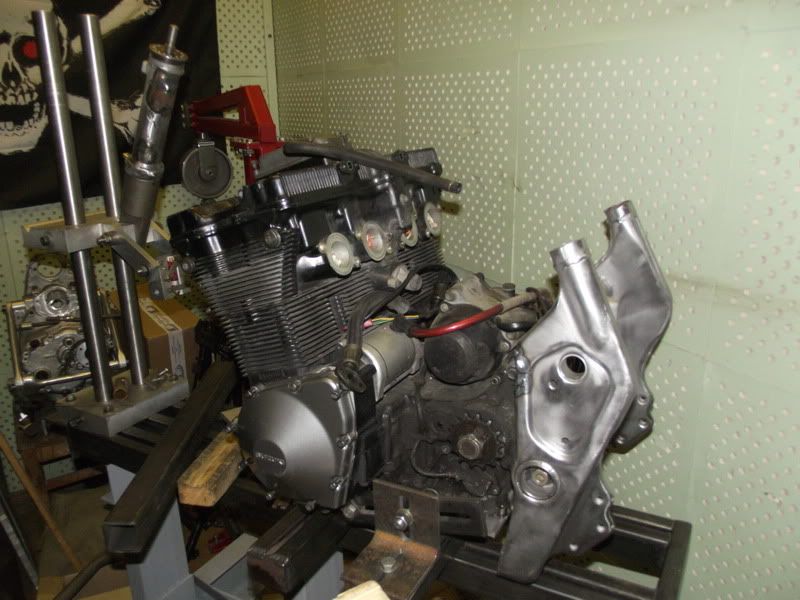

it would be alright with a standard carb setup but the side rails didnt let in tbp sensor and throttle cables pulley and brackets, which was noticed a tad to late
also theres to tight room in front for the ic and turbine set up
also the upper rails r too narrow and wouldnt let in busas turbo intake (and its rounded shape looks like an arse haha)

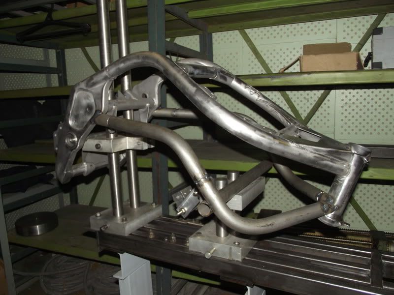

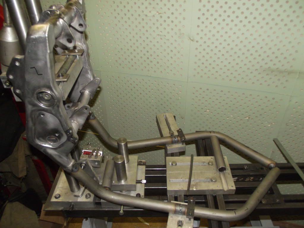

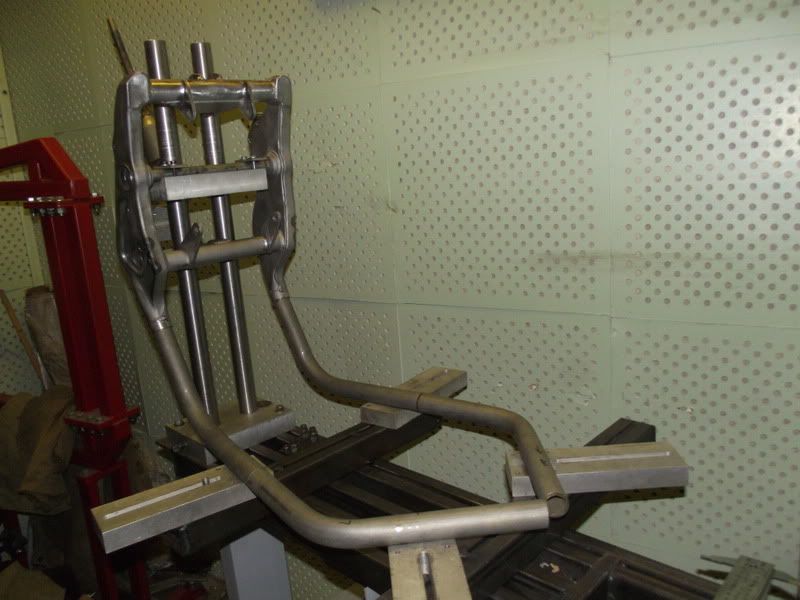

so ive finally took the resolution and cut the whole bloody frame apieces and started it anew

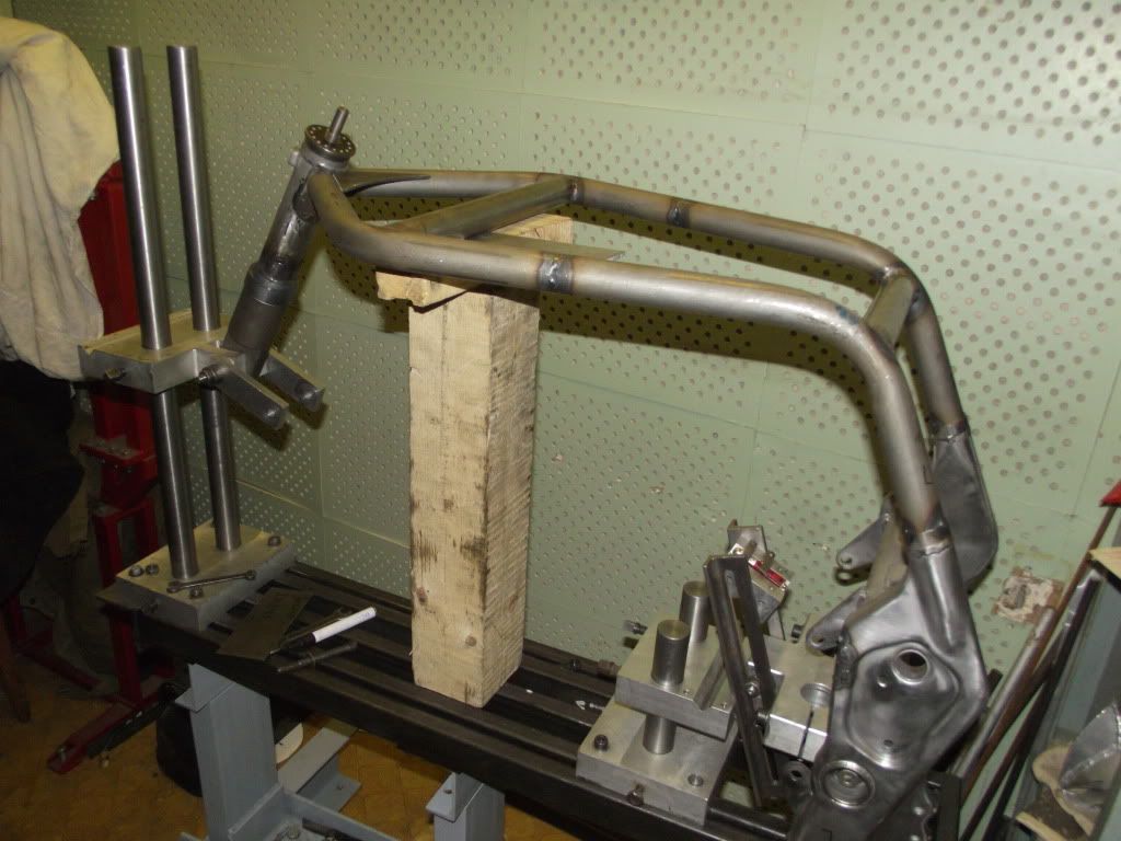

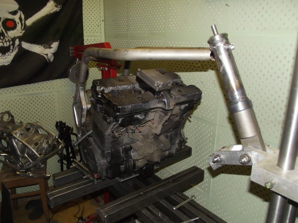

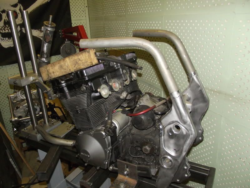

http://i1175.photobucket.com/albums/...r/DSCF4402.jpg
the invisible frame

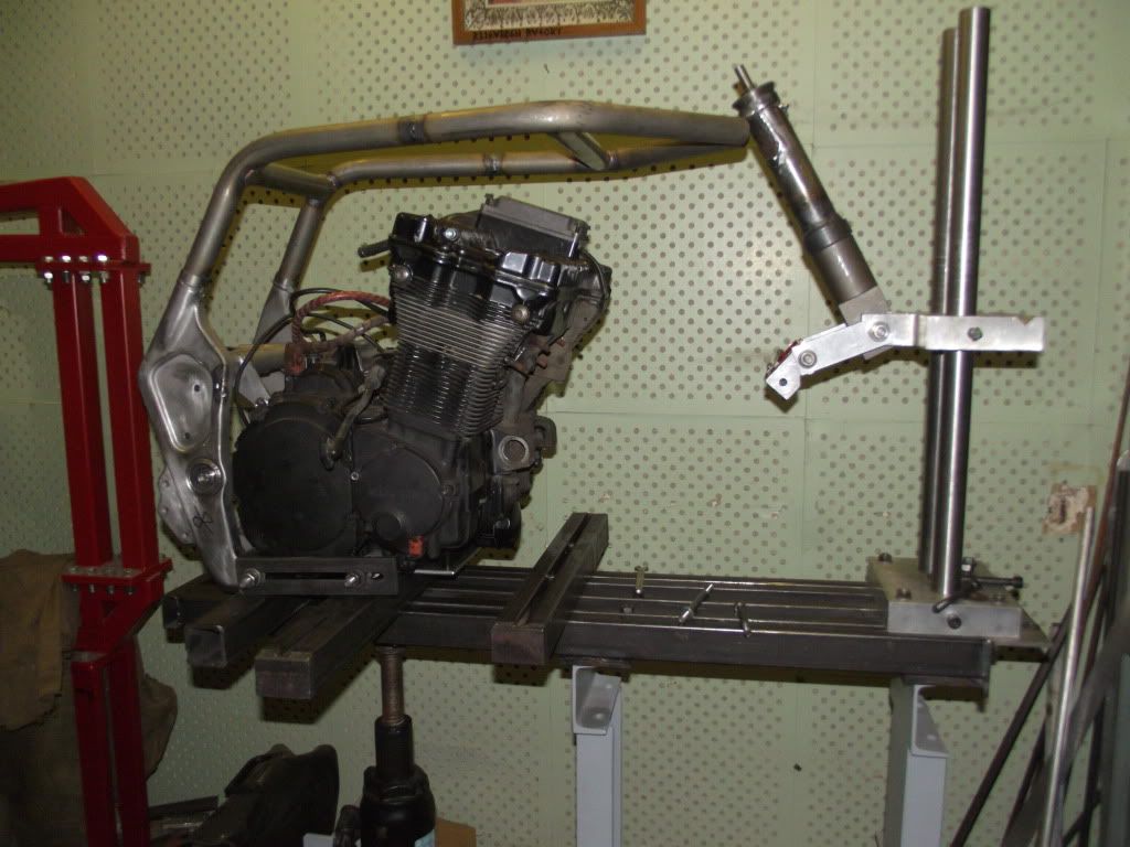

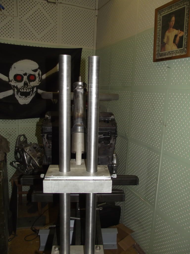

so i decided to stretch it by moving the engine 100mm backwards also the steering neck's to be lowered by 40mm and the rear part of the frame is to be raised for 40mm so the frames gunna look flat as a bench; the rake is to be set at 28 deg
