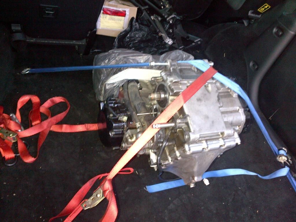

Also, just collected my engine from Geoff after the rebuild, you're a champ mate. Need to take it to work with me tomorrow so I can de-grease and paint strip, then rub back and prepare for paint.

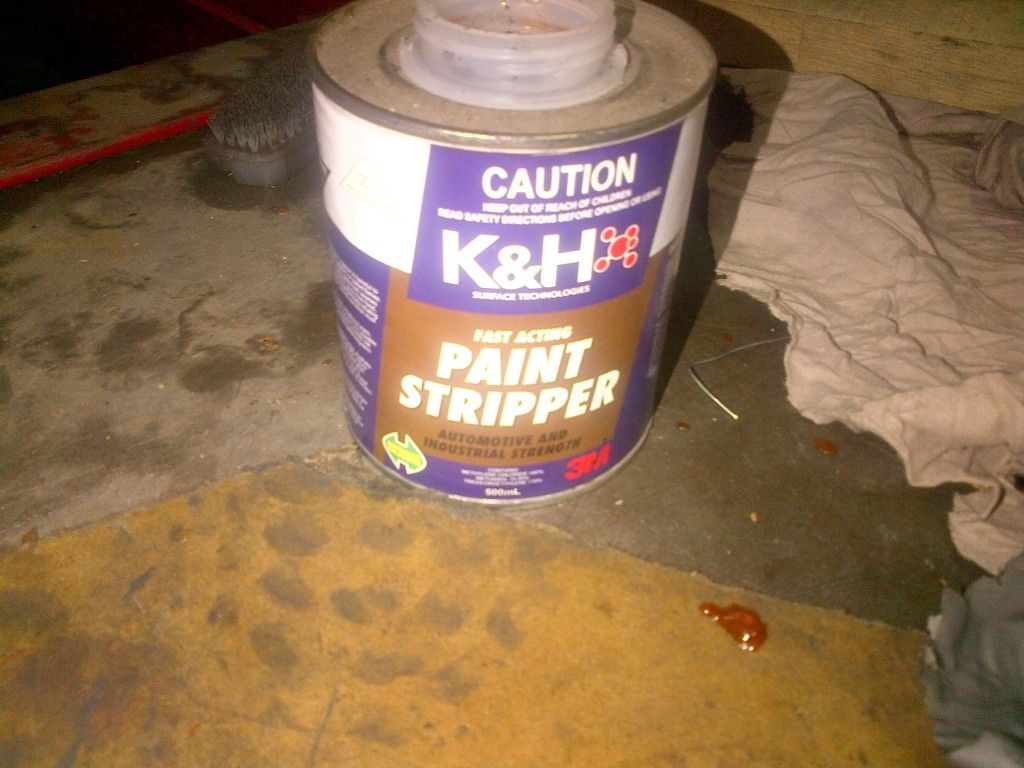

Then got ye old faithful Paint Stripper
http://i770.photobucket.com/albums/x...ps4cd2e27d.jpg

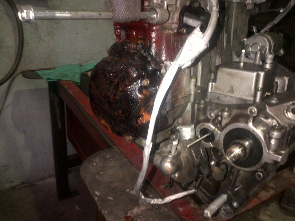

and started applying liberally. As you can see some of the engine had some crappy red paint on it as well
http://i770.photobucket.com/albums/x...ps3b9efb37.jpg
http://i770.photobucket.com/albums/x...psce1d8e39.jpg
then let the paint stripper do it's thing and gave it a clean in the parts washer. Ended up giving it two coats of paint stripper and two good cleans to de-grease and remove all the paint stripper.

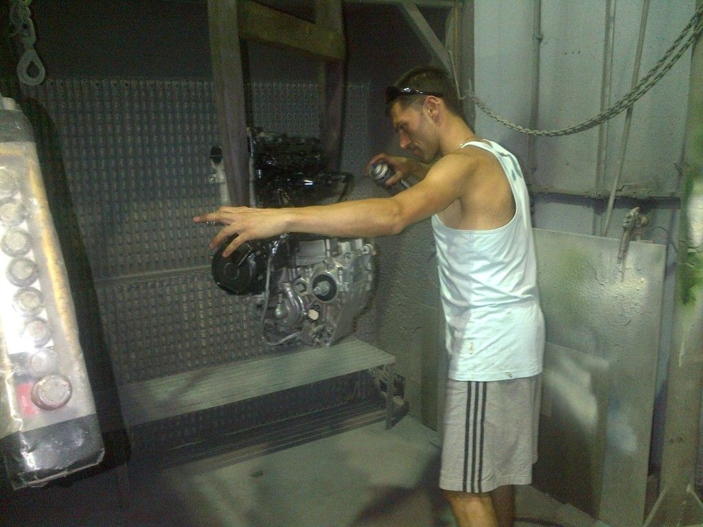

We the rubbed back lightly with some emry paper and started laying on some black goodness

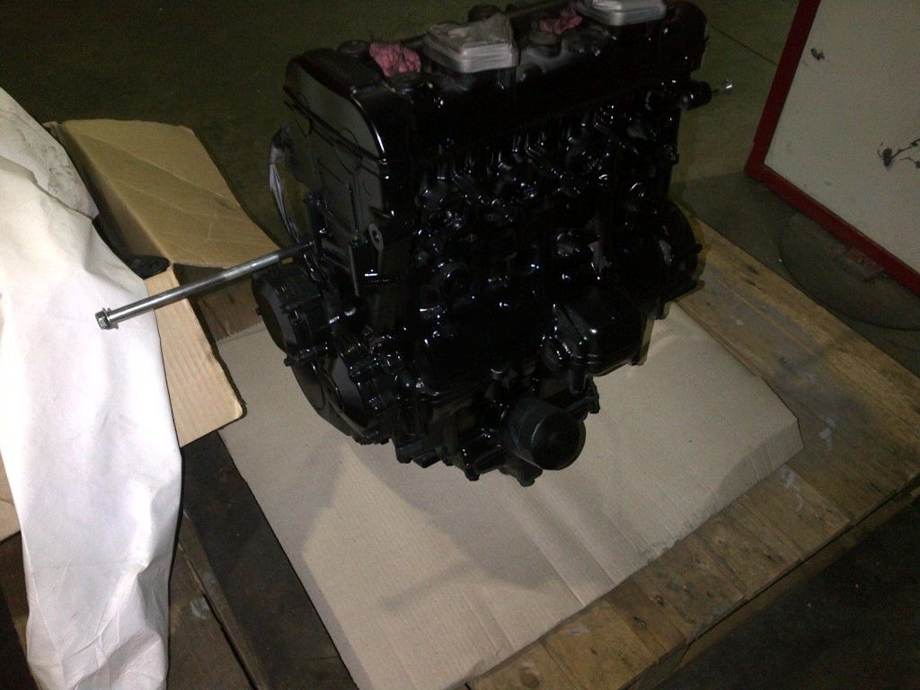

Getting there. I actually ran out of paint and need to get some more as it needs another coat of paint, but it's looking good :D
http://i770.photobucket.com/albums/x...ps2bacf100.jpg
turning out good mate.
