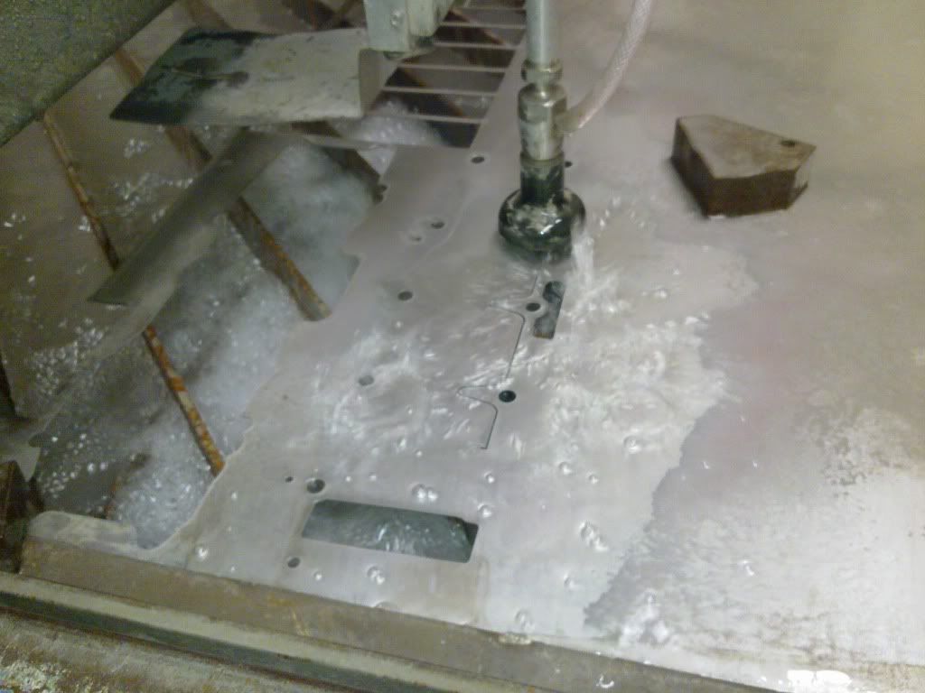

We have some action. Picked upthe base spacer today
http://i1234.photobucket.com/albums/...3082011593.jpg
We took the rubber boot off to have a look at it..... nice
http://i1234.photobucket.com/albums/...3082011594.jpg
Some shots of it being cut but in my rush to get it back together forgot to take a pick of the finish item.

cool. i'd like one of those water cutters in the garage.
