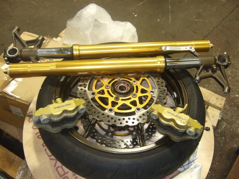

thats the new seat unit sat in place, the entire front end is for the off
and i'll be making new fillers

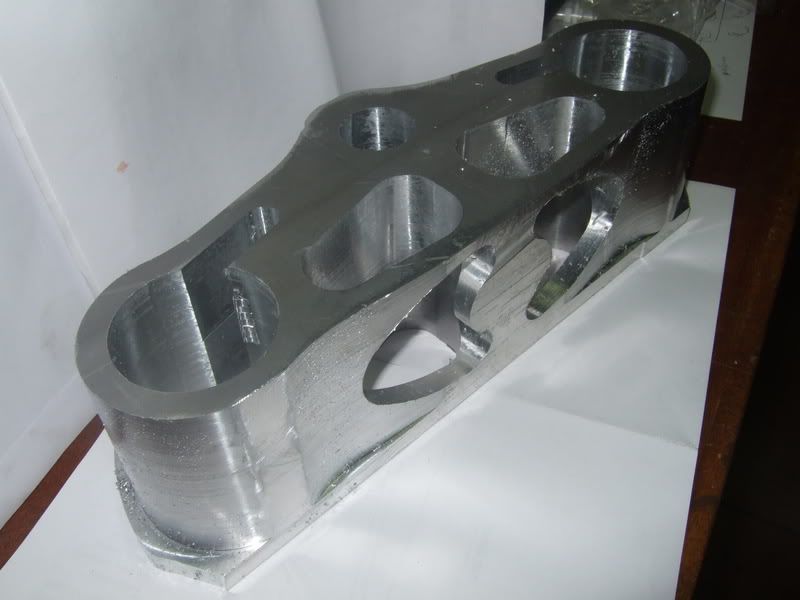

http://i52.photobucket.com/albums/g2...f/DSCF2475.jpg

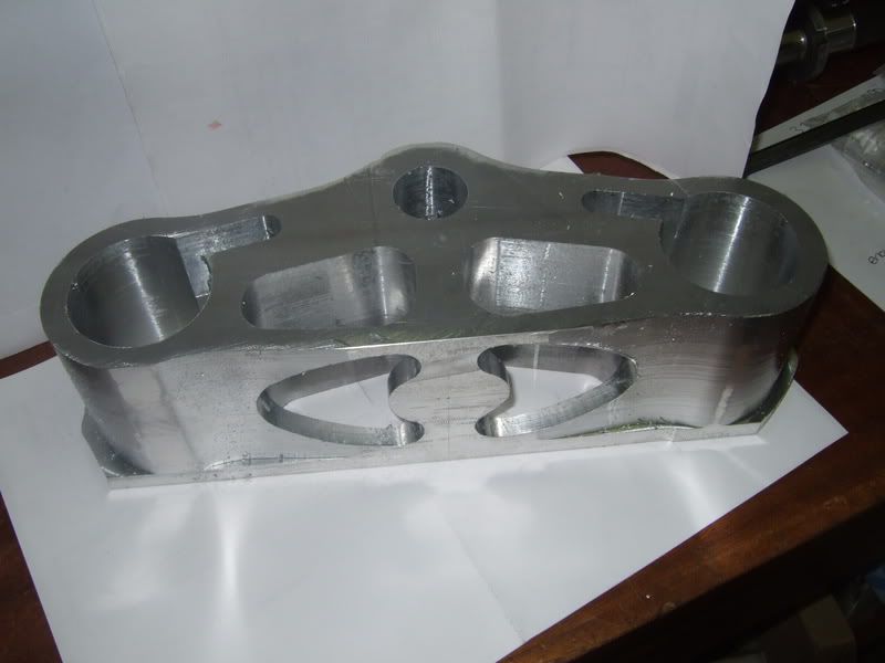

http://i52.photobucket.com/albums/g2...f/DSCF2474.jpg
don't reckon these paper ones will do the job :D
that is friggin tidy, very nice, impulse buying you gotta love.

i'd gladly buy those forks + brakes off ya!

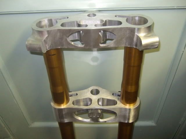

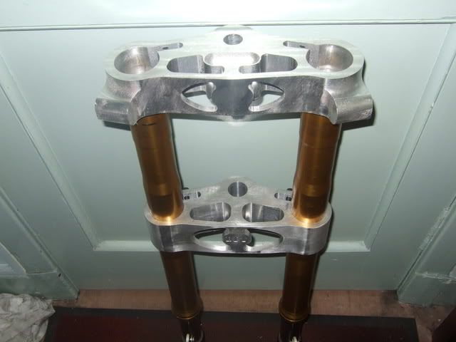

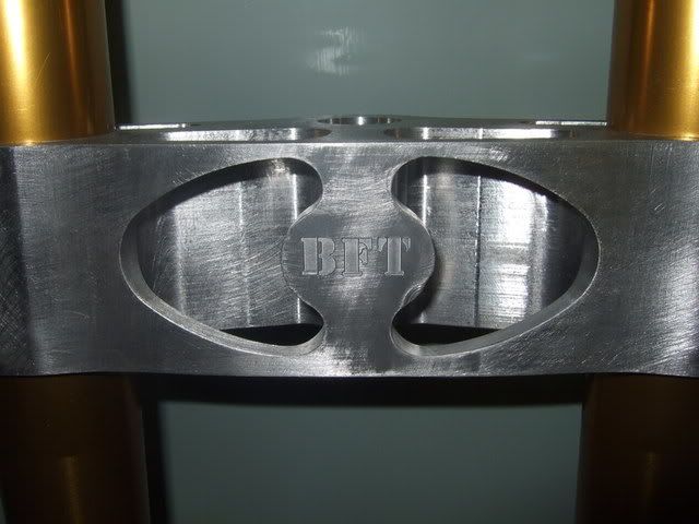

btw, how does that big chunk of ally clamp the forks exactly??
just curious
there will be 4 M8 cap screws on either side through the slot that comes off the hole , the hole is about 0.004" clear , tighten the screws and it clamps around the fork leg

Those clamps look [:p][:p][:p], in fact the whole bike looks
[:p], how much do you charge to make up a set like that?
