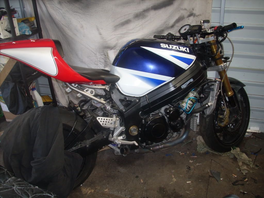

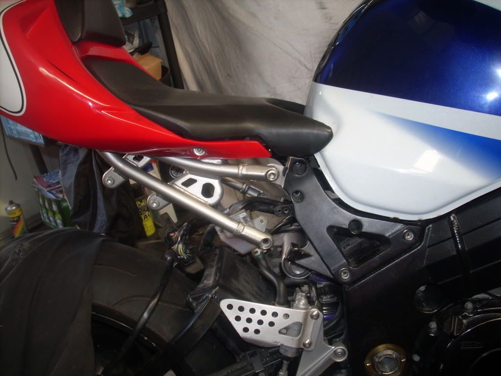

here mine with the top mounts fitted,shaped the ones that were already there and drilled and taped for bigger holes.
http://i1128.photobucket.com/albums/...mc/gsxr001.jpg
http://i1128.photobucket.com/albums/...mc/gsxr002.jpg
will be fitting the bottom lugs during the week.

I'm thinking of widening the top mount and using that one directly as the MV subframe is narrower than the Gixxer one. I'll just machine up a set of spacers and line it up.
Well, it was good to get back in the shed again. Had to do some work on my R1, so got the tank re-clear coated as I wasn't happy with the finish of it. I've also removed the subframe off the Gixxer and I am lining it up with the MV sub-frame. Gonna draw up some alloy spacers to be able to line up the top mount and then cut and gring to fit as well as order some stepped bolts to bolt up the top mount.
Once that is done I will cut off the bottom mount and machine up a spigot to slot into the round tube of the MV sub-frame and bend up some new tubing to join it to the Gixxer sub-frame.
I'll upload some pics soon to explain what I mean
Been a bit slack lately. Finally got the welder to weld on the spacer plate that I made for the upper mount of the subframe. Then drilled the hole out to an M8 and lined up the top mount. I'm gonna have to cut down the tie rod ends as they are gonna have to be shorter than I thought, but that's an easy one.
