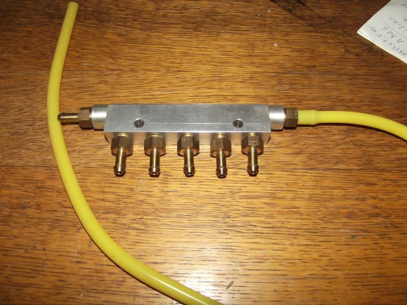

btw heres an air pressure distributing block, its 3mm ID, is it too large?
http://i112.photobucket.com/albums/n...psy9efleye.jpg

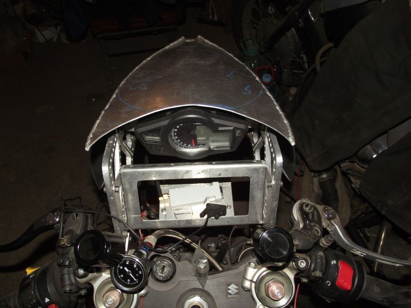

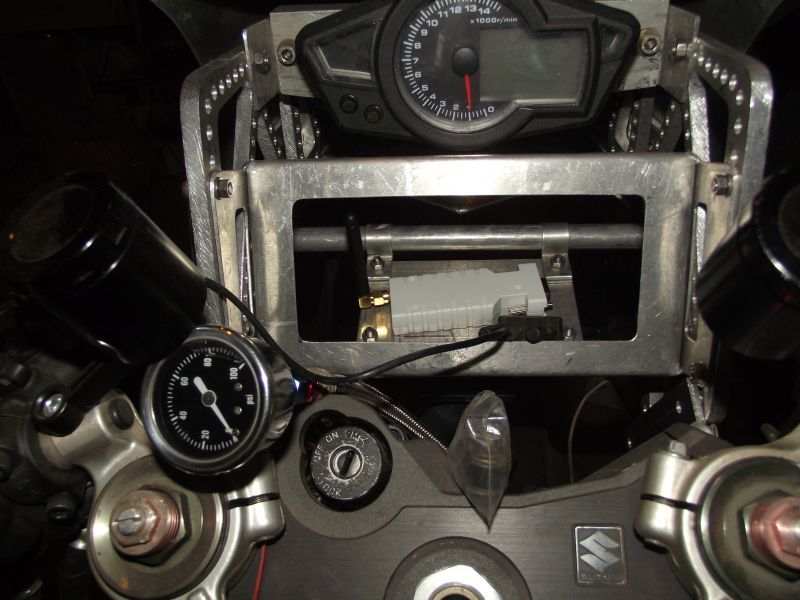

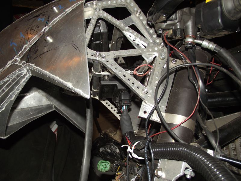

fabbing speedo and ecu mounts
http://i112.photobucket.com/albums/n...psb1wbhlca.jpg
http://i112.photobucket.com/albums/n...psohqqujak.jpg
http://i112.photobucket.com/albums/n...psrnhvmmzq.jpg
http://i112.photobucket.com/albums/n...pskh6s8c1g.jpg
wtf? not always good to have 2 females!
http://i112.photobucket.com/albums/n...psabdn13dz.jpg

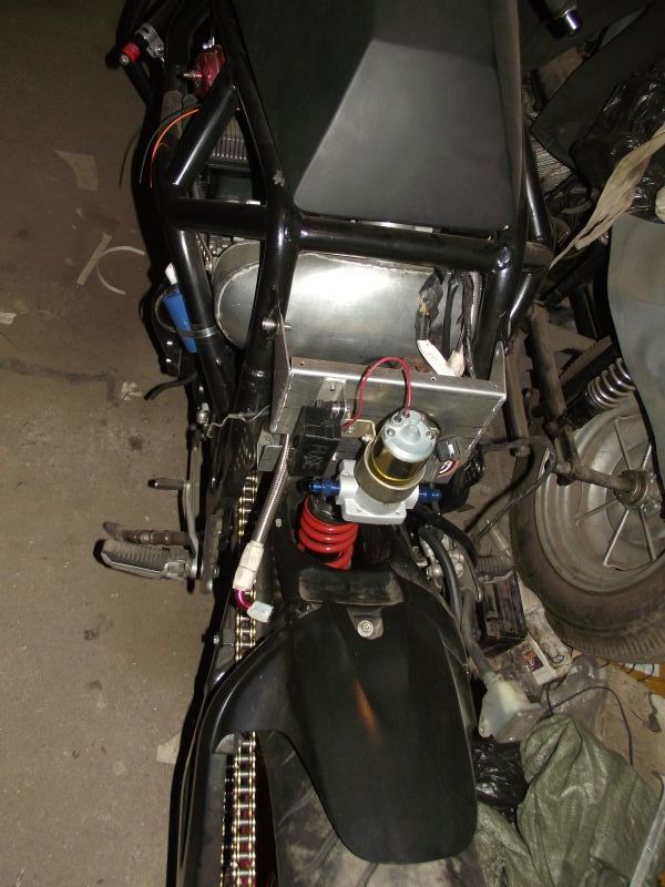

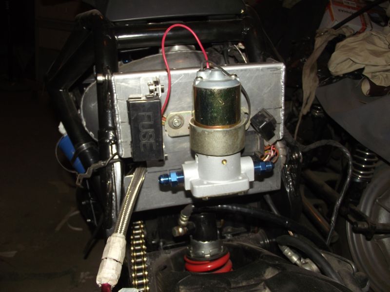

a new place for the fuel pump, fuses and relays
http://i112.photobucket.com/albums/n...ps90twh2b7.jpg
http://i112.photobucket.com/albums/n...psehkp5whs.jpg

That vacuum block looks great. Should be ok. Still put a fuel filter in the line to the map sensor as well though.
I had the same problem with the 2 male serial port fittings between the blue tooth dongle and lead. I bought a double ended female (ooh er missus) adapter to join them together.
