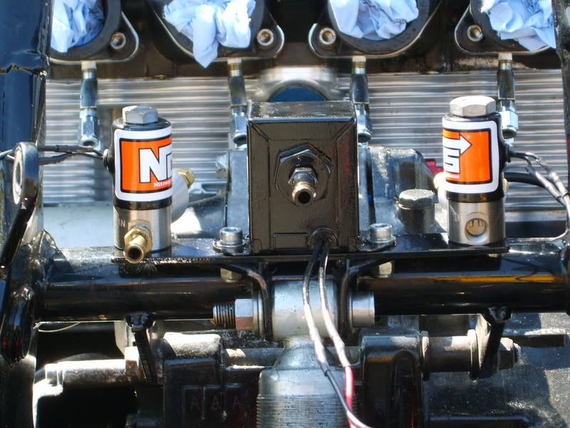

Sorted the final mounting plate for the pump and solonoids;)
http://i3.photobucket.com/albums/y61...tch/noz001.jpg

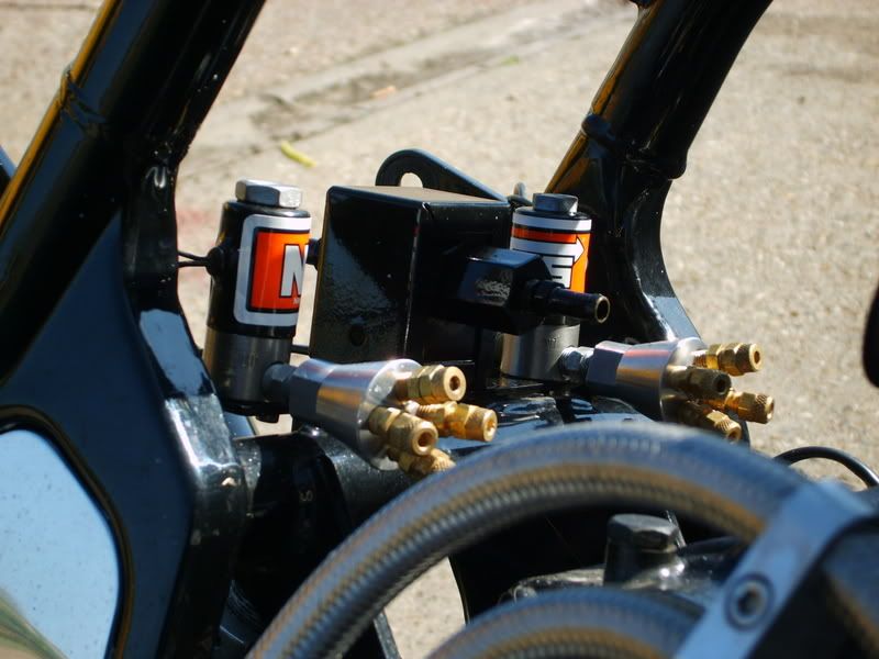

Side shot with the shower heads fitted, the high pressure lines are going on in the morning
http://i3.photobucket.com/albums/y61...tch/noz002.jpg

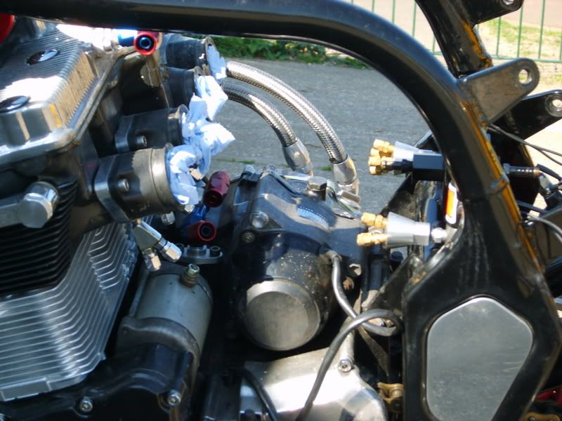

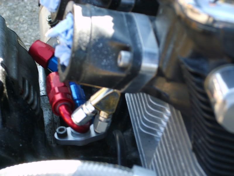

The rear cam feed T piece fitted with 180 and 45 take offs,to run the cam feeds out to the left side of the carbs either side of the foggers
http://i3.photobucket.com/albums/y61...tch/noz003.jpg
very cool! what are the carb spacers for exile? are you using them for torque, or just to get the right carb boots fitted?
Cheerz dude:)The spacers are nitrous fogger adaptor plates to save drilling the head;)

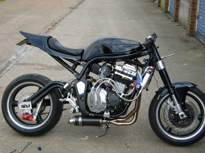

its looking hard mate!
so how much power we talking about with the noz?

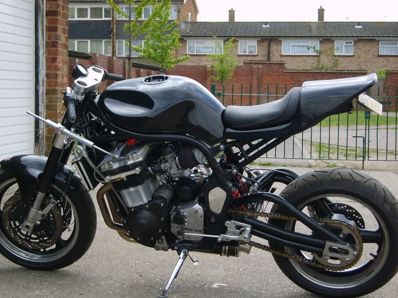

must say i like the way it looks now with the acerbis modded for the gauges and the massive amounts of blackness
