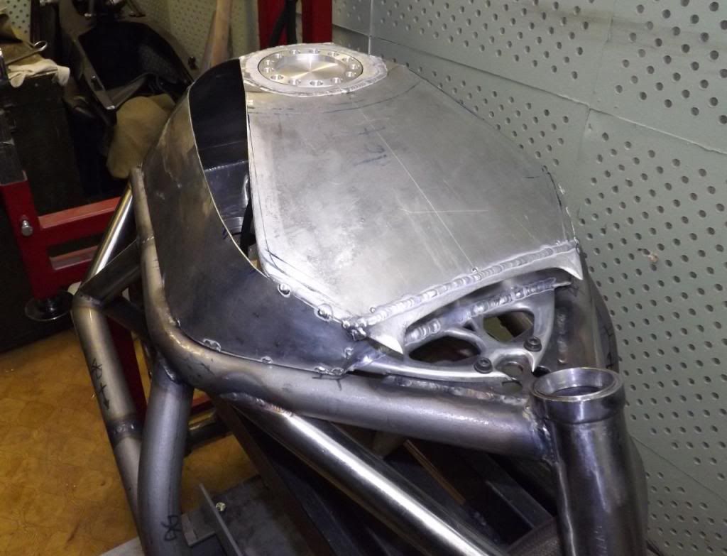

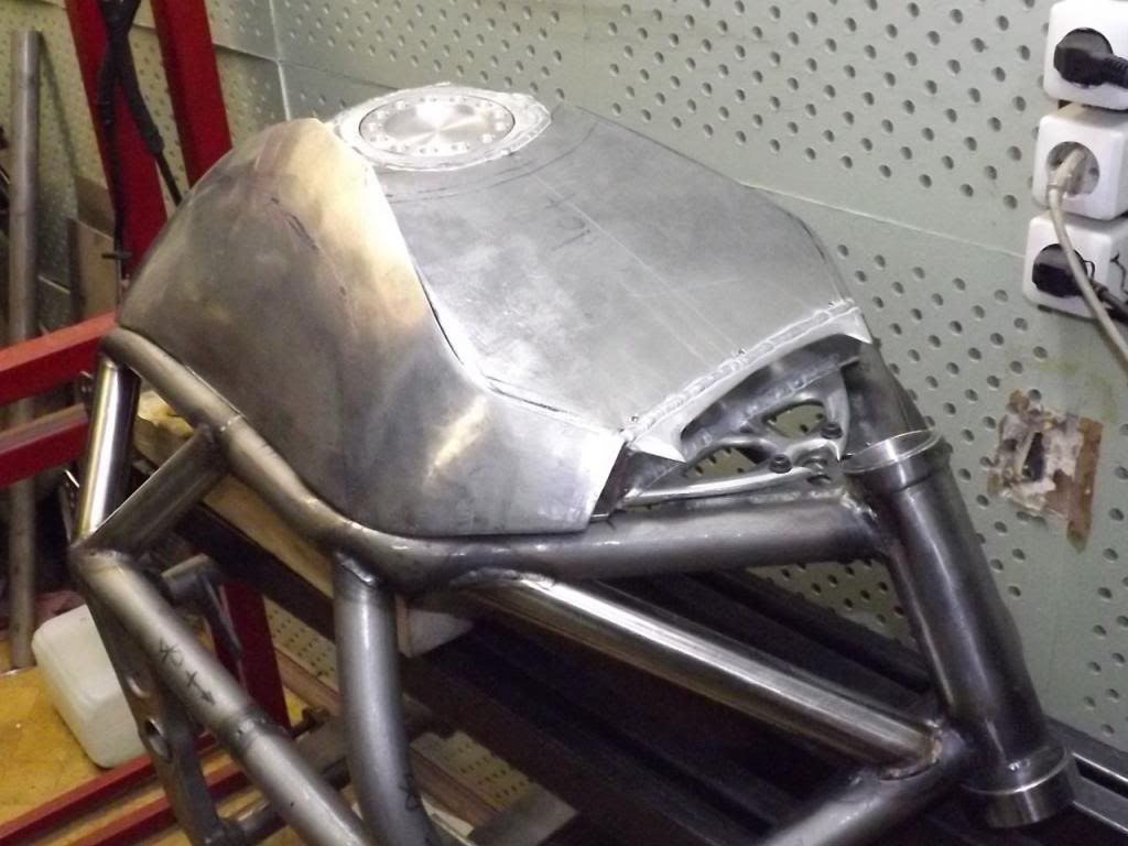

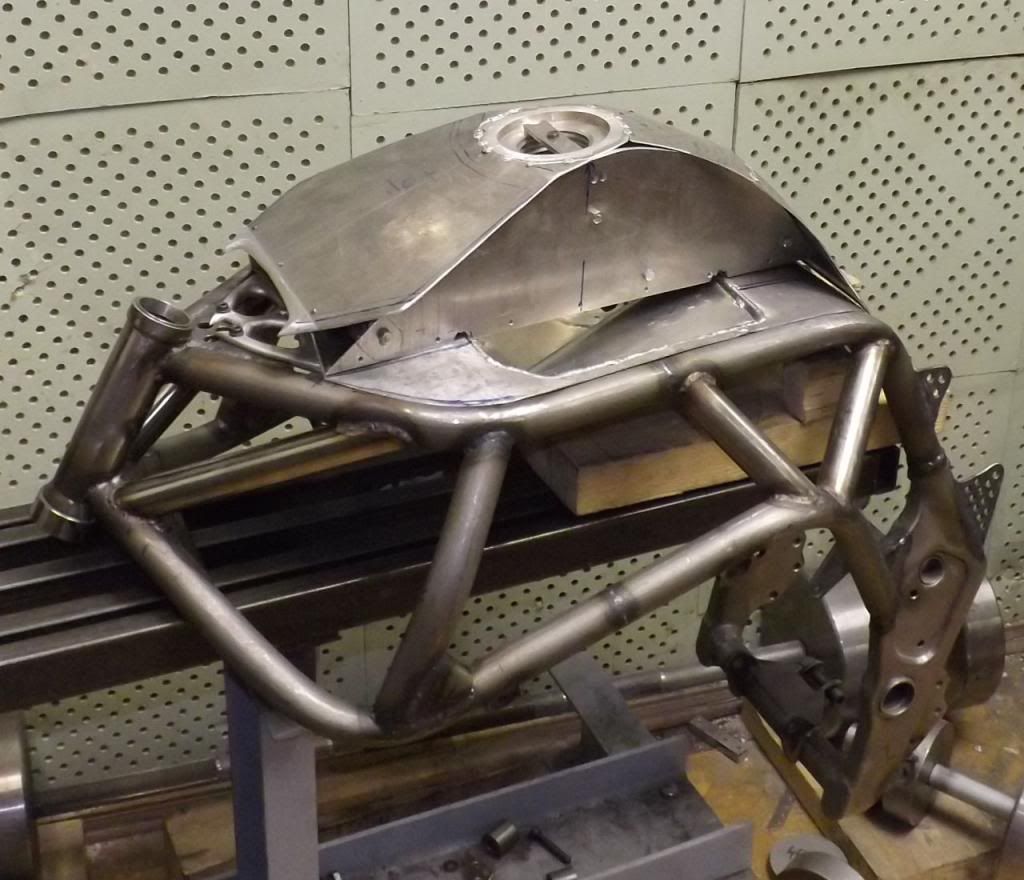

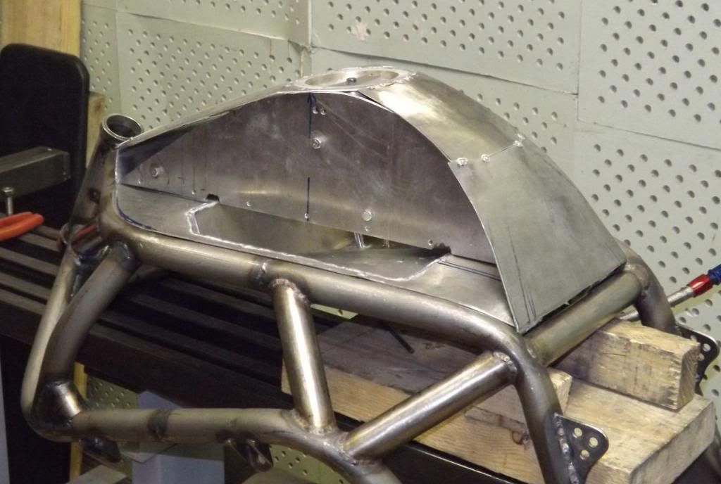

so... due to the may holidays it took a while to carry on
however its happened

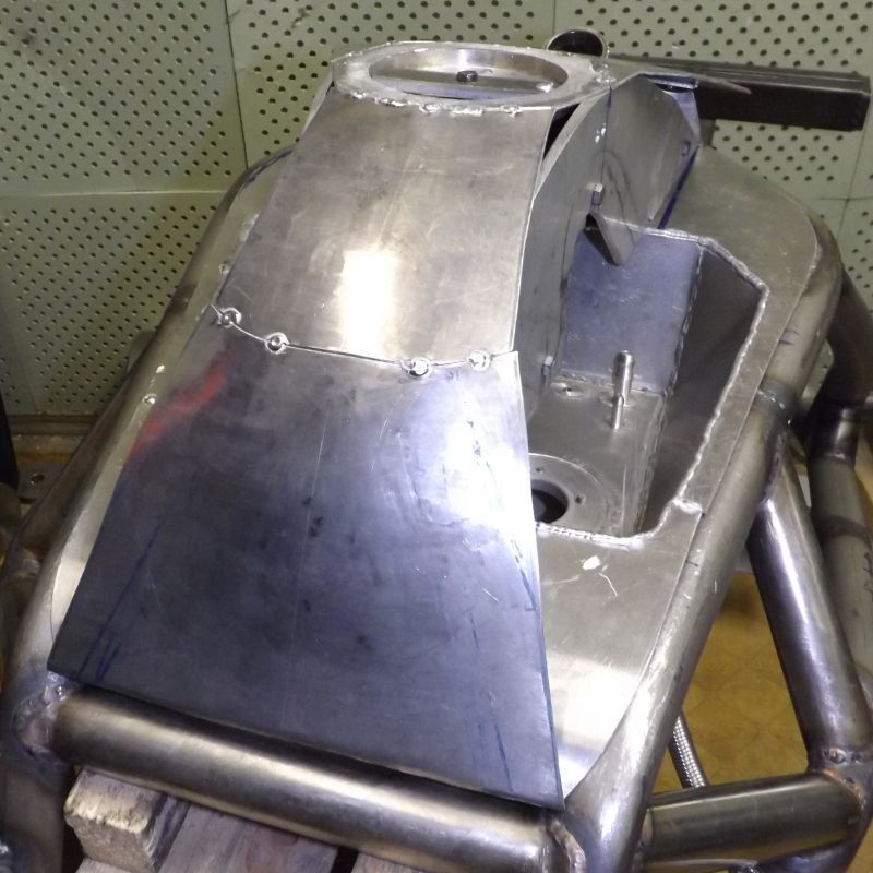

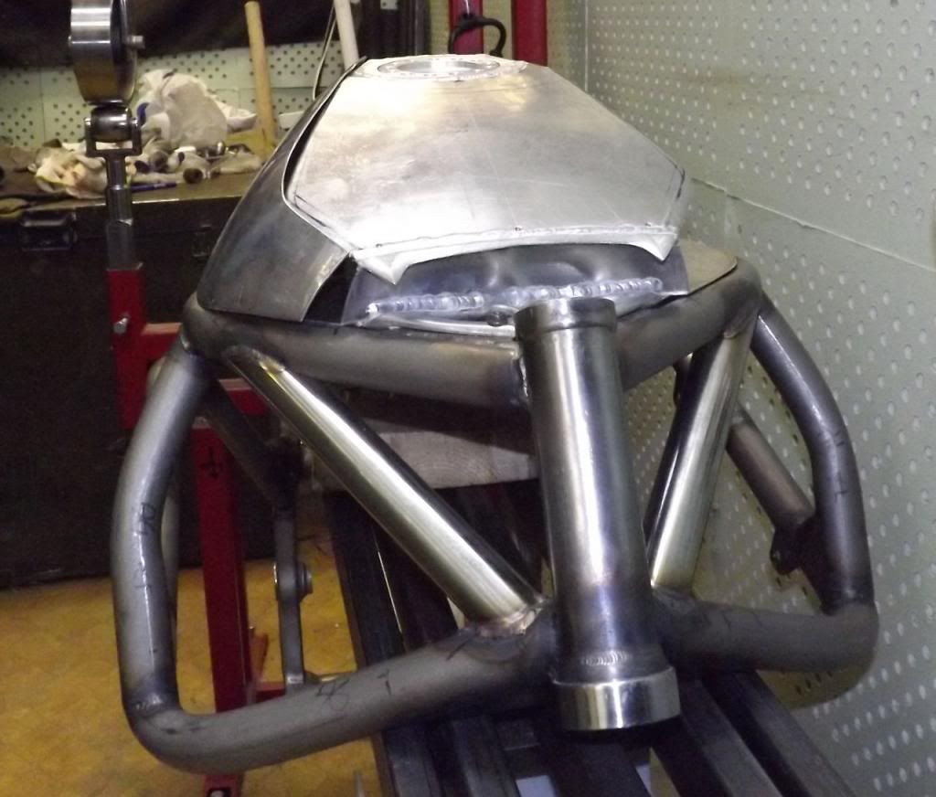

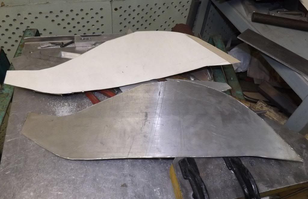

had to cut in halves the side panel coz of their multiple curves and the voices in my head told me to do so lol
http://i1175.photobucket.com/albums/...r/DSCF5164.jpg
http://i1175.photobucket.com/albums/...r/DSCF5165.jpg
http://i1175.photobucket.com/albums/...r/DSCF5166.jpg
http://i1175.photobucket.com/albums/...r/DSCF5167.jpg
actually i pretty pleased with the result, the both sides are symmetric

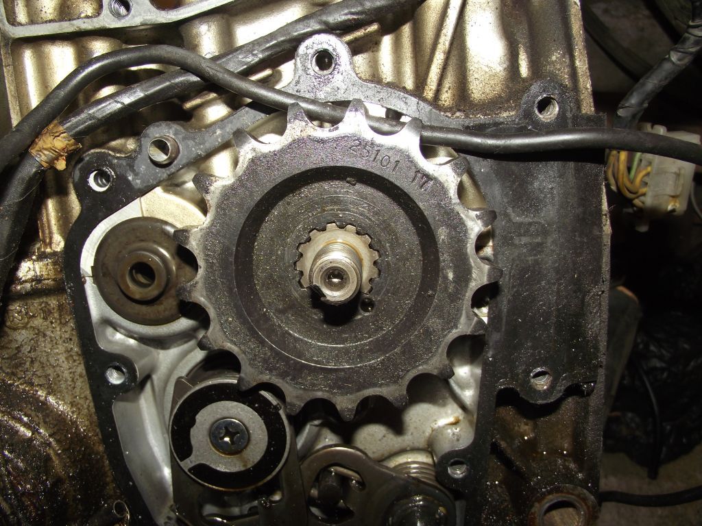

actually firstly i intended to convert it to a chain drive and researched that it could be easily done, here, the shafty motor with the sprocket installed
http://i1175.photobucket.com/albums/...r/DSCF0128.jpg
and see the difference

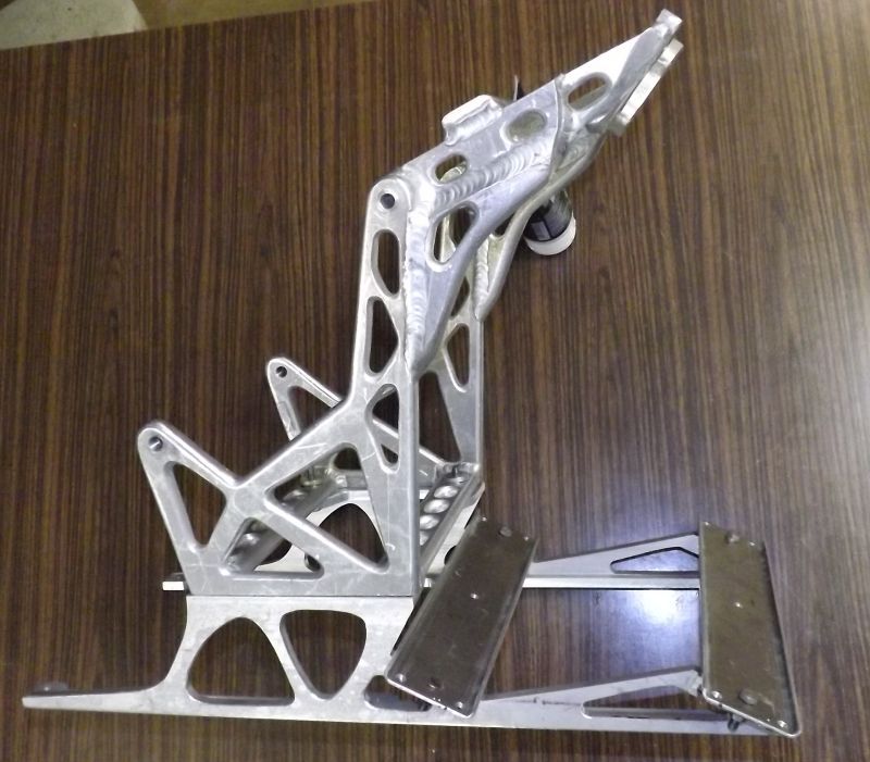

also the rear wheel will be borrowed from the b400 above and a custom ally swinger will be made... not really a quickie but i can't help it bahaha!

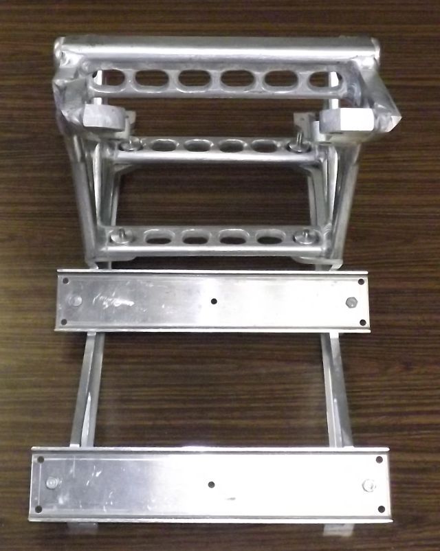

when i was a kid, i read in a book that one bloke had build a bike from a Singer's old german sewing machine and a few bike parts. the deed stuck in my head for years and i decided to prove that that wasn't a fable. but i had to build a sewing machine first
http://i1175.photobucket.com/albums/...r/DSCF1153.jpg
http://i1175.photobucket.com/albums/...r/DSCF1154.jpg
http://i1175.photobucket.com/albums/...r/DSCF1155.jpg
http://i1175.photobucket.com/albums/...r/DSCF1156.jpg

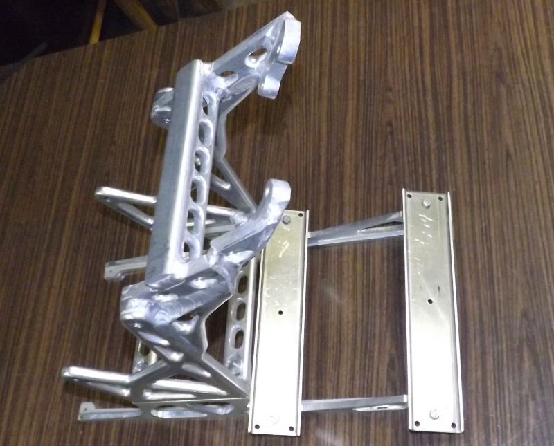

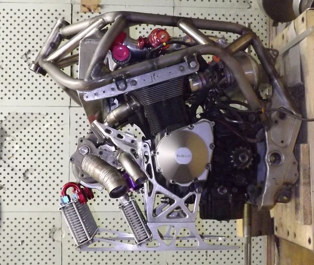

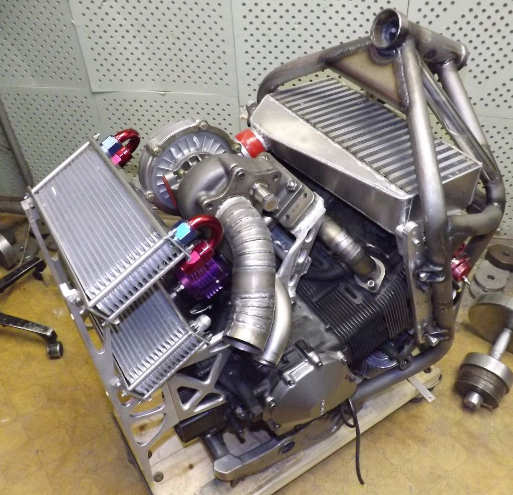

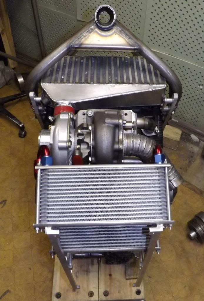

siberian sleigh with oil heating
http://i1175.photobucket.com/albums/...r/DSCF1157.jpg
http://i1175.photobucket.com/albums/...r/DSCF1159.jpg

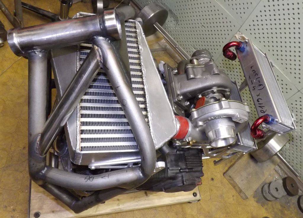

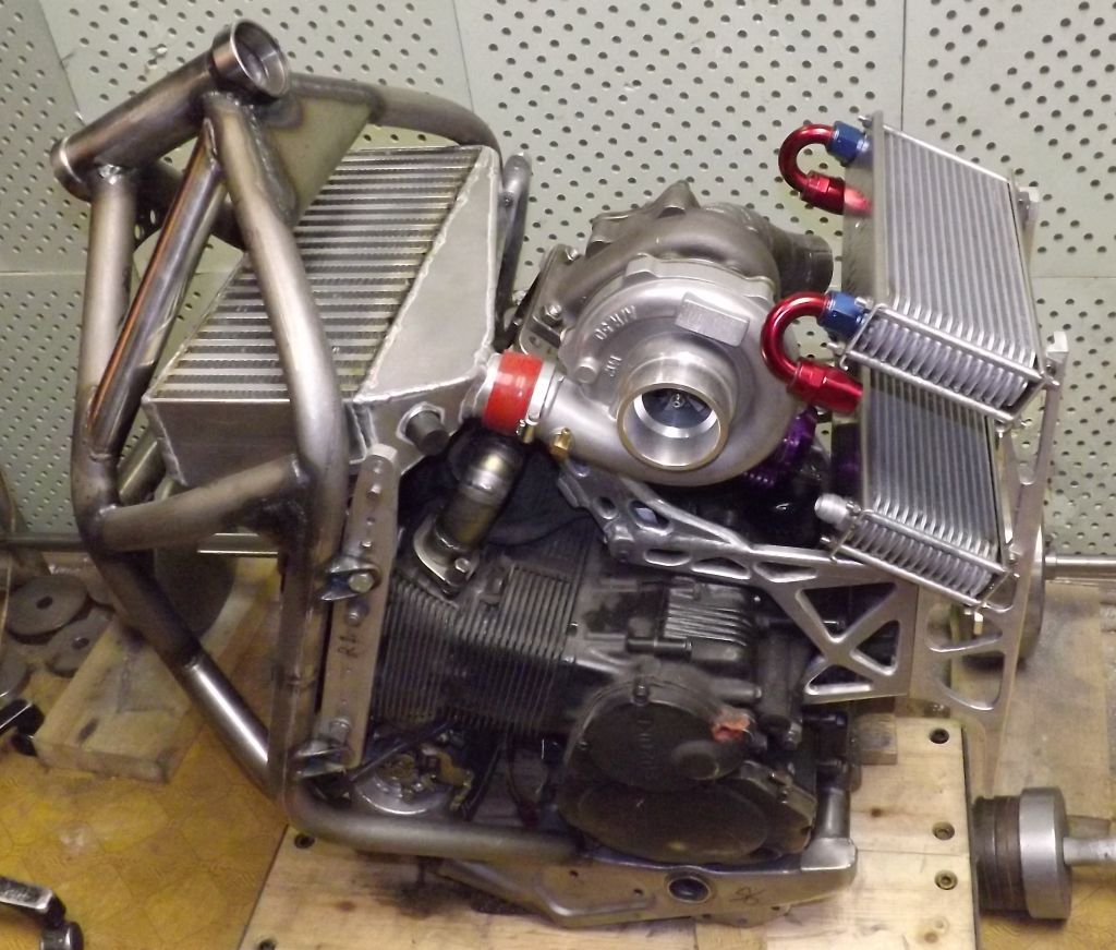

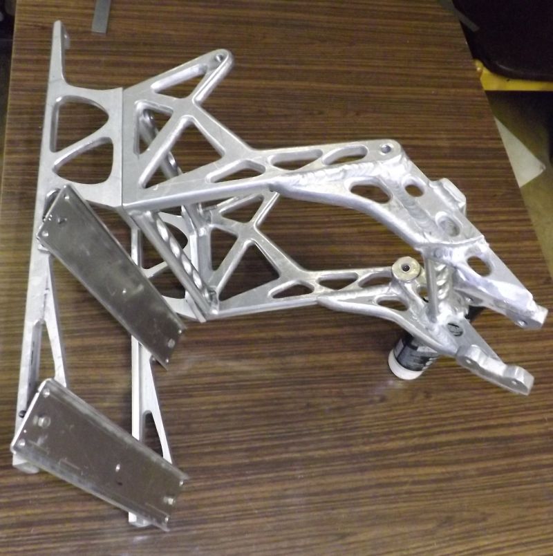

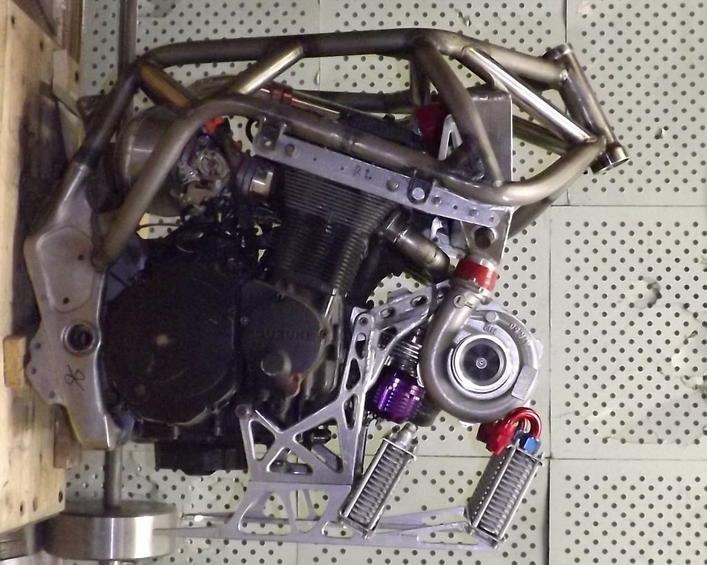

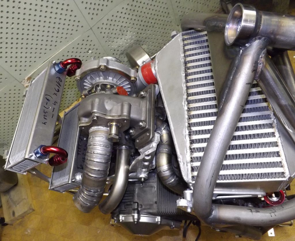

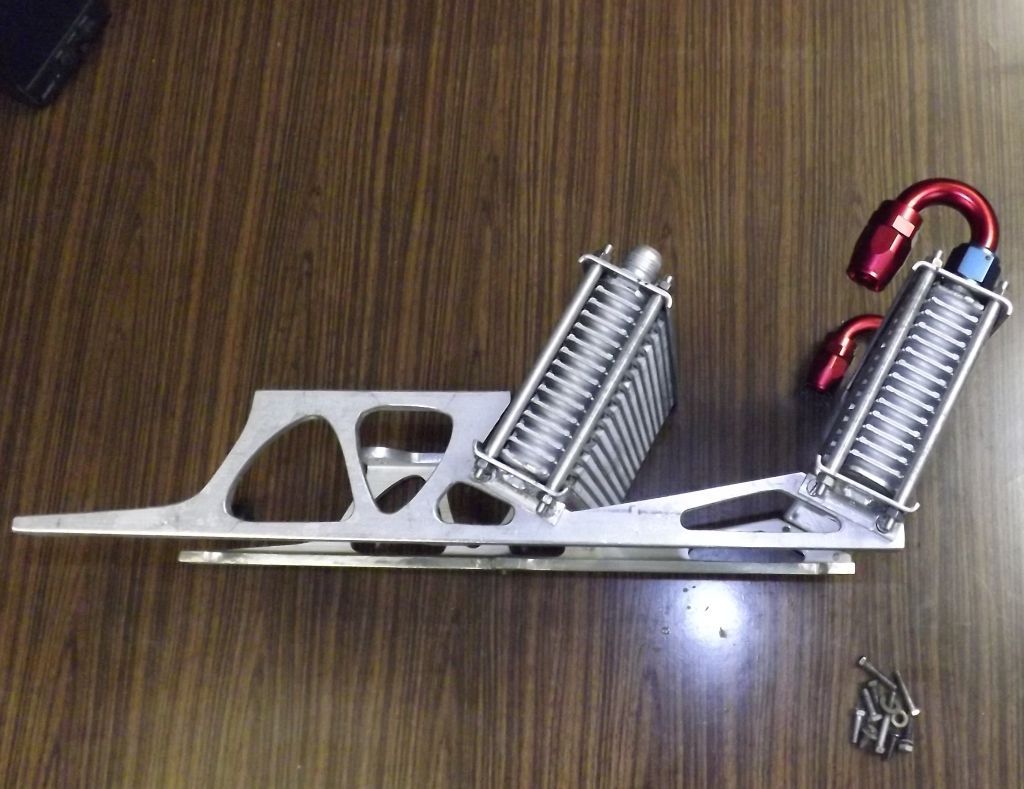

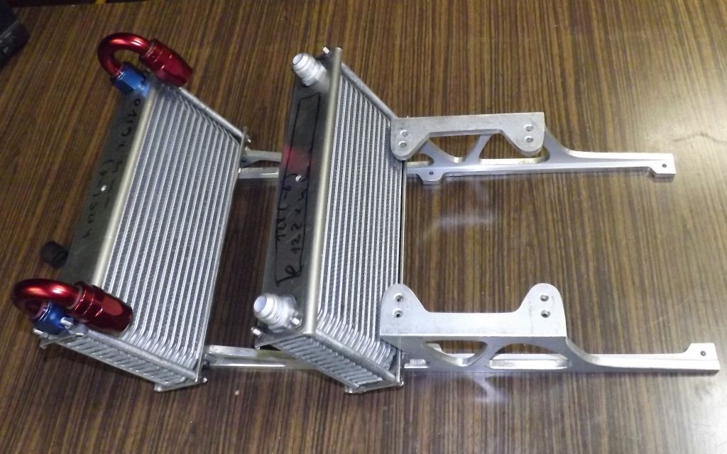

took 6 months to find the best place for oil coolers and just a coupla weeks to fab their mounts/holder
now they are gonna be always full being below the oil level, i can make a separate duct to each cooler and even to add fans if needed
