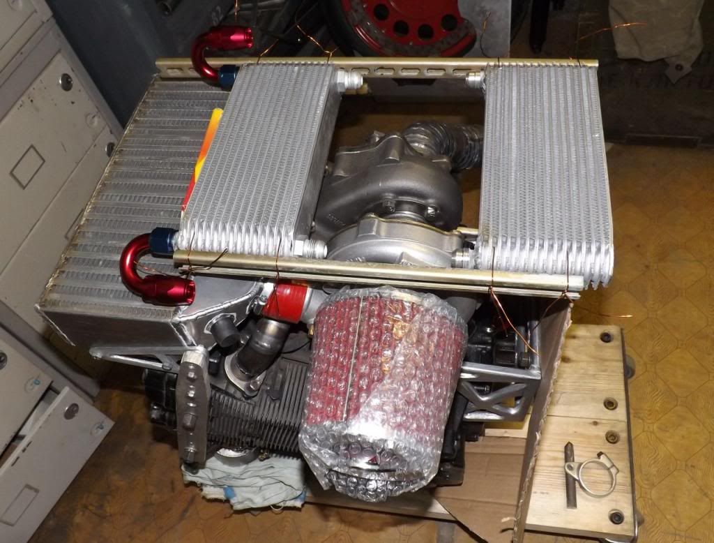

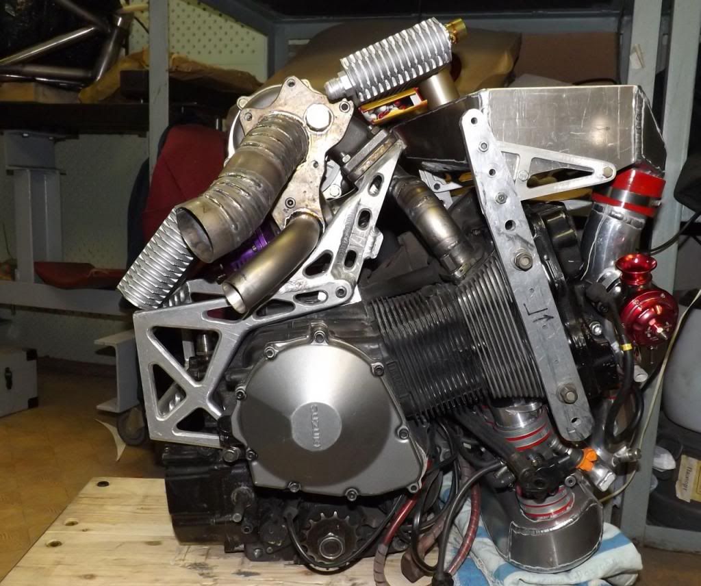

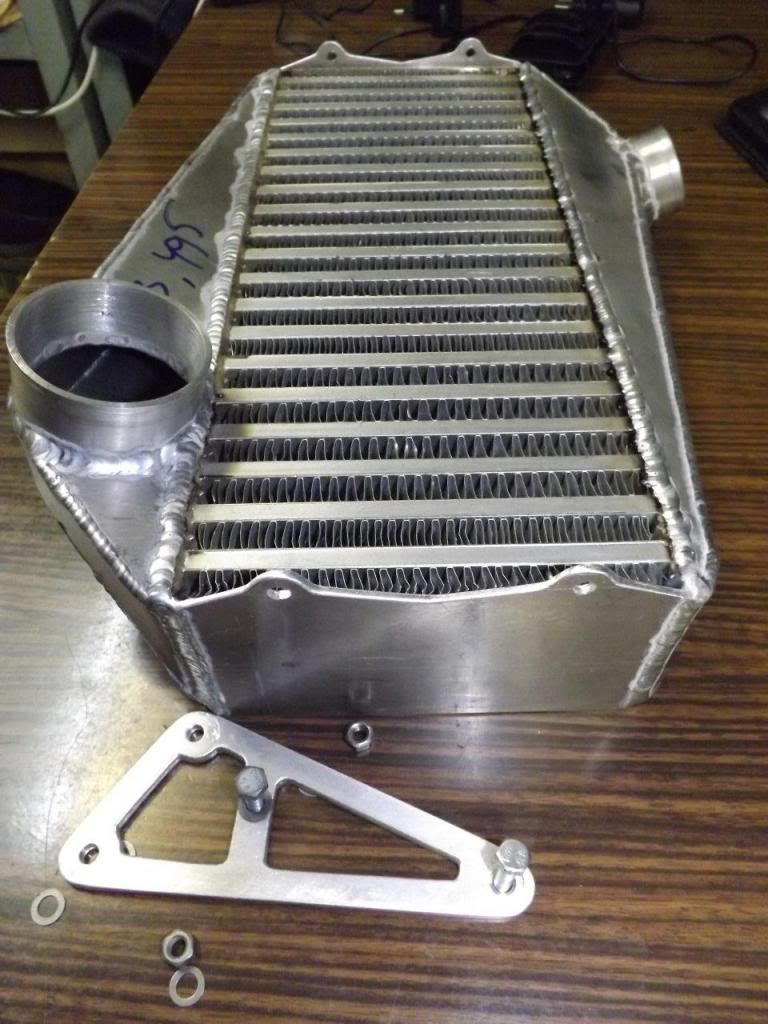

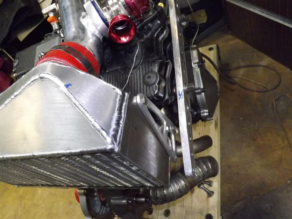

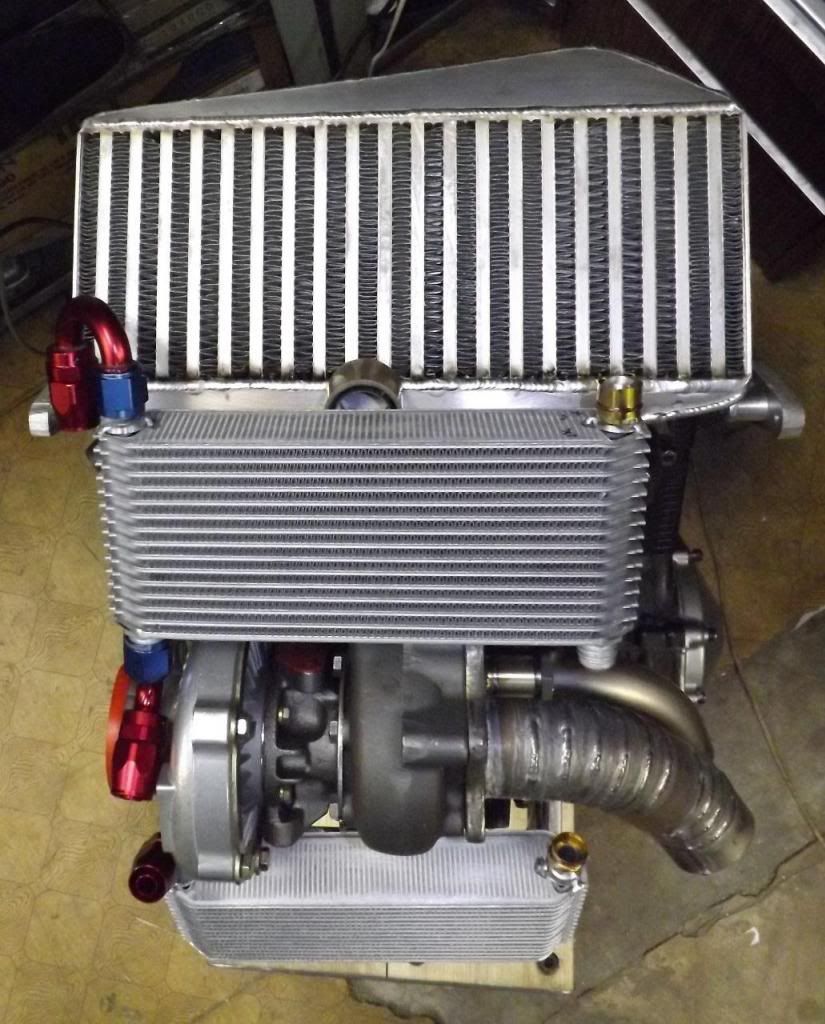

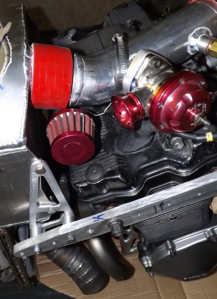

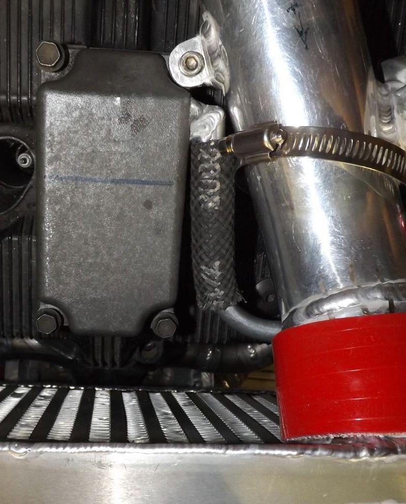

havent had a chance to continue welding the holes around bungs therefore trimmed the i.c. side plates instead
http://i1175.photobucket.com/albums/...r/DSCF5105.jpg
the i.c. levitates, bloody miracle!
http://i1175.photobucket.com/albums/...r/DSCF5106.jpg
you got the idea
http://i1175.photobucket.com/albums/...r/DSCF5107.jpg

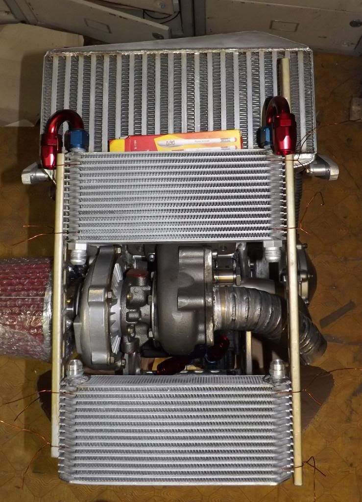

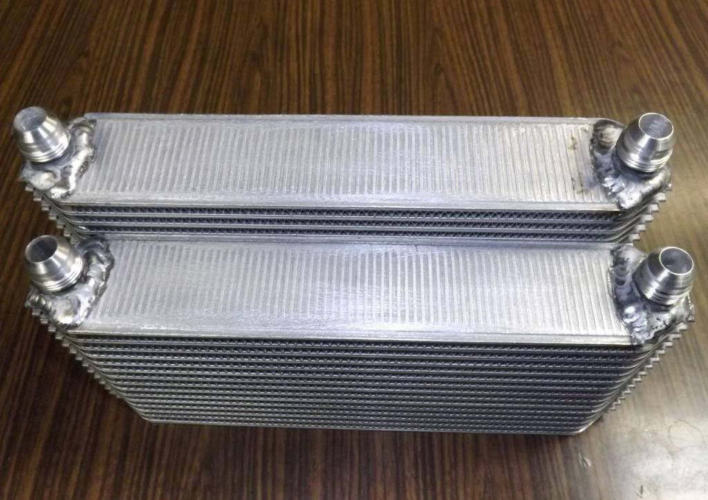

will have to set the coolers off to the right due to the compressor housing
will be hidden by scoops tho
http://i1175.photobucket.com/albums/...r/DSCF5108.jpg
the coolers r prolley gunna be set at the same angle but i don't promise
http://i1175.photobucket.com/albums/...r/DSCF5109.jpg

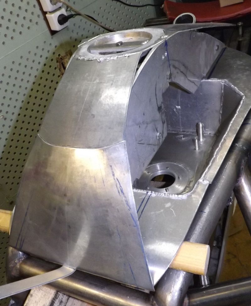

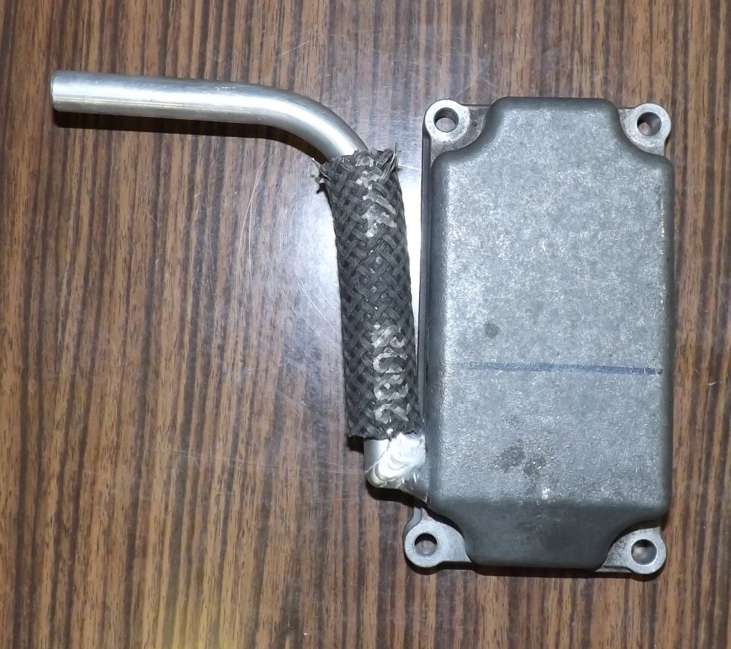

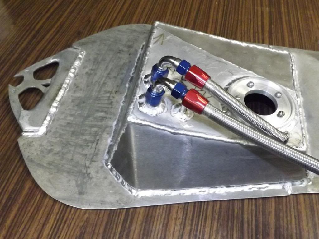

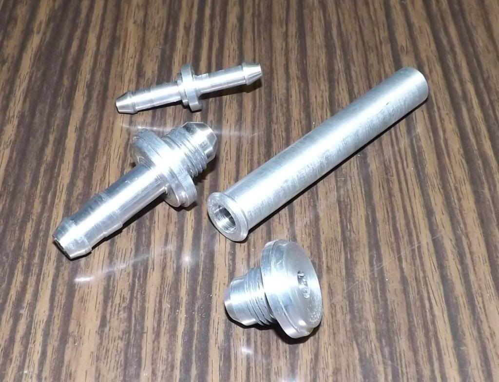

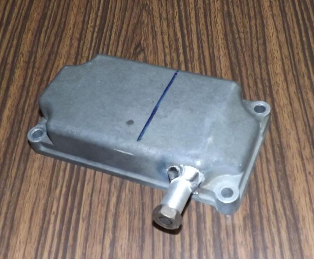

the bungs for fuel pick up and return as well as for tank vent and engine vent are all made
http://i1175.photobucket.com/albums/...r/DSCF5115.jpg
breather nipple's gotta be turned away off i.c. piping
http://i1175.photobucket.com/albums/...r/DSCF5116.jpg

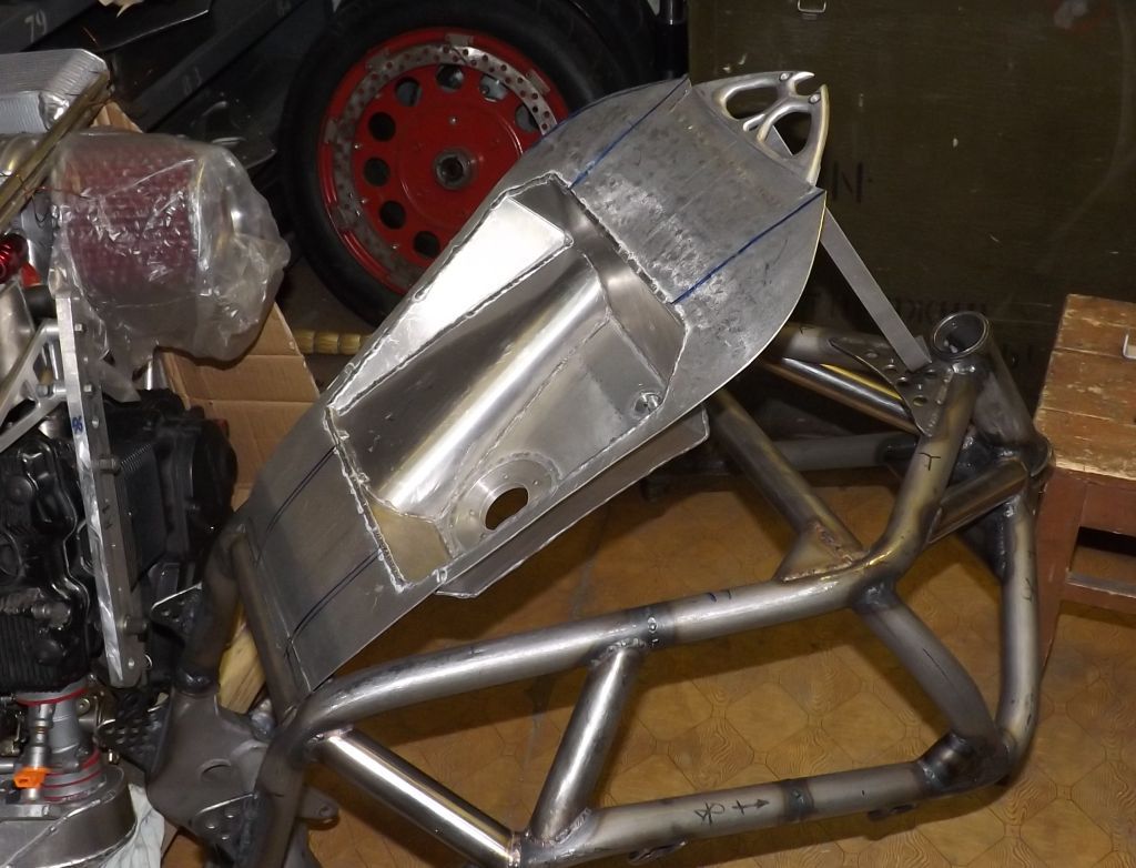

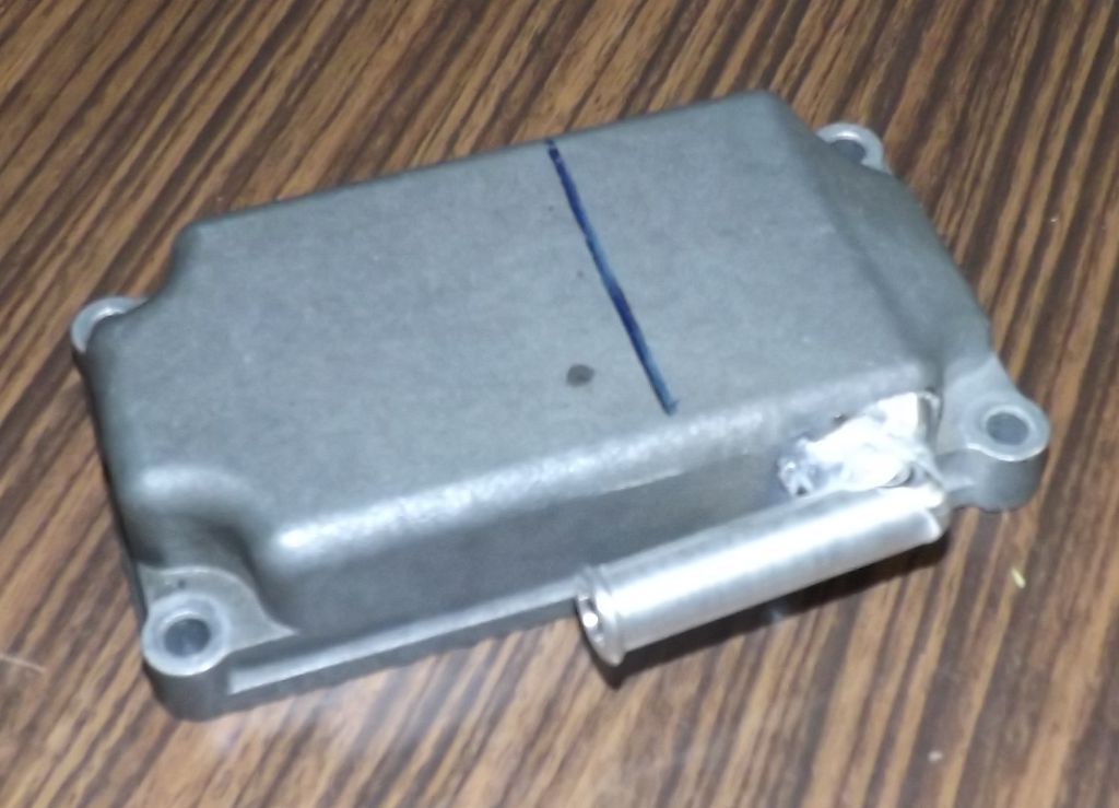

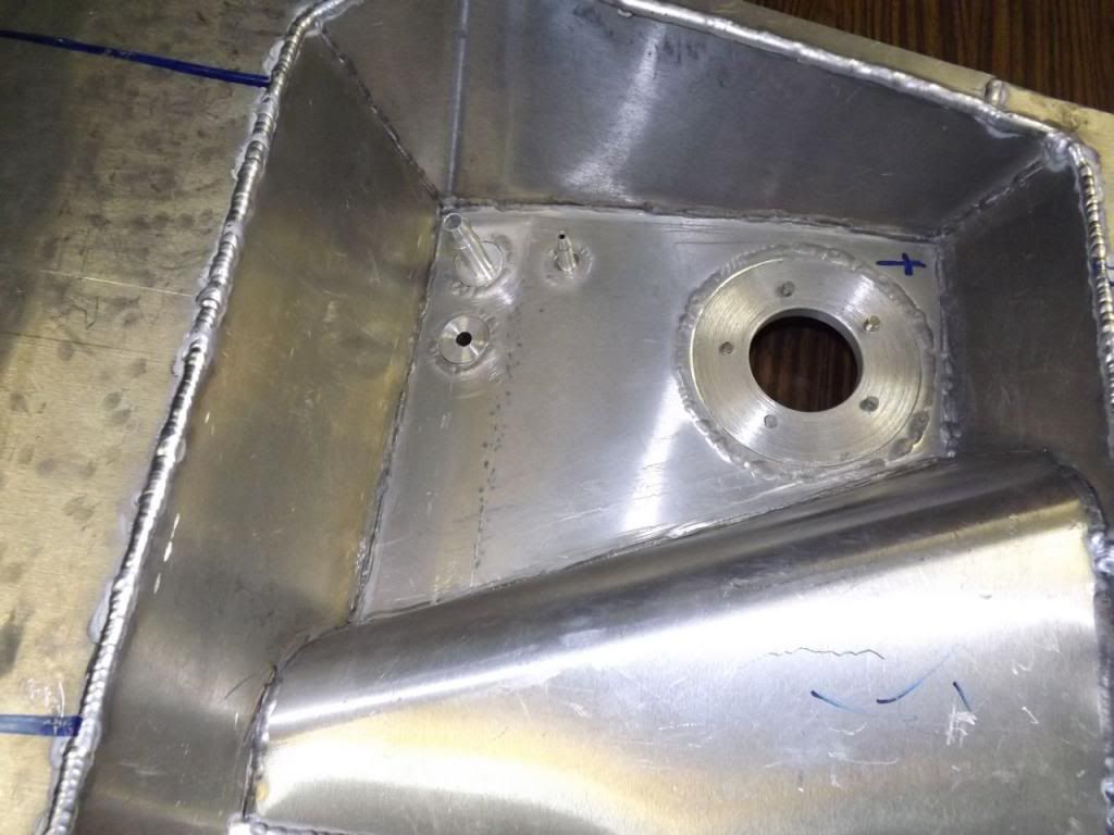

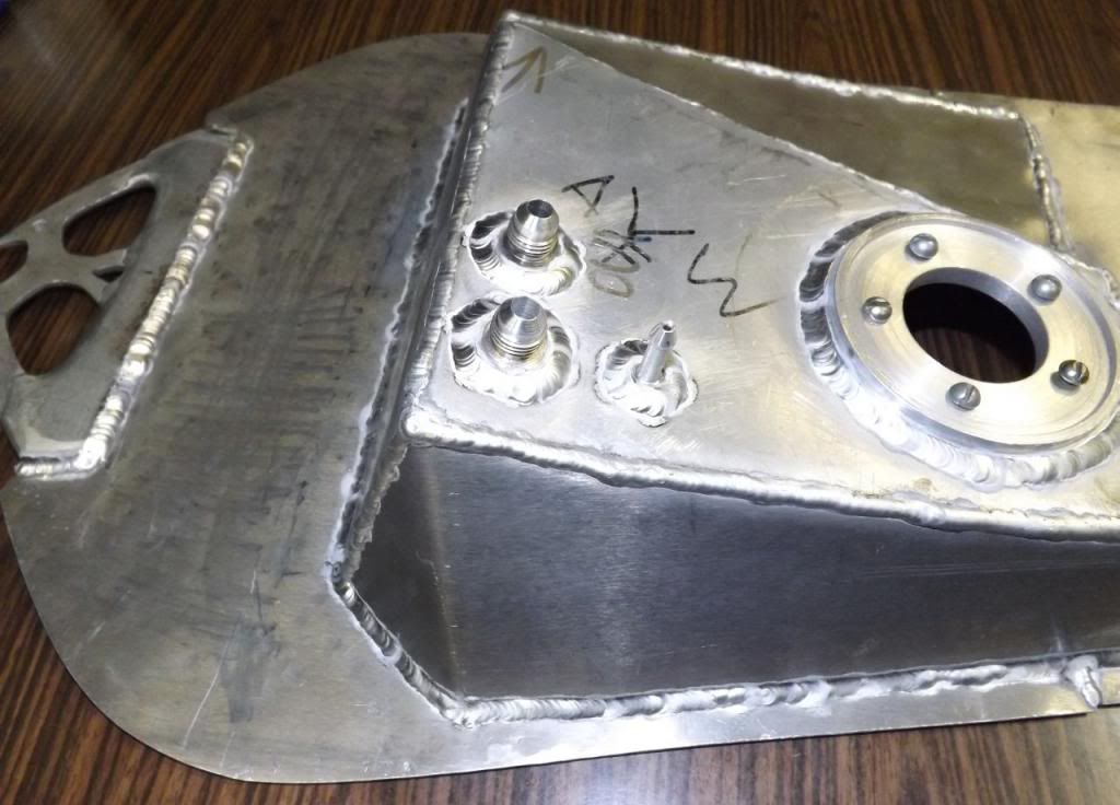

been workin out the best location for the bungs, the lowerest point of the tank for fuel pick up is the front part of the "sink" so be it! pretty close to the head cover thats why the bungs r welded directly in the tank instead of using traditional scheme where weld on metric bung with metric to AN adapters are used...
http://i1175.photobucket.com/albums/...r/DSCF5117.jpg
http://i1175.photobucket.com/albums/...r/DSCF5119.jpg

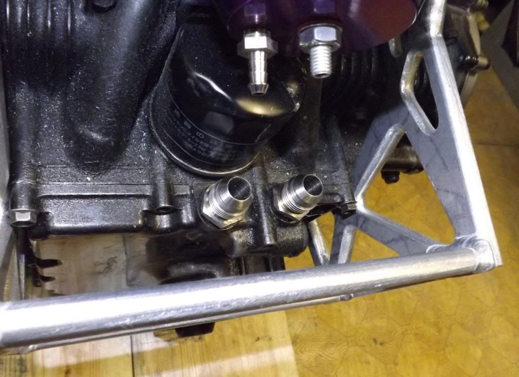

AN8 fittings r borrowed from the christCRUSHER project may Satan keep it at hand at the gates of hell
http://i1175.photobucket.com/albums/...r/DSCF5120.jpg

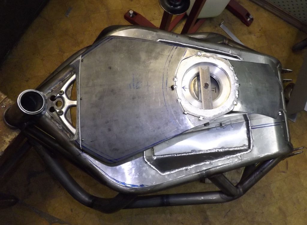

http://i1175.photobucket.com/albums/...r/DSCF5121.jpg
http://i1175.photobucket.com/albums/...r/DSCF5127.jpg
http://i1175.photobucket.com/albums/...r/DSCF5129.jpg
http://i1175.photobucket.com/albums/...r/DSCF5130.jpg

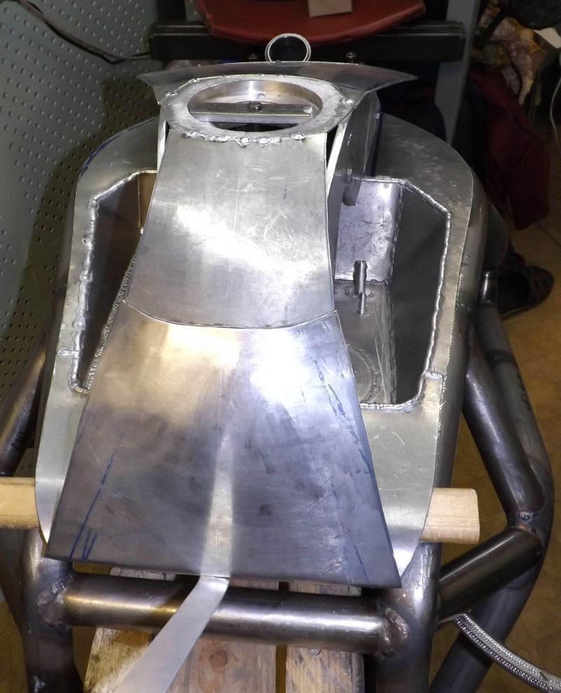

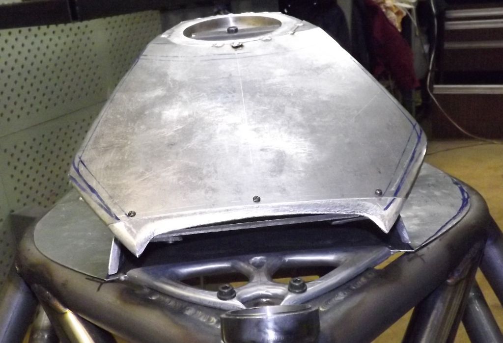

lets tank!
http://i1175.photobucket.com/albums/...r/DSCF5131.jpg
http://i1175.photobucket.com/albums/...r/DSCF5132.jpg
http://i1175.photobucket.com/albums/...r/DSCF5133.jpg
http://i1175.photobucket.com/albums/...r/DSCF5134.jpg
http://i1175.photobucket.com/albums/...r/DSCF5135.jpg
http://i1175.photobucket.com/albums/...r/DSCF5136.jpg
http://i1175.photobucket.com/albums/...r/DSCF5137.jpg

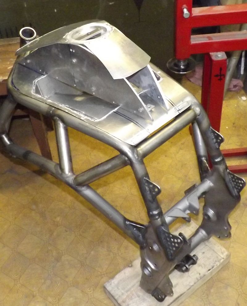

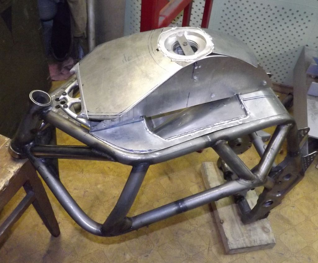

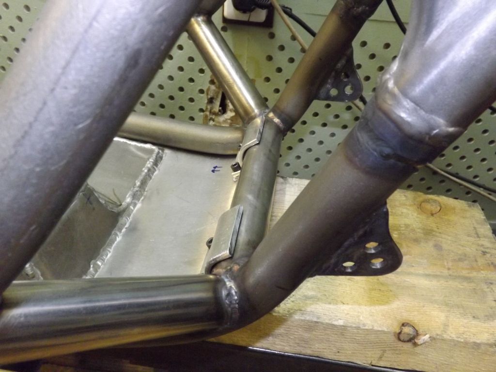

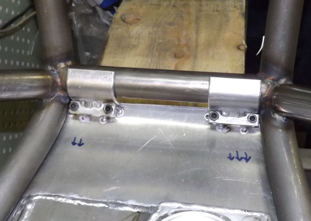

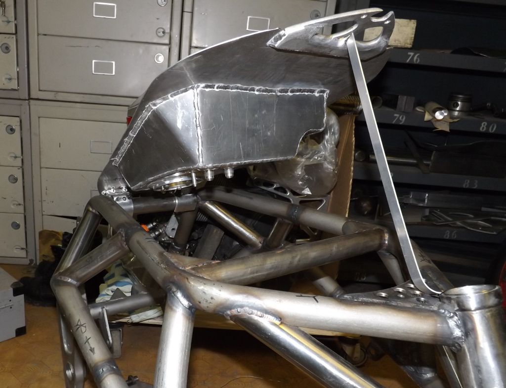

rear mounts are simple as
http://i1175.photobucket.com/albums/...r/DSCF5138.jpg
http://i1175.photobucket.com/albums/...r/DSCF5140.jpg
but they do their job alright - the tank can be easily removed or just raised
http://i1175.photobucket.com/albums/...r/DSCF5141.jpg
http://i1175.photobucket.com/albums/...r/DSCF5143.jpg

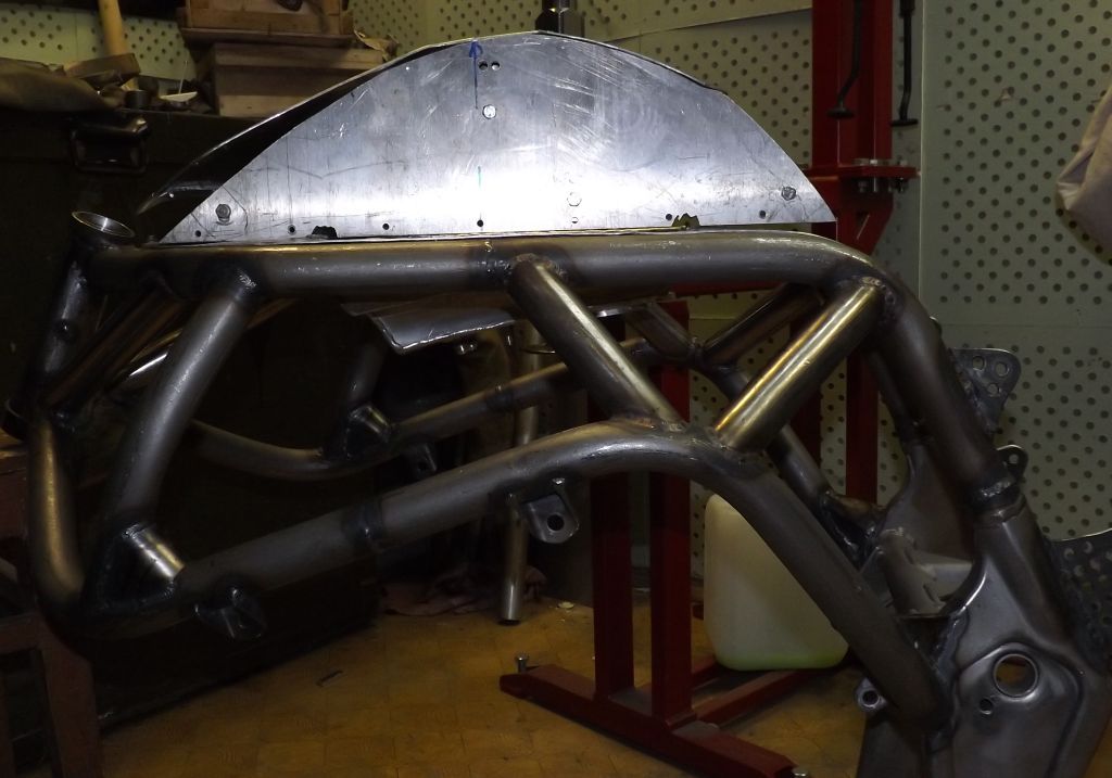

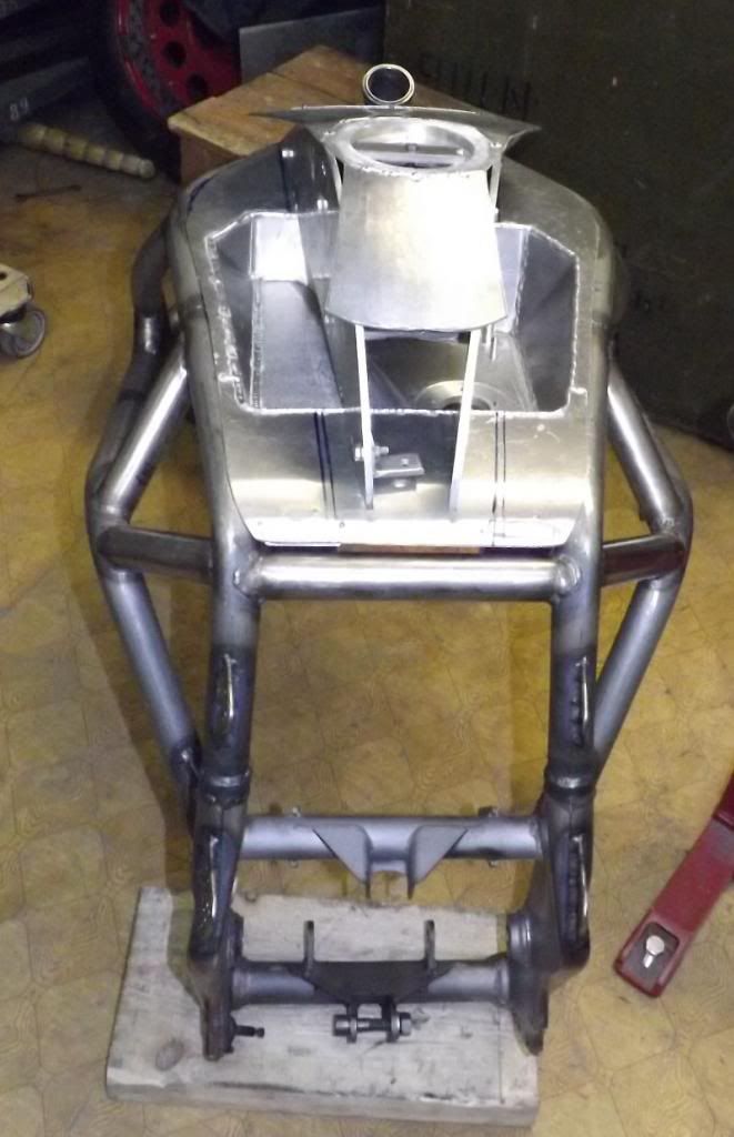

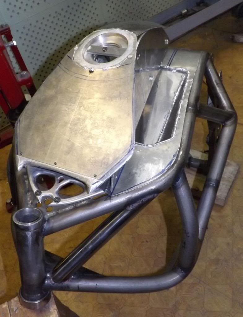

the rear panel is ready for welder
http://i1175.photobucket.com/albums/...r/DSCF5144.jpg
http://i1175.photobucket.com/albums/...r/DSCF5145.jpg
How are you planing to form the sides of the tank Surt ? English wheel ?
yup the same e'wheel that formed the upper panels mate
Sweet ! Get to it then.... lol
