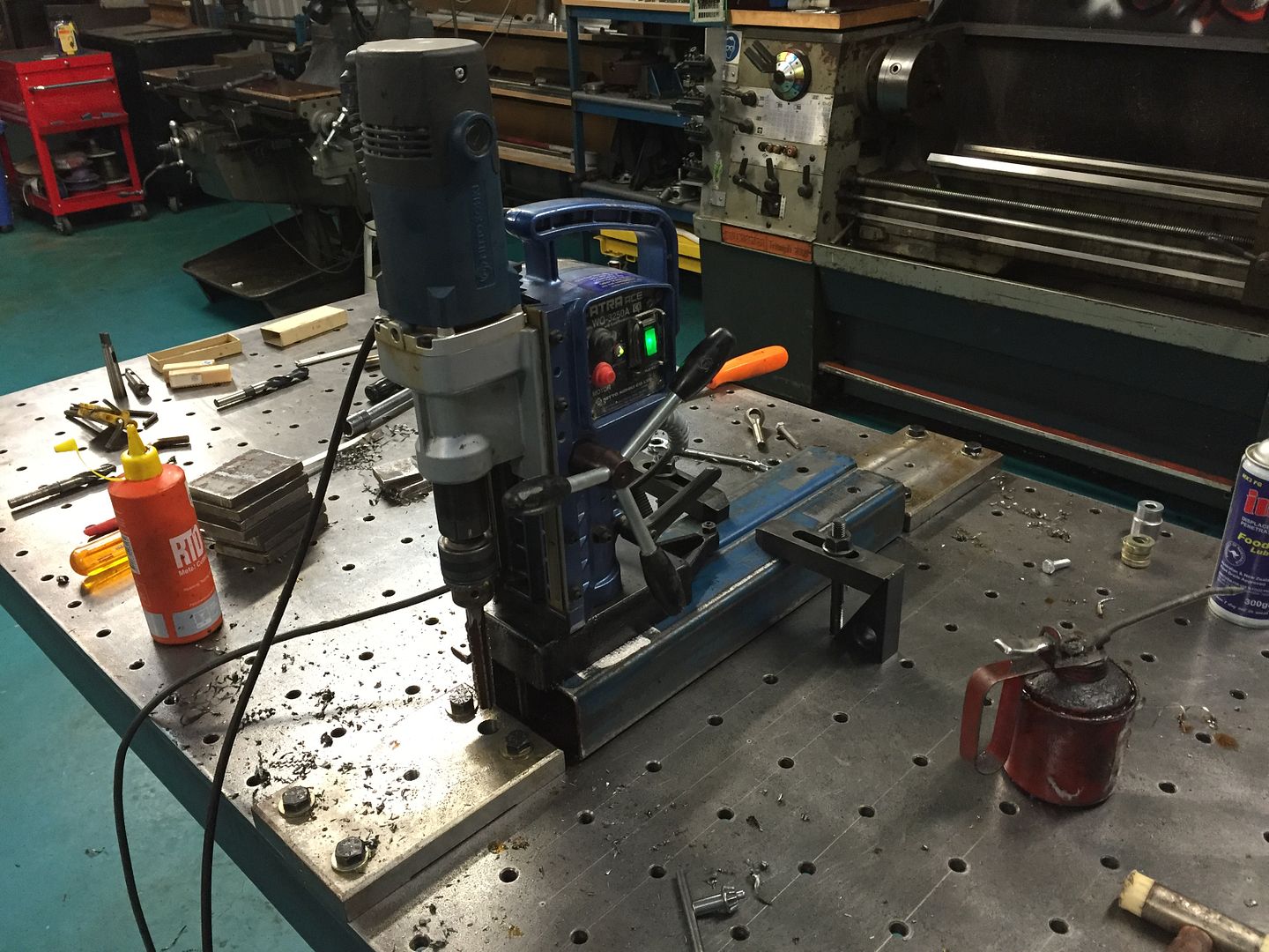

now I have my fab table backi can spend my lonely Saturday nights doing much more interesting things
like to some test holes for the reamed tapper dowels I will be using to locate the main part of my frame jig.
Im using a mt2 tapper because the mt2-mt1 drill adaptors I will use for dowels are cheep as chips

location tapered holes check........
