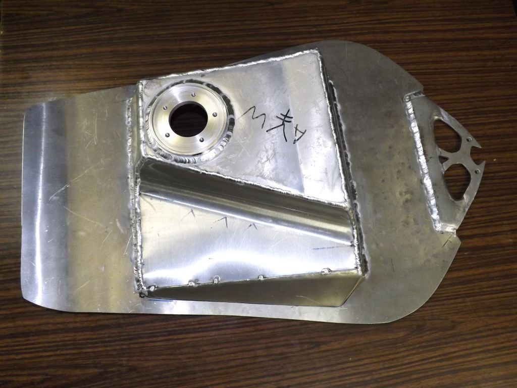

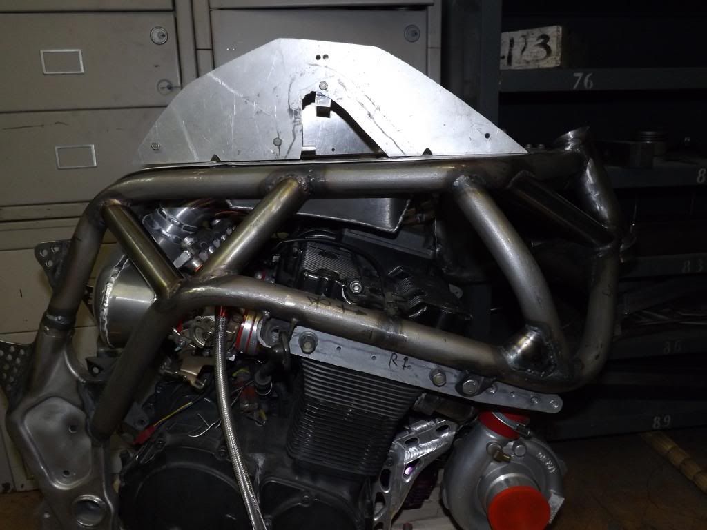

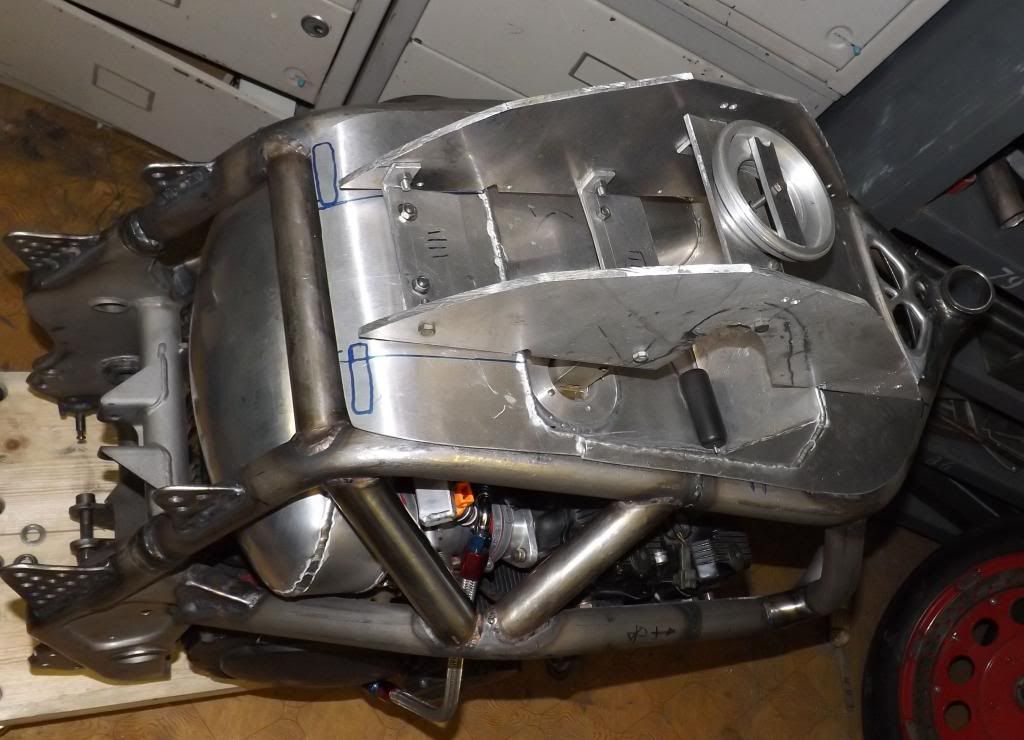

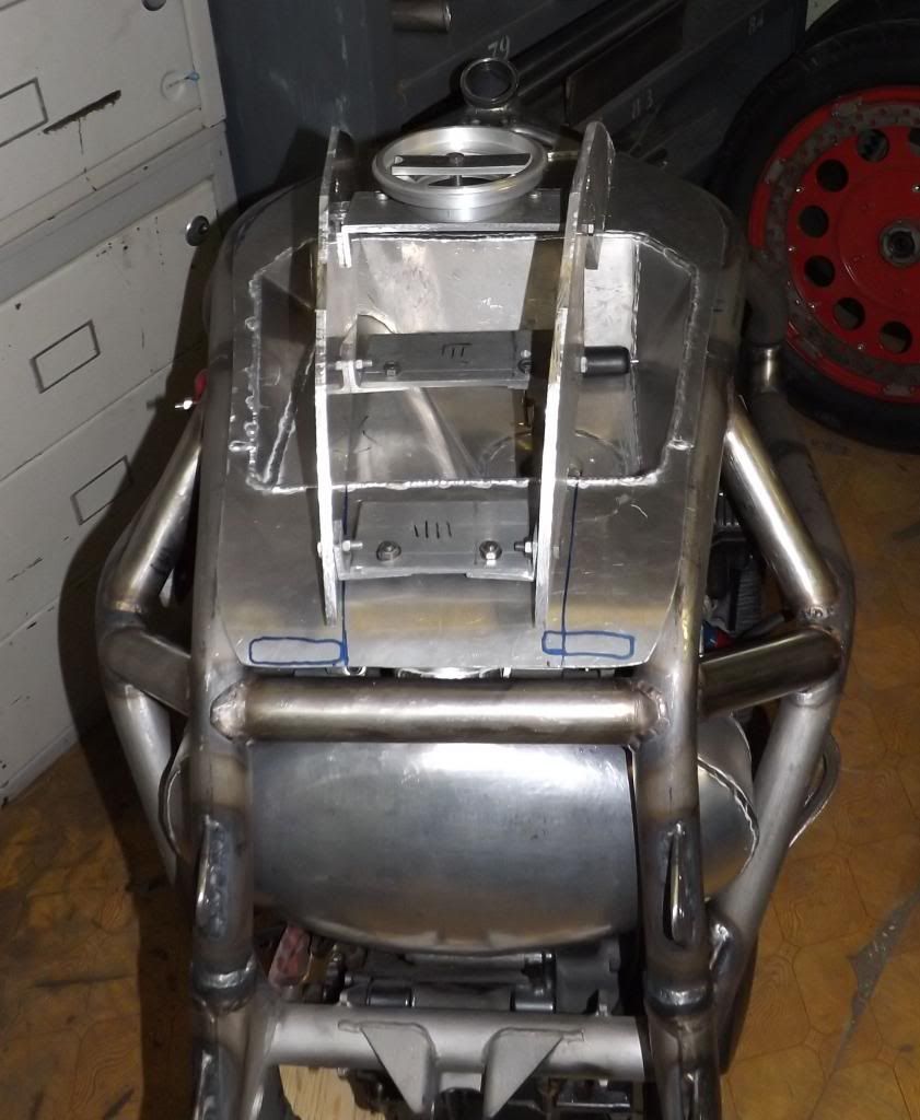

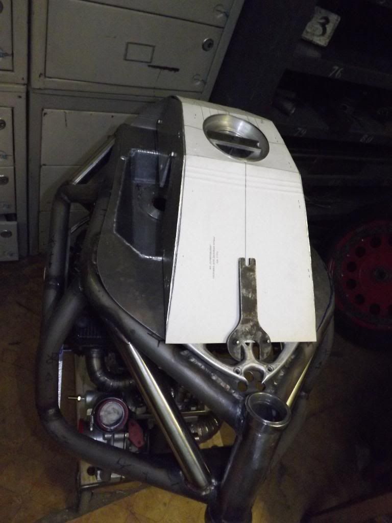

the extension is almost finished just fuel pick up and return bungs r to be made
http://i1175.photobucket.com/albums/...r/DSCF5059.jpg

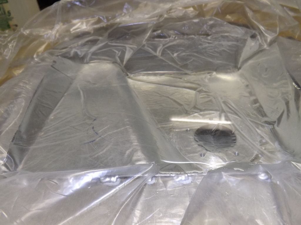

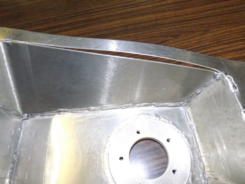

the base's shrunk due to welding but not that bad as it looks - just 1mm so i made 2 cuts to take away extra length
http://i1175.photobucket.com/albums/...r/DSCF5060.jpg

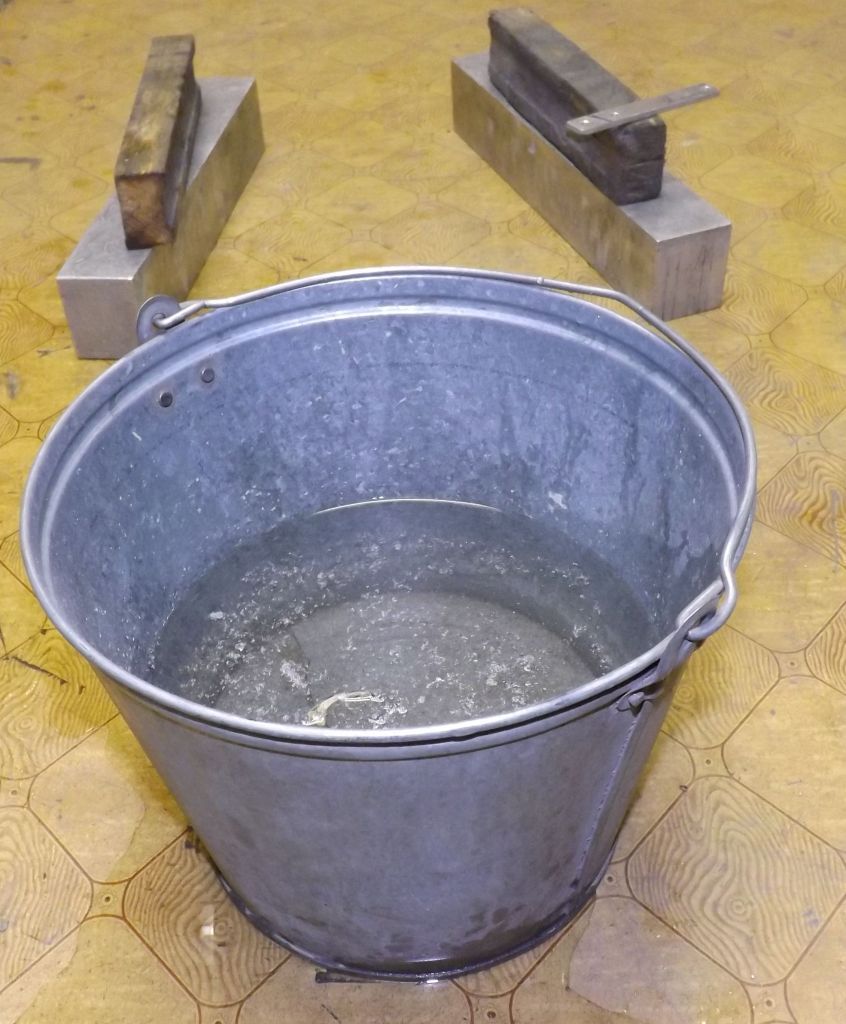

the base's levelled covered with a poly film and filled with water to find out the extension capacity
just like i presumed its about 4l not bad! i expect the upper pert capacity is gunna be like 15l so 15+4 is just wat i need
http://i1175.photobucket.com/albums/...r/DSCF5062.jpg
lol 4l in 10l bucket cept spilled water
http://i1175.photobucket.com/albums/...r/DSCF5064.jpg

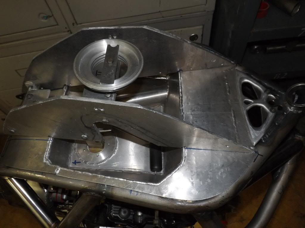

plunger rod's reshaped
http://i1175.photobucket.com/albums/...r/DSCF5082.jpg

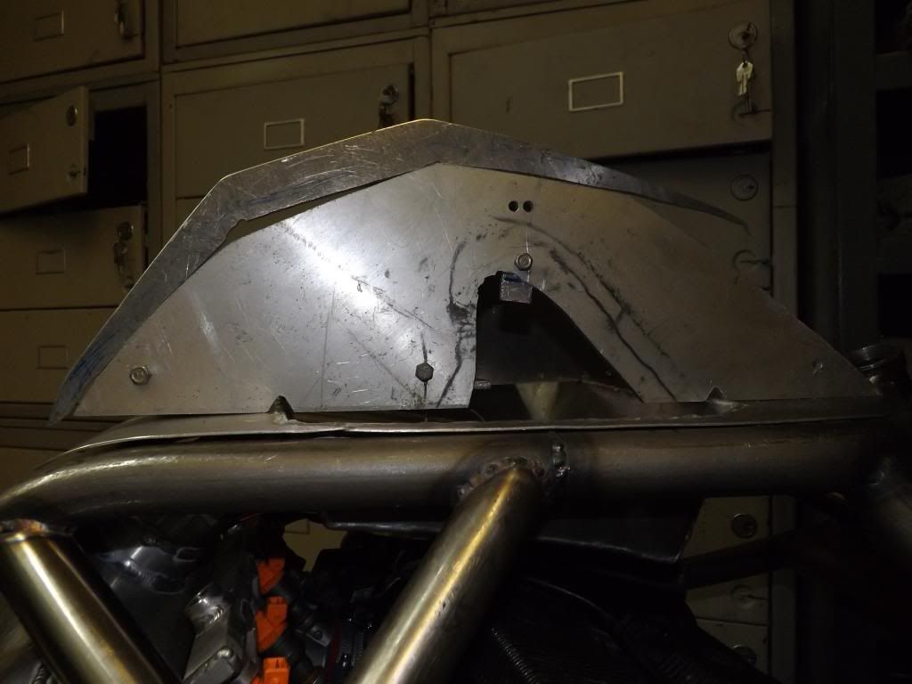

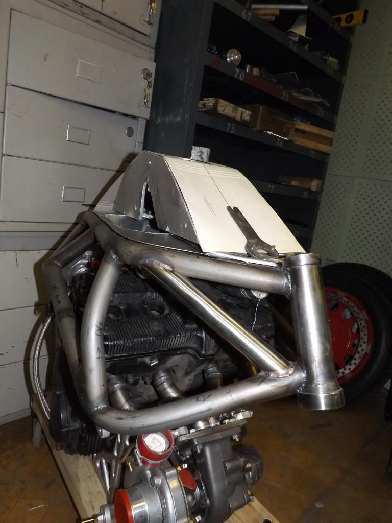

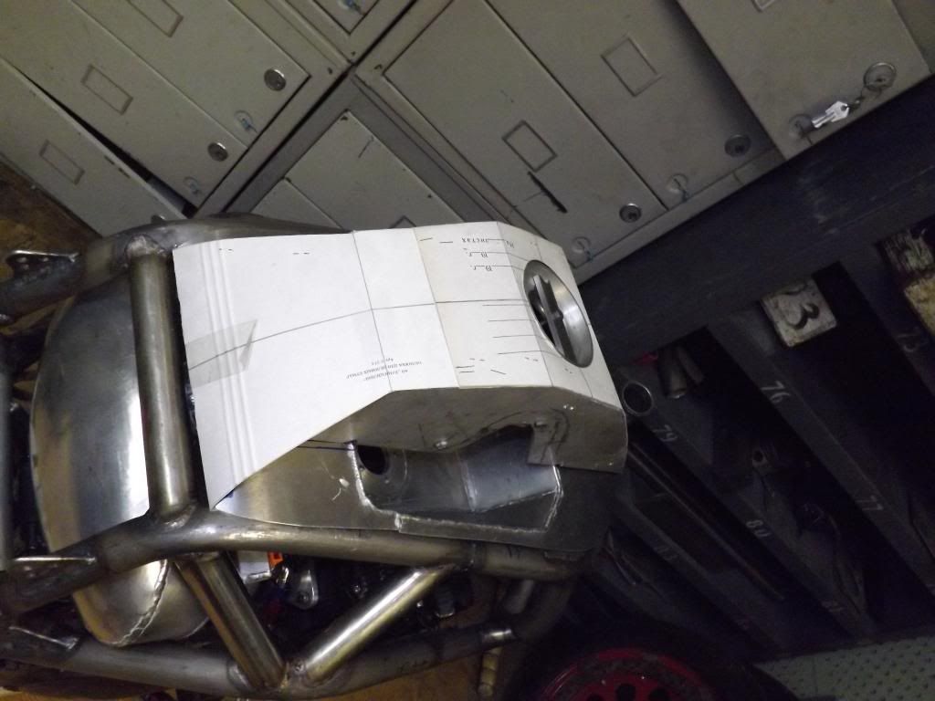

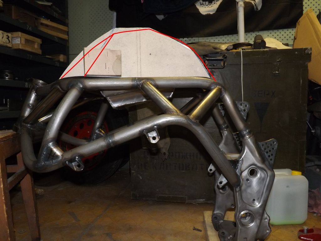

tank's profile revised
previously
http://i1175.photobucket.com/albums/...r/DSCF5078.jpg
now... sorta
http://i1175.photobucket.com/albums/...DSCF5077_1.jpg
after all lol
http://i1175.photobucket.com/albums/...r/DSCF5083.jpg

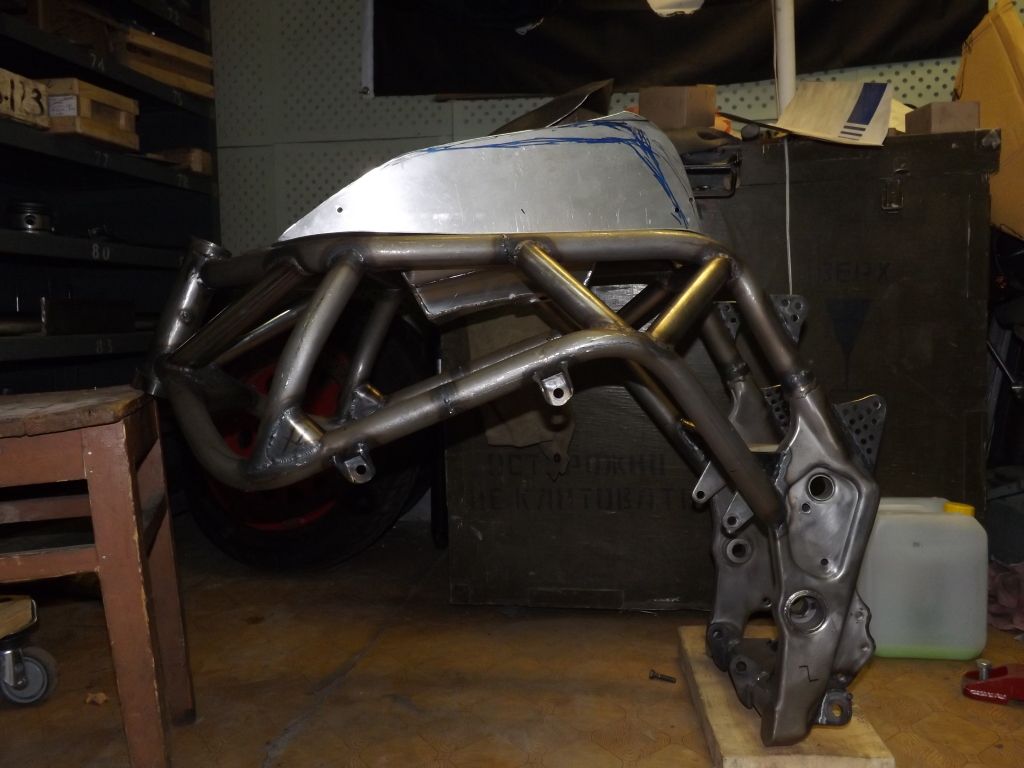

was lowered for about 30mm
http://i1175.photobucket.com/albums/...r/DSCF5087.jpg
pretty much satisfied with the shape now
http://i1175.photobucket.com/albums/...r/DSCF5084.jpg
http://i1175.photobucket.com/albums/...r/DSCF5085.jpg
http://i1175.photobucket.com/albums/...r/DSCF5086.jpg
http://i1175.photobucket.com/albums/...r/DSCF5088.jpg
http://i1175.photobucket.com/albums/...r/DSCF5089.jpg
http://i1175.photobucket.com/albums/...r/DSCF5091.jpg
reckon it'll go faster now when design probs r sorted out

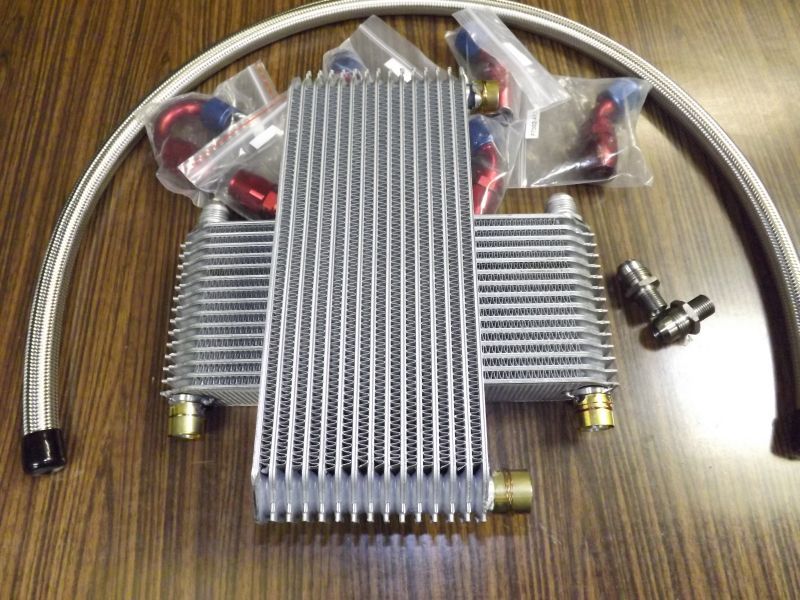

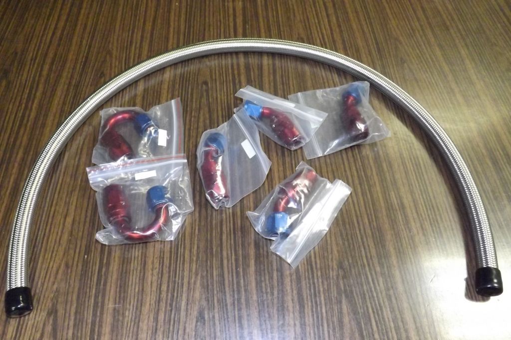

while custom bungs for fuel feed, return and ventilation are in work lets switch to the sawn oil cooler

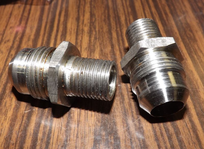

an10 fittings and hose were bought about a month a go
http://i1175.photobucket.com/albums/...r/DSCF5093.jpg
an10 to m16x1.5 fittings replacing oil cooler banjos were made from stainless
http://i1175.photobucket.com/albums/...r/DSCF5094.jpg

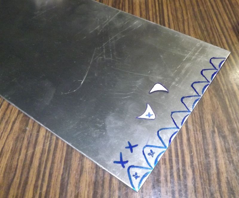

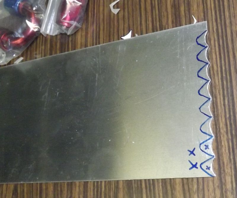

oil cooler halves r tidied up and bungs r tacked
http://i1175.photobucket.com/albums/...r/DSCF5095.jpg
http://i1175.photobucket.com/albums/...r/DSCF5098.jpg
u gotta do some weird shit sometimes to fulfil ur task, no ones gunna do it for ya!
walking the water and raising the dead is dirt cheap if ur daddy is a god but try making some fucking thongs for walking the water, nah, not messiah's business, no hocus pocus no fun lol
http://i1175.photobucket.com/albums/...r/DSCF5101.jpg
http://i1175.photobucket.com/albums/...r/DSCF5102.jpg
http://i1175.photobucket.com/albums/...r/DSCF5104.jpg

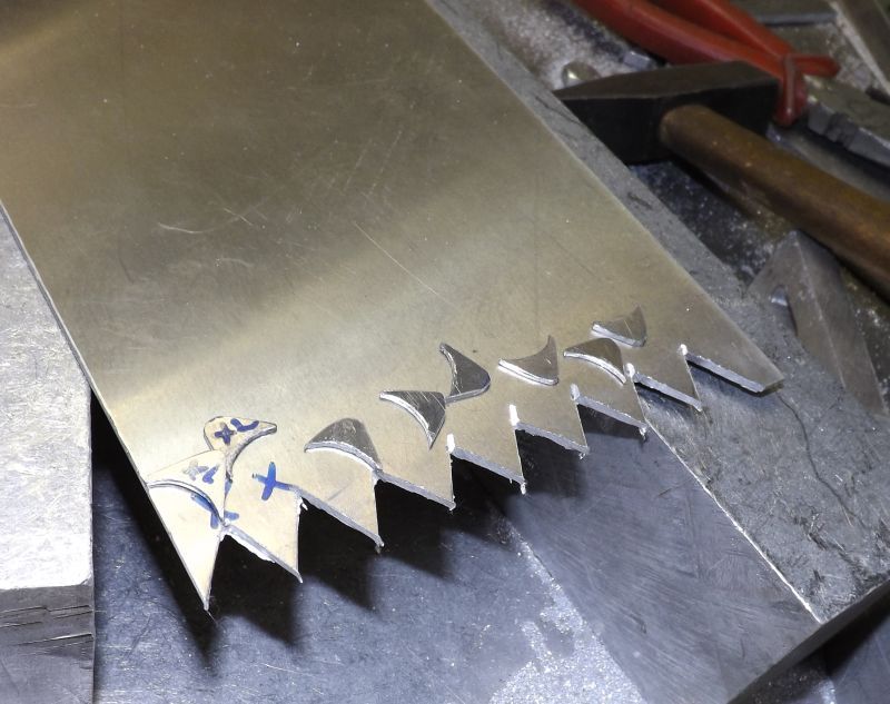

these r patches to cover the holes aside from the bungs
took an hour to make em tho
