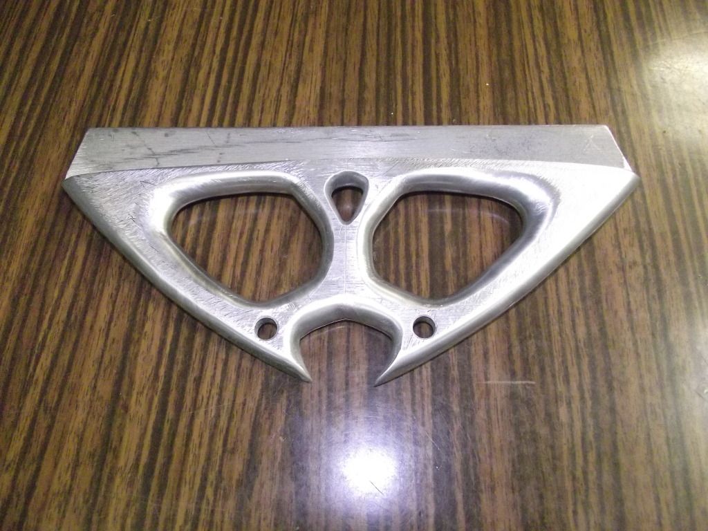

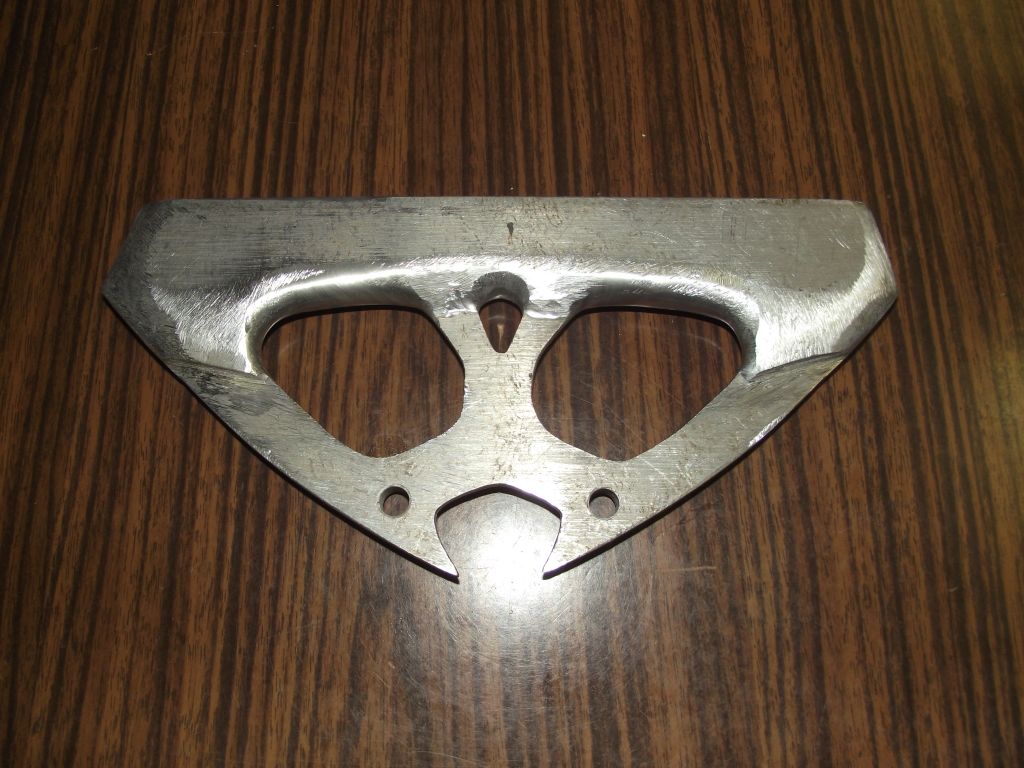

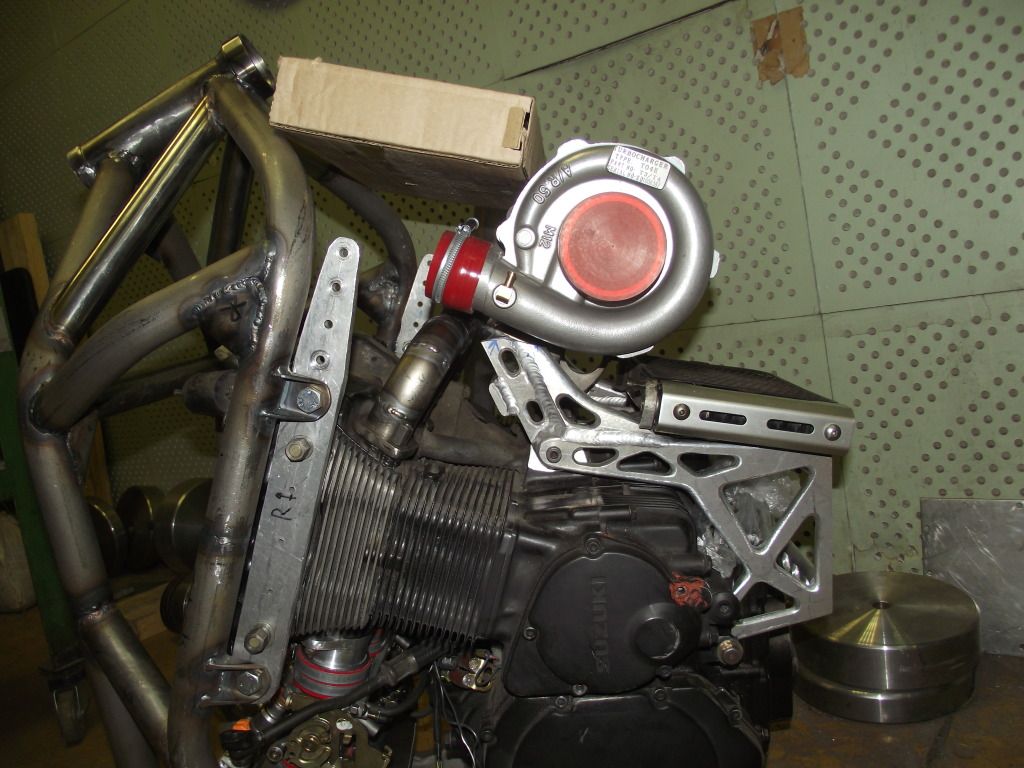

comparing a stock oil cooler to the mockup of 25 row cooler, much the same just a tas higher and thicker
http://i1175.photobucket.com/albums/...DSCF4871cr.jpg
therefore i decided to use 2 15 row oil collers
http://i1175.photobucket.com/albums/...r/DSCF4872.jpg
well at least a lower duct aint gunna be just for show
http://i1175.photobucket.com/albums/...r/DSCF4873.jpg

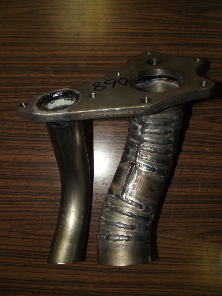

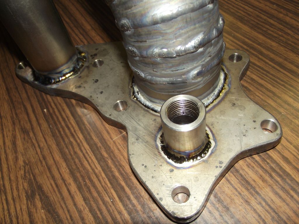

the zorsts finished
http://i1175.photobucket.com/albums/...r/DSCF4876.jpg
welded around both inside and outside
...and weighs in 890g
http://i1175.photobucket.com/albums/...r/DSCF4877.jpg
the hole for internal wg is used for afr sensor
http://i1175.photobucket.com/albums/...r/DSCF4878.jpg

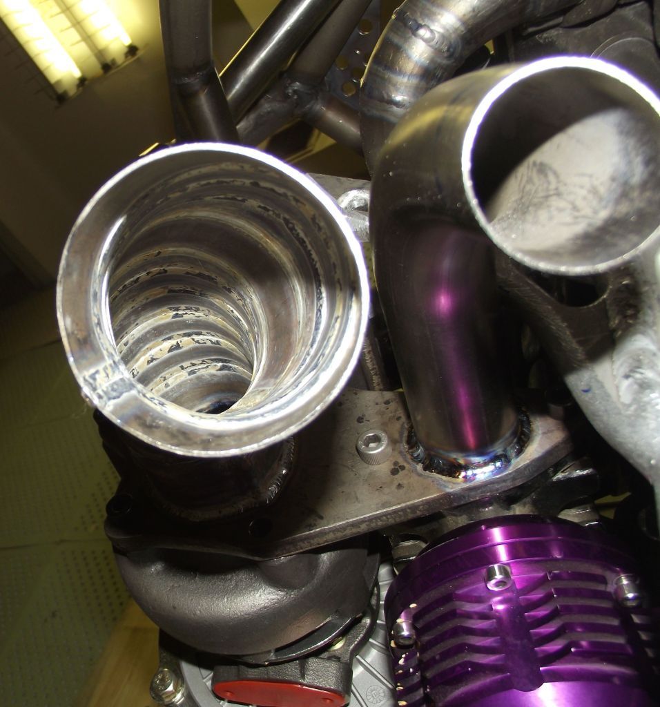

wanker proof, bent so that some wanker wouldn't poke into the turbine with a stick lol
http://i1175.photobucket.com/albums/...r/DSCF4882.jpg
http://i1175.photobucket.com/albums/...r/DSCF4879.jpg
http://i1175.photobucket.com/albums/...r/DSCF4881.jpg
http://i1175.photobucket.com/albums/...r/DSCF4883.jpg
Yes Yes and yes:D
hey man wat steel are you using for zort from turbo??
looks like ti
right guess banditrod, yip its titanium

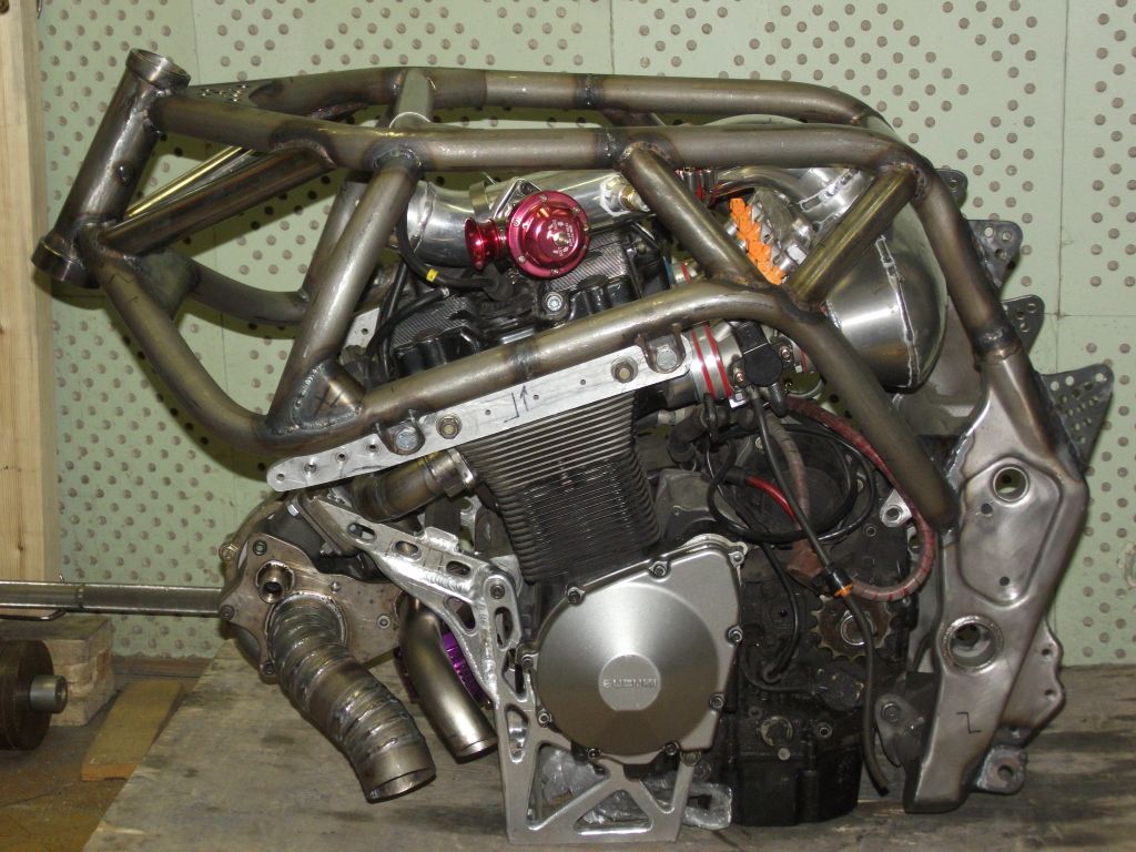

Looking good Surt. Well done.
I showed a couple of your pics, and Pete's T7-13 frame, to someone who said
I shouldn't have welded a broken lug back onto a frame. That ended that conversation.
Im watching this thread with interest.
thanks heaps Tony, have no idea what lug ur talkin about
I had something very minor break on one of mg bikes.
Guys who I ride with didn't like the idea of any "repairs"
to a standard frame! They were stunned by what you
were doing.... :cool:
well if its a steel not heat treated frame (there are ones!), welding is no prob, if an ally frame, ideally it should be annealed after welding. if its an ally heat treated frame, i wouldn't bet one penny on welding, and wouldn't ride that bike at any rate

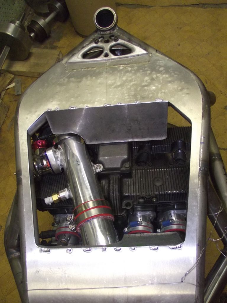

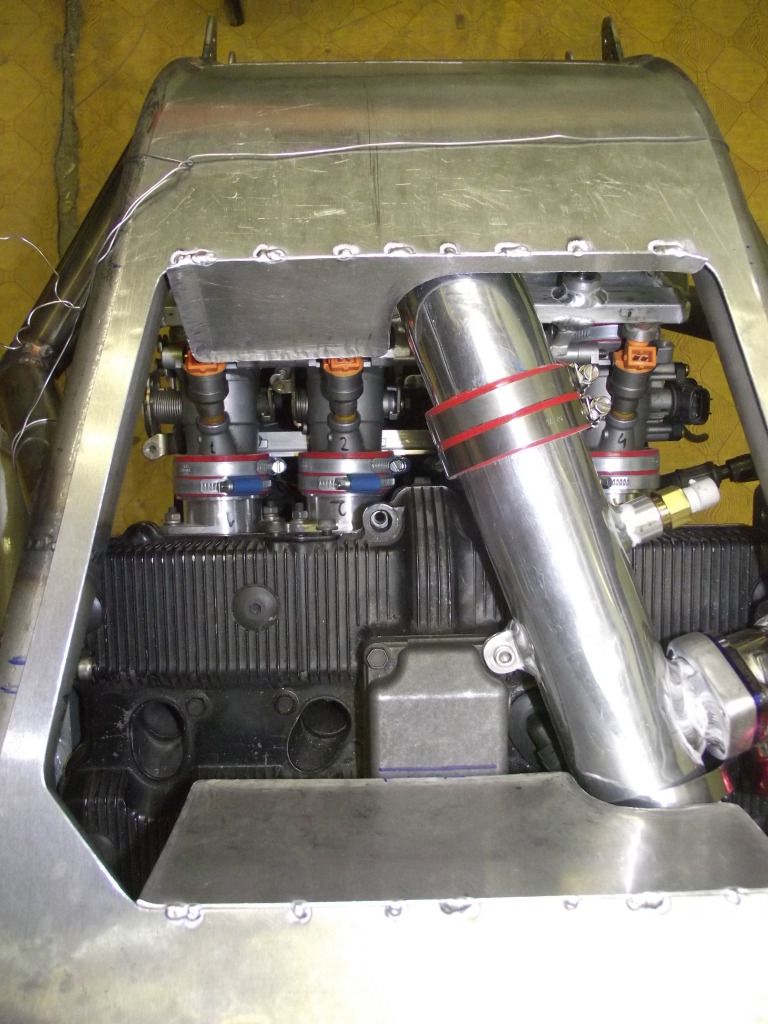

front mount
http://i1175.photobucket.com/albums/...r/DSCF4887.jpg
http://i1175.photobucket.com/albums/...r/DSCF4888.jpg
the base with an additional volume underneath
http://i1175.photobucket.com/albums/...r/DSCF4915.jpg
http://i1175.photobucket.com/albums/...r/DSCF4916.jpg
