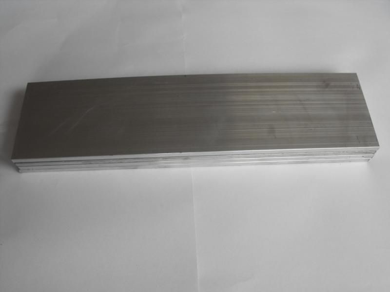

Going to be busy with work for the next 7 days so wont get a chance to do any thing. Did manage to make up some card board templates so you guys can see the exact shape they will be. I have a jigsaw, can a jigsaw cut 10mm thick aluminium ? If so maybe I could cut these brackets out of 10mm & then double them up to make 20mm .
Edit- Ok, so I searched online & yeah you can cut 10mm thick aluminium with a jigsaw !
So I'm going to try it, probably have to wait a week or 2.

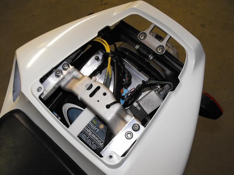

Lithium battery mounted.
http://i1101.photobucket.com/albums/...0/DSCF5411.jpg

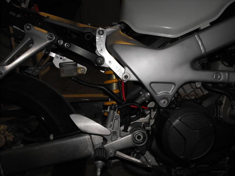

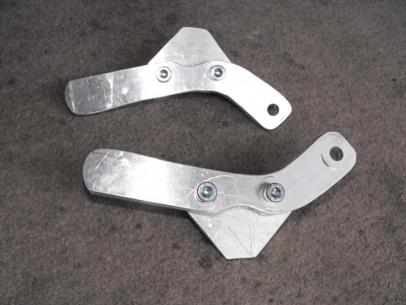

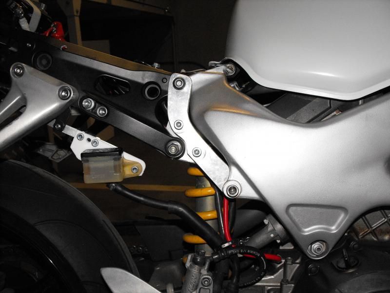

I got some time to make up some new subframe brackets. :D
Went & got some aluminium flat bar,
http://i1101.photobucket.com/albums/...0/DSCF5019.jpg
Traced my cardboard templates onto the flat bar & grabbed my jigsaw, ended up with these,
http://i1101.photobucket.com/albums/...0/DSCF5033.jpg
This is how they look,
http://i1101.photobucket.com/albums/...0/DSCF5034.jpg
http://i1101.photobucket.com/albums/...0/DSCF5040.jpg
Might paint them black, not sure yet. Anyway, took me around 3 hours to make.
And I gotta say thanks to xa-mont & wackyrider for offering to draw the brackets up in there computers for the water jet people, its guys like you that make this forum AWESOME !! :p

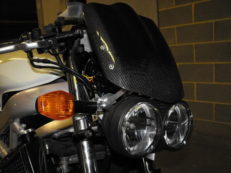

Mounted my screen,
http://i1101.photobucket.com/albums/...0/DSCF5459.jpg
Looks much better bloke
Nice :)

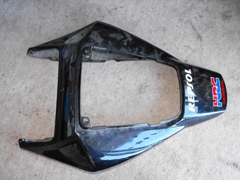

I got a 07 cbr1000rr rear fairing, it's busted up a bit, but I'm going to try some thing with it. A little cut & chop.
http://i1101.photobucket.com/albums/...0/DSCF5349.jpg
http://i1101.photobucket.com/albums/...0/DSCF5348.jpg

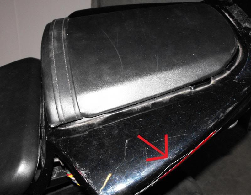

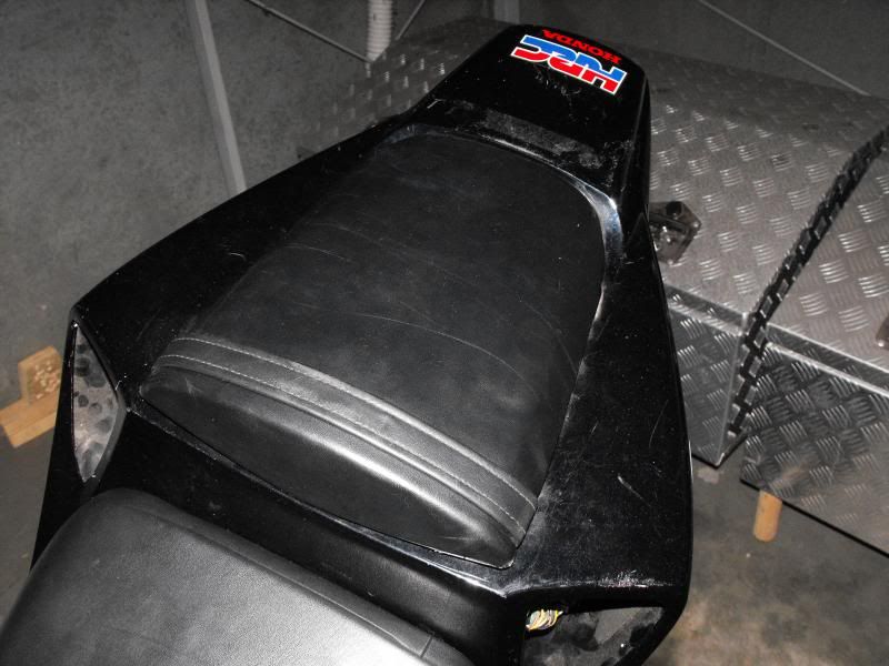

Also got a cbr600rr rear seat, think it was 2008 (to tired to think right now) it is a little bit small, but should do the job for now.
http://i1101.photobucket.com/albums/...0/DSCF5380.jpg

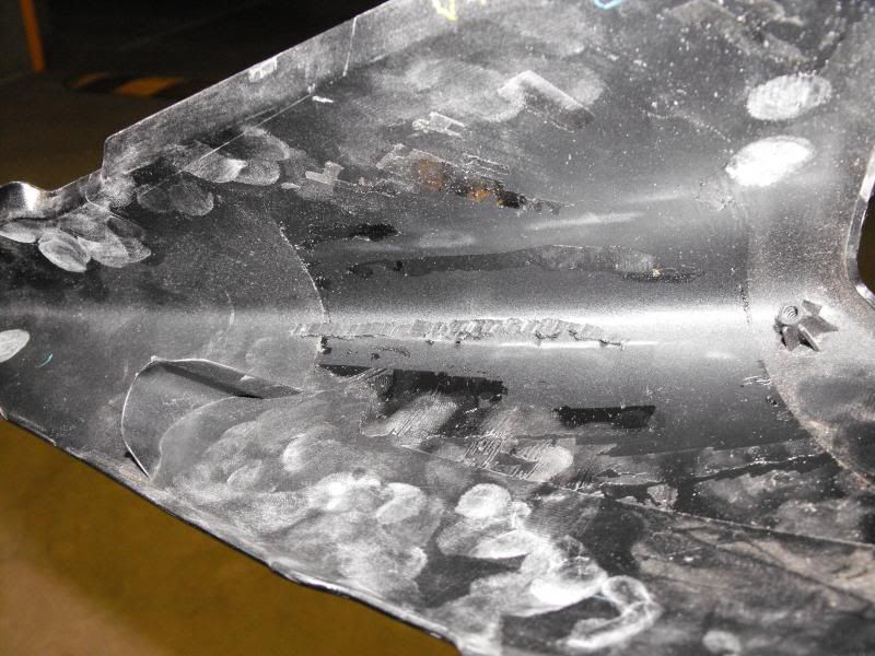

You can see in this pic, one of the cracks, around 15cm's long, there is also 2 more cracks on the other side.
And you can also see how the cbr600rr seat is a little bit small.
http://i1101.photobucket.com/albums/.../DSCF5379a.jpg

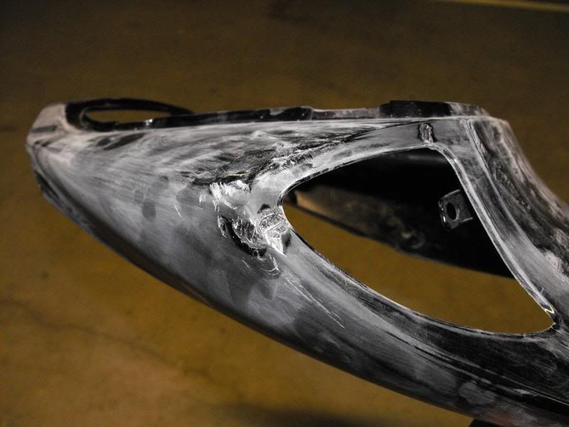

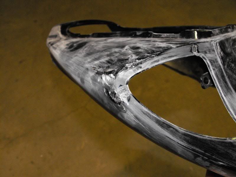

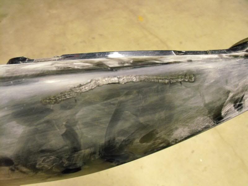

Going to try & plastic weld the cracks with my soldering iron,
If it doesn't work I might just put some 1000 stickers over the crack, cause the crack is about the same spot the original stickers go. See how it goes, not to fussed if it doesn't work.
http://i1101.photobucket.com/albums/...0/DSCF5421.jpg
http://i1101.photobucket.com/albums/...0/DSCF5428.jpg
Not sure how strong it will be ? Might need to melt some plastic zip ties into it.
http://i1101.photobucket.com/albums/...0/DSCF5427.jpg

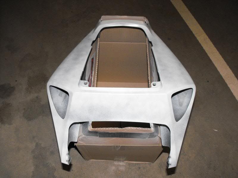

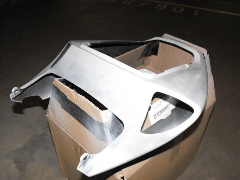

And if you didn't notice, I have cut around 17cm from the rear of the fairing.
I new it was going to be to long from the start & was always planning on giving it the chop.
http://i1101.photobucket.com/albums/...0/DSCF5426.jpg

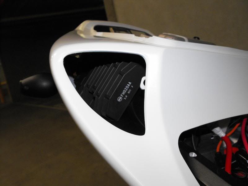

The R/R should get plenty of air in there.
http://i1101.photobucket.com/albums/...0/DSCF5468.jpg
speedy work. nice one.

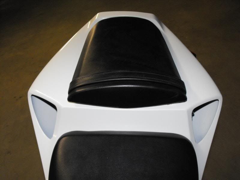

Got some vents for the rear fairing.
http://i1101.photobucket.com/albums/...0/DSCF5079.jpg
Going to drill some holes in the back of the right hand side vent so more air gets to the R/R,
http://i1101.photobucket.com/albums/...0/DSCF5078.jpg

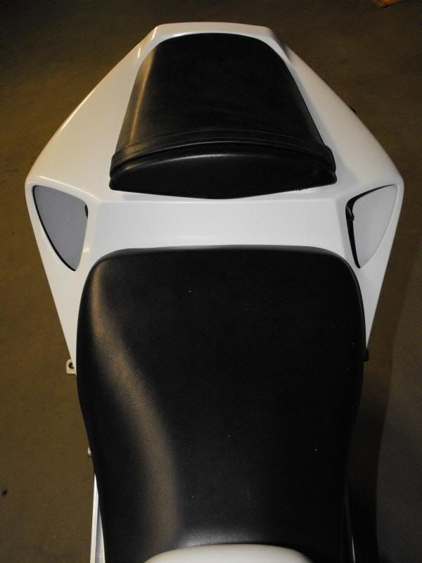

Starting to come together,
http://i1101.photobucket.com/albums/...0/DSCF5439.jpg
http://i1101.photobucket.com/albums/...0/DSCF5447.jpg
