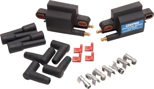

I was looking into the ignition system options & almost bought an advanced ignition rotor, For a bit more money I can get a DYNA programmable ignition which would work out much better in the long run, It will fit the ZXR 750 & it will also work on the ZX9 motor if I upgrade later on, I can also buy the DYNA coils & leads together as a package too
I have been curious if there was any options for performance coils? The bike seems to run fine but considering the bike is near 20 years old im sure the coils would be getting tired?
DDK2-7
Programmable performance ignition
http://www.dynaonline.com/skins/prod...kes/dyna_2000/
DC1-2
3.0 OHM Dual output mini coils
http://www.dynaonline.com/skins/prod...rtbikes/coils/
DW-800

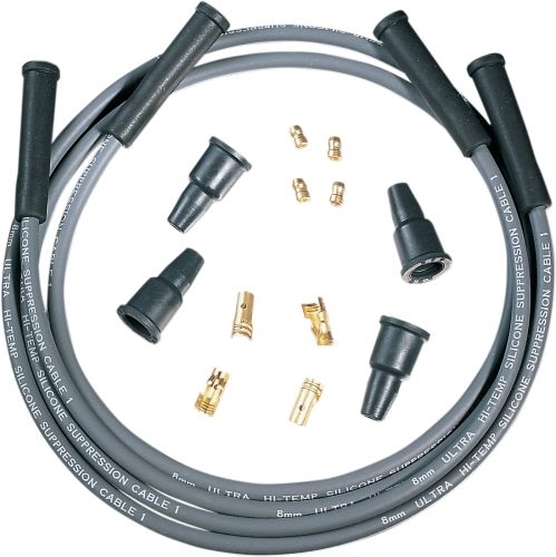

Grey silicone 8mm leads
http://www.dynaonline.com/skins/prod...es/Dyna_Wires/
Is anyone using DYNA ignition stuff? Any good? Any troubles?

i'm running dyna coils. i have had them for years and never any problem. i don't know if you'll get much more out of it though. if you advance much more than 5 degrees it'll start knocking and you can get a better spark by running different plugs. NGK CR9EK plugs are the the go for the old zxr. they're not cheap but they are good.
Thanks, I was also thinking about some better plugs too, What sort of money are you paying for the plugs?
Good to know the coils have been reliable

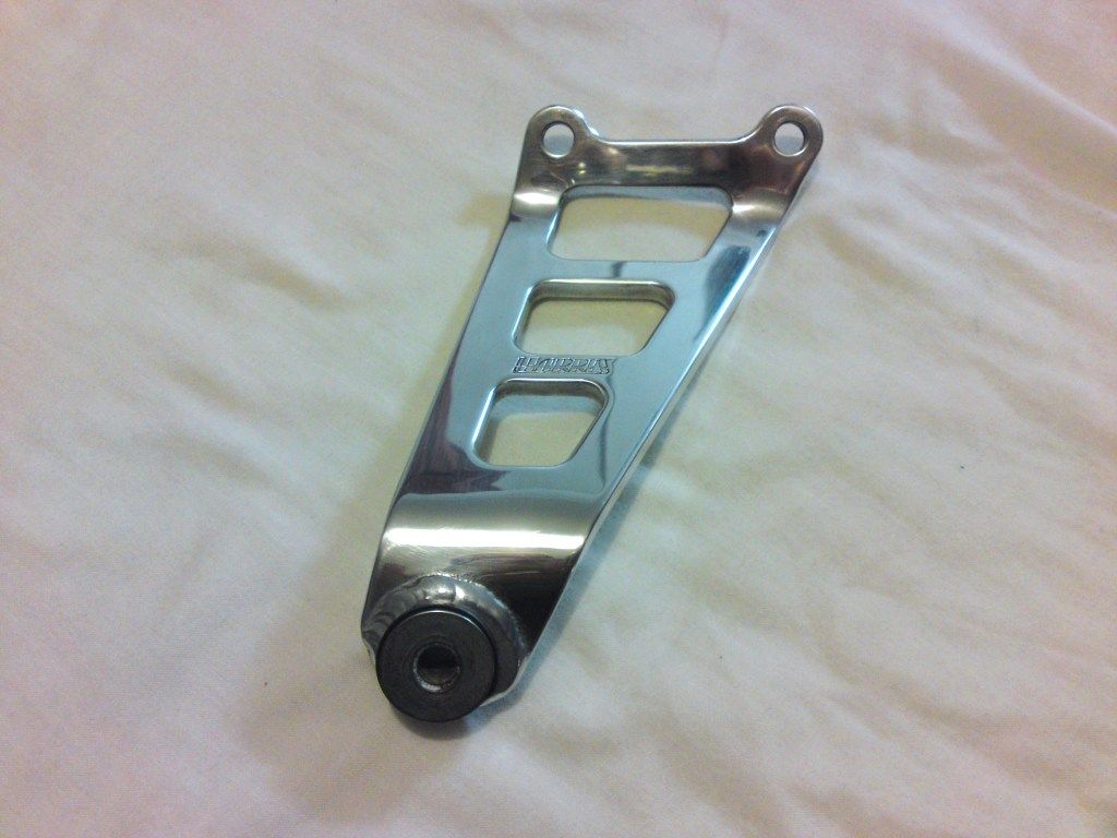

I got hold of a Harris exhaust hanger bracket, Needs a bit of a polish, Looking at the Harris site it looks like they dont make them for the ZXR 750 / ZX7 anymore?
http://i1250.photobucket.com/albums/...psb31f80d2.jpg
Coil set & leads on the way, I will get the Dyna crank trigger & 2000 ignition module kit next year, Should run much better anyway replacing the near 20 year old leads & coils
DC1-2

DW-800
http://i1250.photobucket.com/albums/...psc84a8928.jpg

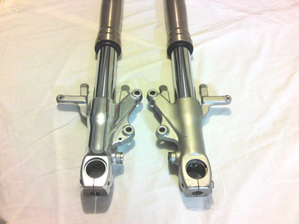

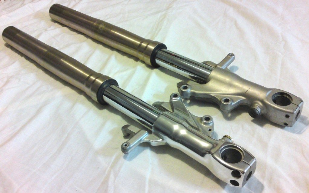

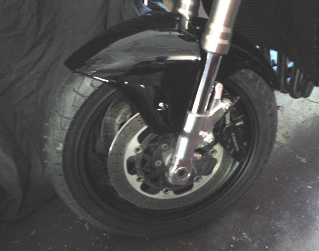

Finally got my forks after a month? OH well I expected the mail (from the USA) to slow down but not almost stop
I got time to get one side sanded back "shiny" (using 240, 400 then 800 paper) & ready to be hit on the polishing wheel
http://i1250.photobucket.com/albums/...ps1edd5c7b.jpg
http://i1250.photobucket.com/albums/...psb7bcbccd.jpg
http://i1250.photobucket.com/albums/...psa195bdb0.jpg

On the 30th of this month I will have had the bike for 4 months so its all going faster than I expected it to
Between a lack of dollars due to less work & a lack of time due to too much work its getting there
I will hopefully get the other fork leg shiny today & get it rolling again
the bottom of the fork looks great, good work
Thanks Pete
I got the other fork done this arvo, It does not take long to get them shiny with sandpaper, I will get them polished later some time ;)
The front wheel is almost as shiny now too but considering you cant really see much of the wheels (especially at the front) + it is near impossible to maintain the shine behind the front discs I might have the wheels painted or powdercoated? black or green?
after doing my alloy for NFR this yr by hand aswell ,ya done good mate!!
now dig deep and get other side done buddy.
Other side is done & the forks are on, Fugg it, The wheels are going to be satin black, Should be a nice contrast between the polished aluminium, gloss black tank, tail & front guard & some Kawasaki lime green here & there

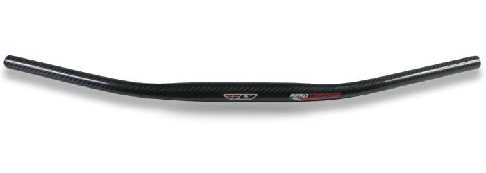

Finally got the bars I wanted on the way, The FLY tapered SX bend bars I have are OK, Just a little bit too straight (10 degree) & the gunmetal grey does not suit the bike so I will get rid of them or maybe keep them for a dirt bike
Sno X Mountain Bend (20 degree)
http://i1250.photobucket.com/albums/...psf7b3e3ba.png

Frontend looking much better with ZX7 forks, calipers & guard
http://i1250.photobucket.com/albums/...ps07e2aa1b.jpg
I received the DYNA coils & leads today & just fitted them this arvo, It starts much easier (It started pretty easy before but now its even better & I still dont have a choke cable fitted) & it picked the idle up nearly a few hundred RPM, I had to drop the idle back down, I had a feeling the near 20 year old coils & leads were buggered
I think the DYNA crank trigger & ignition module will make it run even better again
