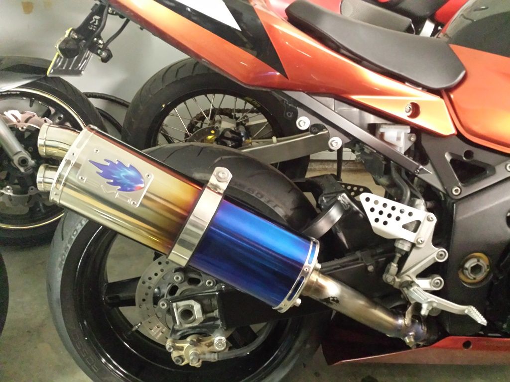

I have to make a new exhaust hanger bracket anyway so I'll tackle it when I do that. How's this for handy, I was digging around the shed last night and opened my locker looking for an unrelated part and found my Blueflame duel outlet exhaust I had on the Bandit years ago. Boom 4 bolt mount up.. sweet free exhaust..

On a side note, see the black smudgy bit on the mid pipe? it was a melted rubber type stuff I'm slowly getting it off with some scotch brite, soapy water and elbow grease but its making the titanium go silver..
I know nothing about titanium so my question is when I remove the black stuff and its all silver if I stick the oxy down the mid pipe will the heat make it colour back up??
Kind of a silly question now I think about it.. Cheers Trav.

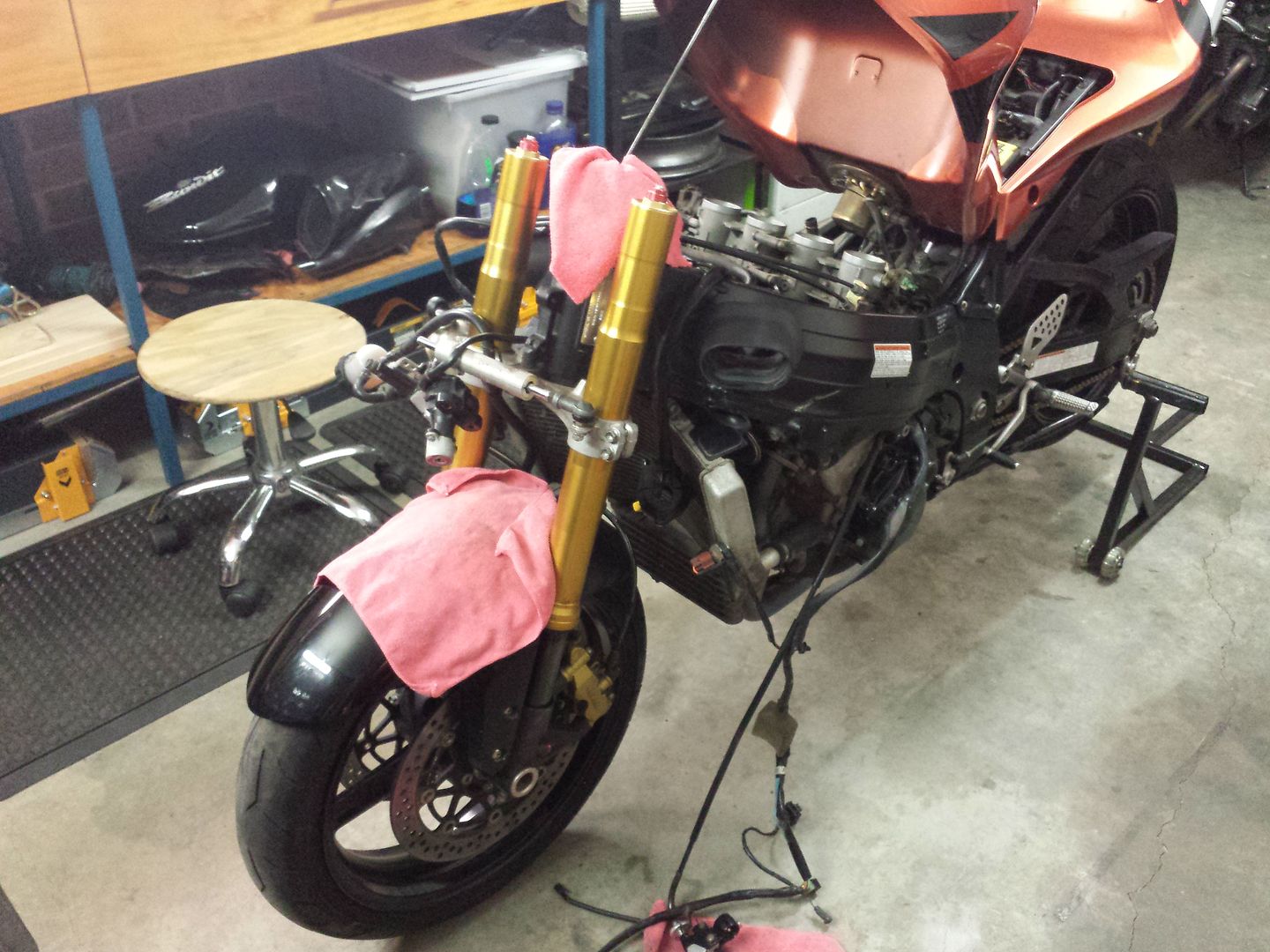

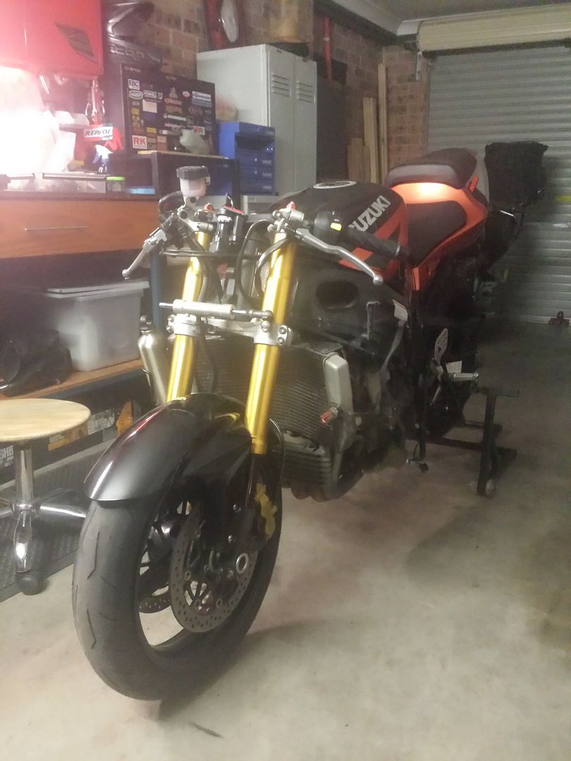

Play time has begun.... there's not much on the front end when all the tupperware is gone, even minimal wiring, I dig this..

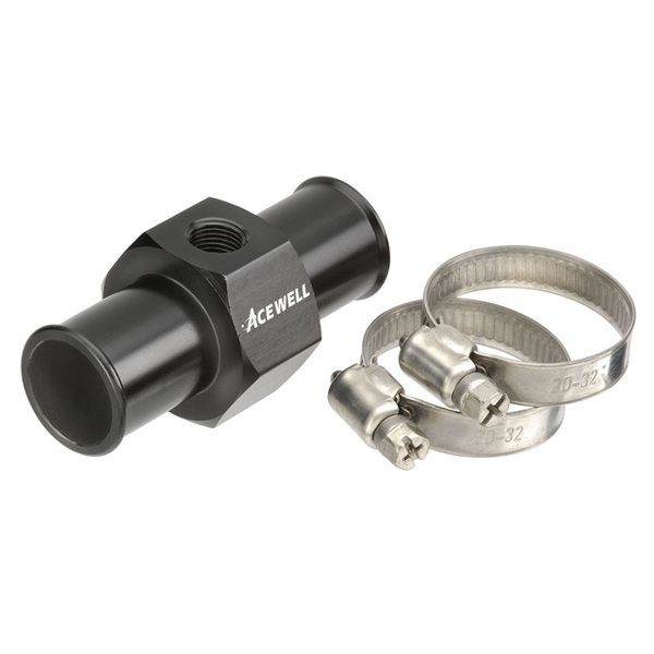

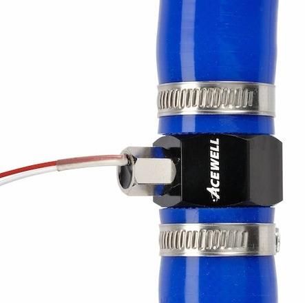

The rad temp sensor is a little pokey out the front, so good ol Acewell make an inline temp sensor that I can mount behind the radiator so it's a bit more out of the way.

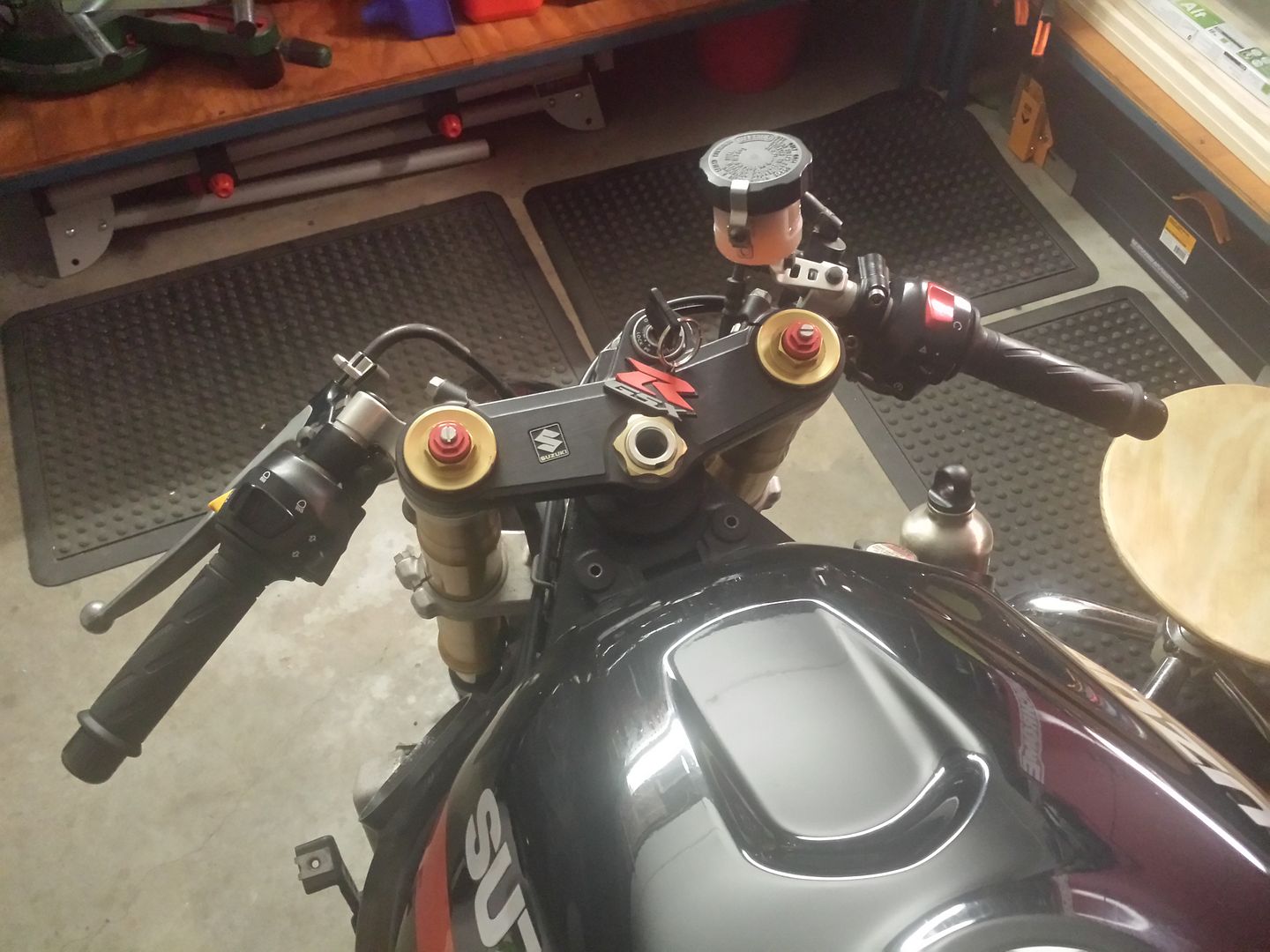

I took the top clamp of today to reroute the switchgear wiring and throttle cables etc..
http://i1359.photobucket.com/albums/...ps5aflvoye.jpg

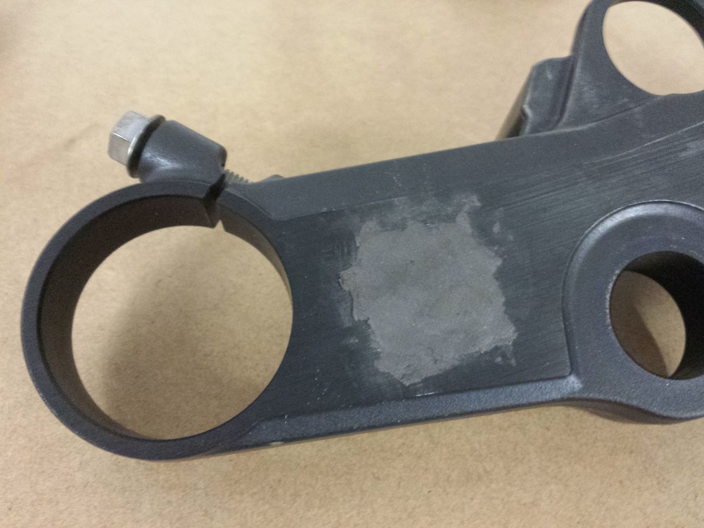

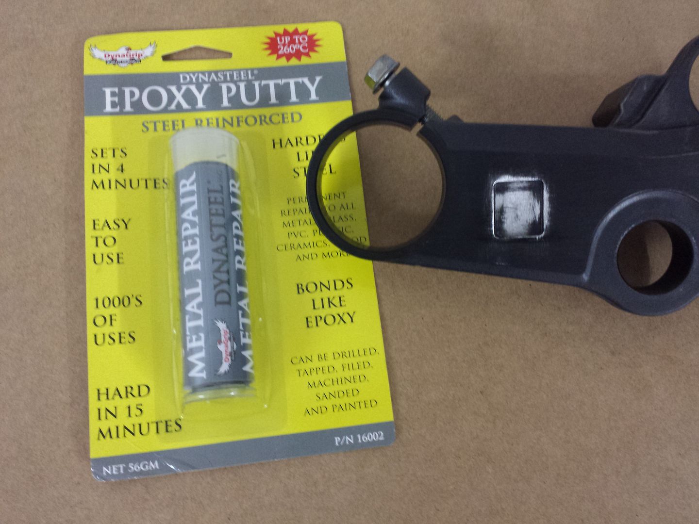

I'm cheaping out and just drilling the original yoke but I'm pretty sure one of my holes will end up smack bang on the S logo which is inset I f I remember Jules' job.. so I had some of this liquid steel stuff in my tool box and thought I'd give it a go apparently good to grind/drill/etc. We'll see shall we.. so I roughed it up and packed it in..
http://i1359.photobucket.com/albums/...ps7abs4pb5.jpg
http://i1359.photobucket.com/albums/...pstfi95nhw.jpg
why didn't you just weld it you mug... you're a boily for a reason :P
but the epoxy putty gets him hard in 15 minutes...
But then it would have sat in my toolbox for another ten years Trav and I just couldn't have that lol.
hahaha. i know that feeling

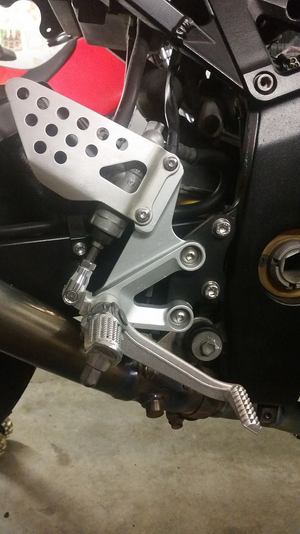

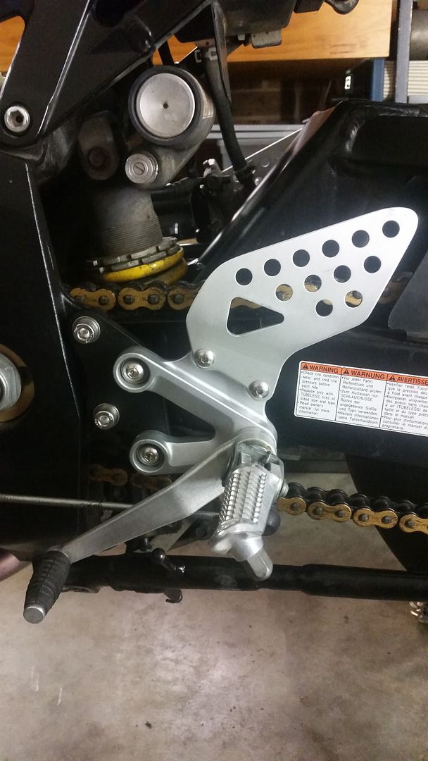

Also pulled off the rearsets tidied them right up and refitted with the lowering plates, came up a treat and should give me a little more leg room. Fitted a new brake clevis too from vandriver left over one from the TL collection.

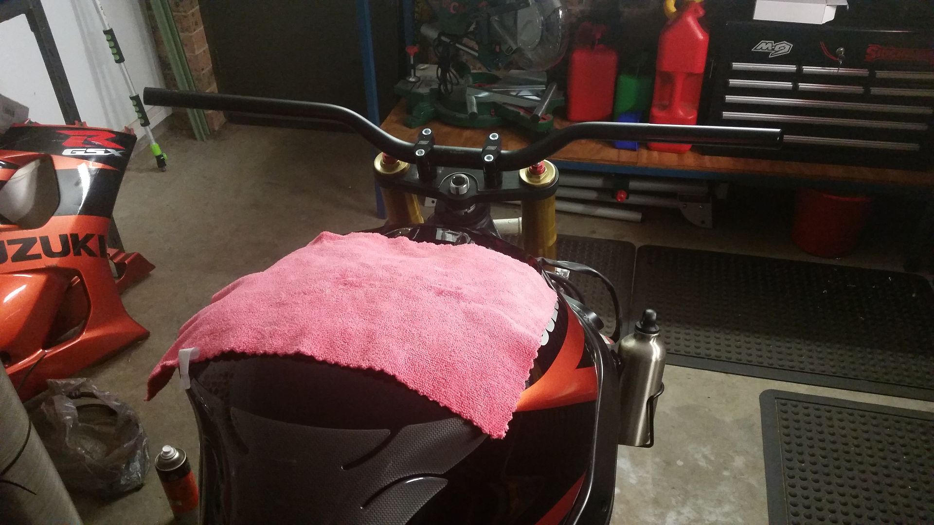

Risers came in the post today, drilled them bad boys and now we have some funbars..
