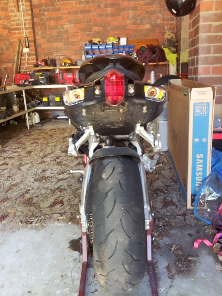

It seems to be sitting ok here ?
not bolted down just sitting up on the bolts. when it sits OK at the top its out on the bottom

Not upside down checked it hundred times. Looks like the wrong light maybe
when i had it it fitted closer than that, but i think it was through holes that didn't look like they were the factory ones. i'll see if i can find a pic of how it fitted on mine.
I know the holes you mean someone has drilled them in it gunna order a new light and see how that works for me. 07 tail I think
Yeah as far as I'm aware it's an 07 tuono tail.
A bit of interweb stalking and found that its a common problem for dickheads like myself gen one light in gen 2 tail so i ordered a gen 2 light set
You're not the dickhead. The person who owned it and ran it head on into something is the dickhead, we both just inherited the problem.
GEN1 have, 01 - 05 have two round tail lights

So it's a 04-05 RSV tail light and a 06+ tail ?
Sound good Stu just going on what I found today either way it should be fixed in 5 - 10 days depending on frieght
yeah i think that's it stu. the early 2nd gen RSVR had a slightly different (though they look very similar) tail and light.
the new tail looks shit loads better. can't wait to see it all painted in yella
