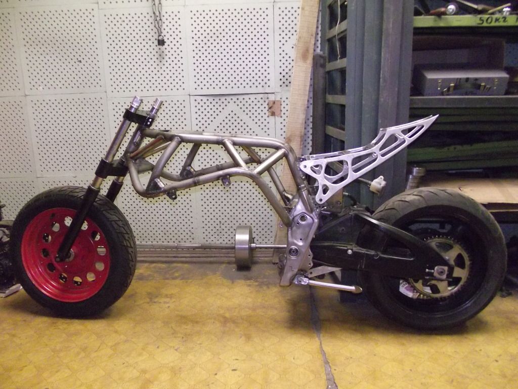

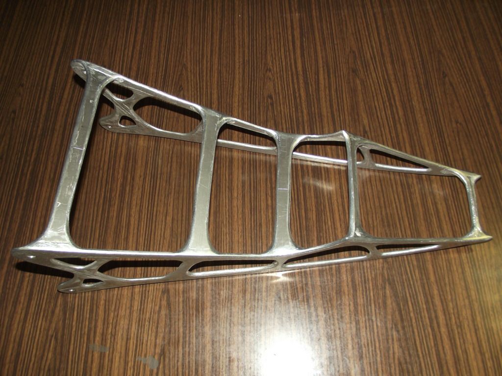

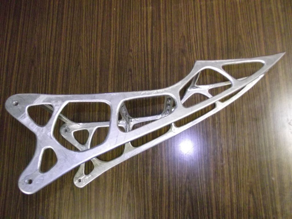

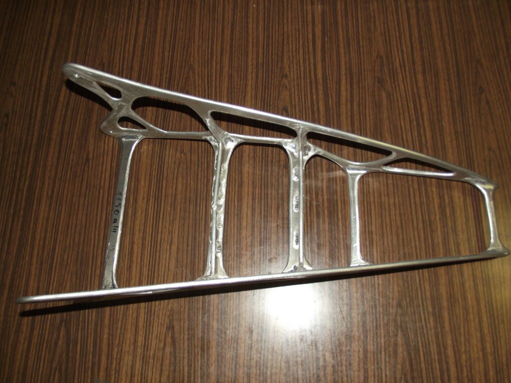

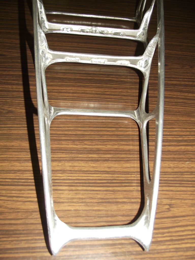

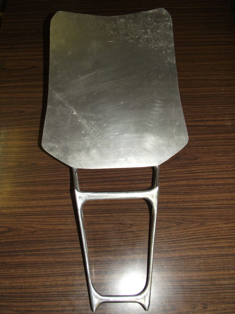

thanks rod, hopefully it is, at least thats wat i wanted to make, gunna be a single seater tho, i hate to maime it with passangers foot rests
http://i1175.photobucket.com/albums/...r/DSCF4619.jpg
http://i1175.photobucket.com/albums/...r/DSCF4623.jpg
http://i1175.photobucket.com/albums/...r/DSCF4624.jpg
http://i1175.photobucket.com/albums/...r/DSCF4626.jpg
http://i1175.photobucket.com/albums/...r/DSCF4628.jpg
ps btw the subbie weighs in just 1.1kg!!!

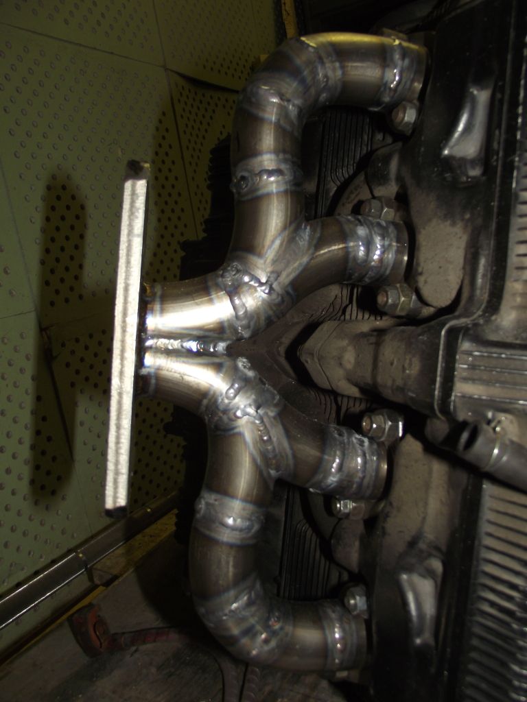

anyway, long long time to have the header made so there we go

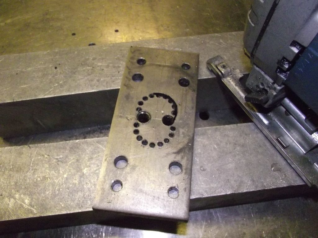

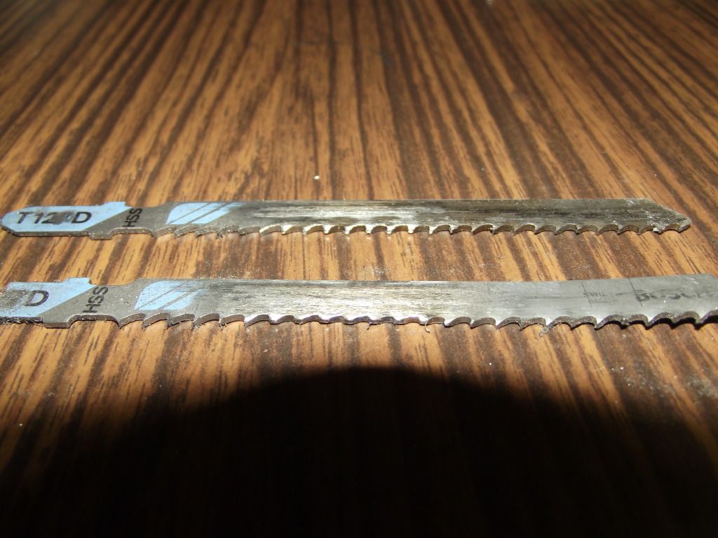

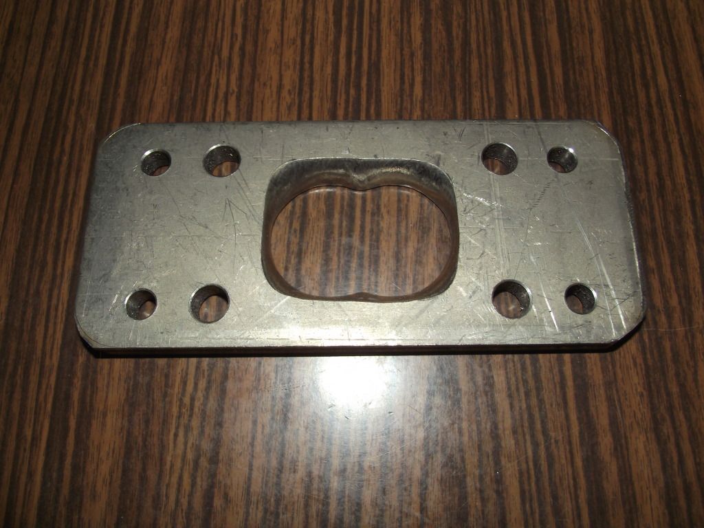

10mm thick titanium sheet for the flange... you should see wat happens to the jigsaw blades when sawing 10mm titanium haha! i'll shoot it on monday
http://i1175.photobucket.com/albums/...r/DSCF4568.jpg
4hs later
http://i1175.photobucket.com/albums/...r/DSCF4570.jpg
A thin hand pwered metal saw (junior hacksaw or coping saw) is much better for cutting Ti mate jigsaw has to high a blade speed for Ti as soon as it gets hot it eats the blade.
Loving this build Surt. Hope the head heals mate, wanna see u finish this beast and give that asphalt a bit of payback
yeh gunna burn it to the ground, thanks angel of death just gimme some time!
Adam i tryed cuttin tutanium with a hand saw, no go! and as for my jig saw i used low revs and cooling in water, it cut alright first then the teeth got rounded but i was a one smart fucker i laid 20mm and 40mm thick spacers under the jigsaw to use all sections of the blade not just the upper 1

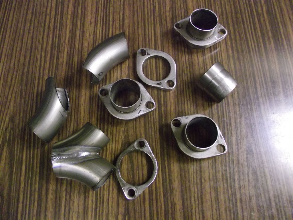

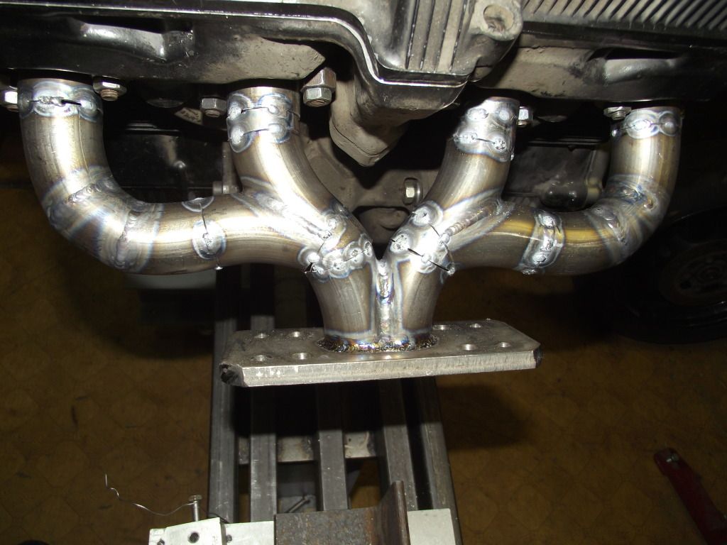

cbr954 titanium headers cut, ends were machined and flanges were re drilled and re shaped, making merge collectors now

wats happenin' to jig saw blades meetin' titanium

Looking good mate , Not as hard to weld as I was told. Are you using extra bits of pipe for fill rod or do you have access to Ti welding wire ?
the 2nd option mate

the headers welded around but it needs an appendix for the wg

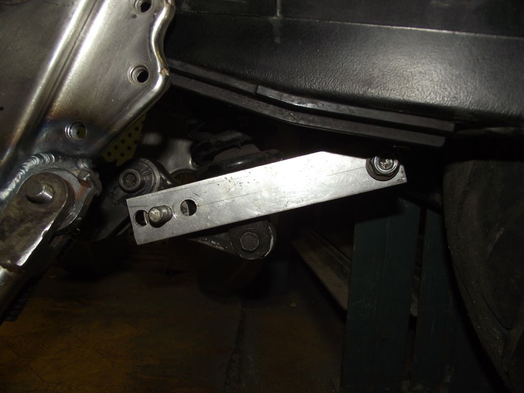

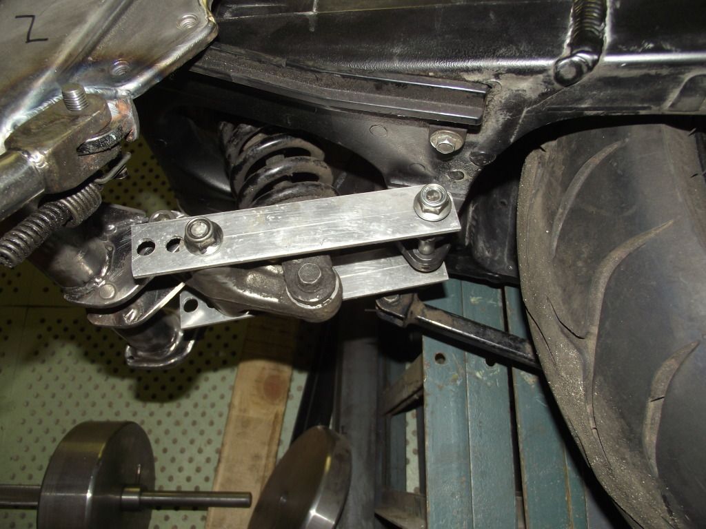

made mockup dog bones with 3 center to center distances but i gunna make threaded ones later

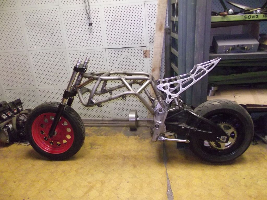

also used a front end to make a mockup roller from the Ozzlem project but justed the legs length to gixxers usd forks i use for Hades
140mm center to center
http://i1175.photobucket.com/albums/...r/bones140.jpg
http://i1175.photobucket.com/albums/.../roller140.jpg
158mm center to center
and 50mm lower in the middle and without droppin the front end
http://i1175.photobucket.com/albums/...r/bones158.jpg
http://i1175.photobucket.com/albums/.../roller158.jpg
