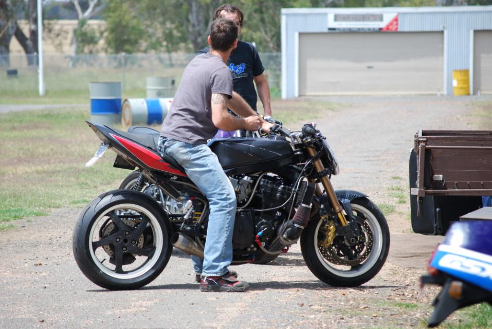

I blew the gear box again and almost went under a bus because of it, that was exciting.
When i rebuilt it the first time i missed the wear on the shift drum and it was jumping out of 2nd.
Oldskool worded me up as to the problem and i got some new parts in the mail.
Deano helped out with a couple of gears too, so with a week to go until the drags she looked like this.
http://i1226.photobucket.com/albums/...9/P1000763.jpg

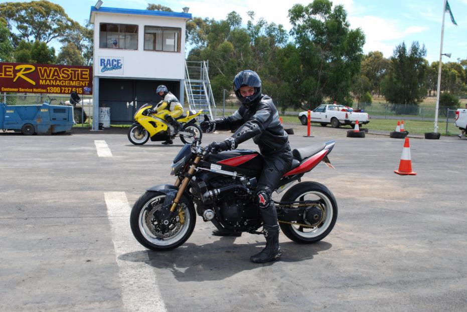

I got it back together and running and did a AFR check on the dyno, all good so a drag racing we shall go:D
That shit is so much fun, best was 11.35 @ 120mph.
I need to harden up abit of the line, but with a few people asking if my gear box would make it i was a bit soft. Fuck you TK.
