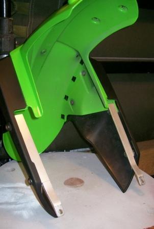

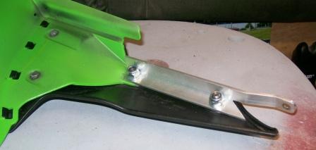

  5. Hueyonablades front fender conversion
    This is a great little conversion shown to me by Dave MC (Hueyonablade)
    This is a fantasticly simple conversion to change your front fender to a Kawasaki 600 jobby
    As you can see, the mounting brackets are made from 2cm ally angle, and really simple to fabricate
    If you look back at photo 1 you'll see a couple of lugs that you ...
