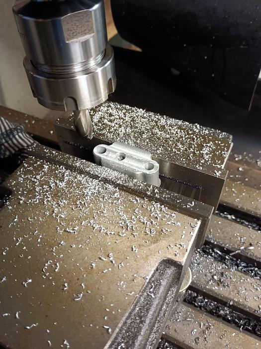

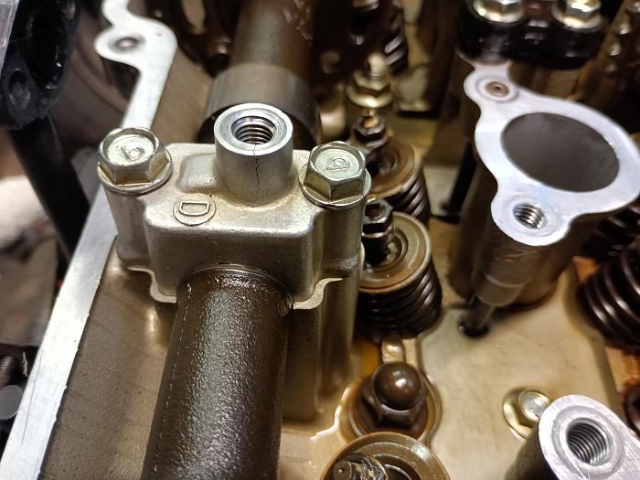

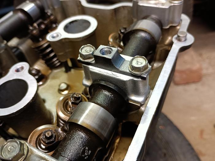

Stripped 3 threads on the cam journals so the oil got out of the rocker cover . Boo went home and cried myself to sleep with Jen stroking my hair.
Next day I had a plan, made some bridges and fix that problem.

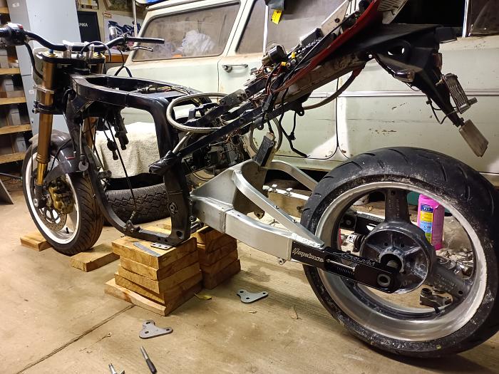

Next issue, SSSA is too short.
No problem anymore.
96 SRAD swingarm
Because RAD and cheap ..
