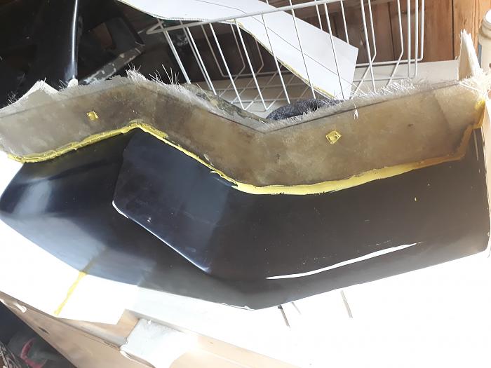

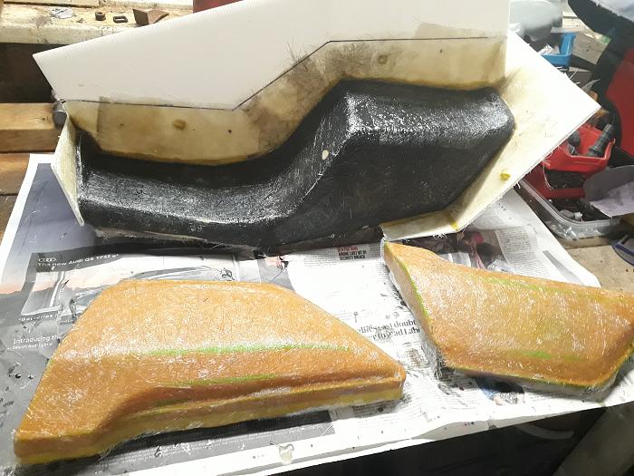

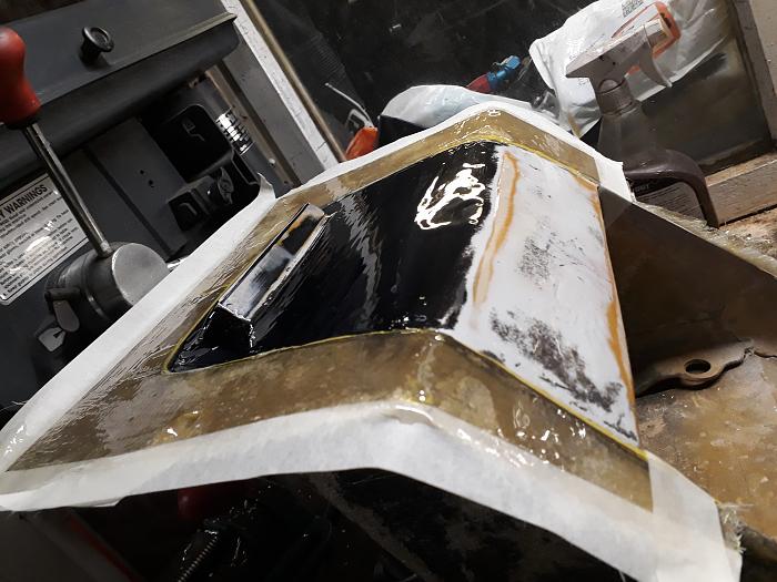

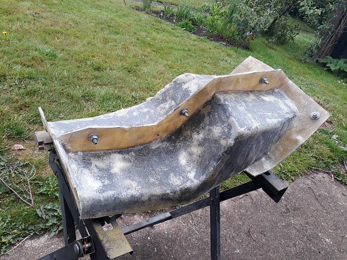

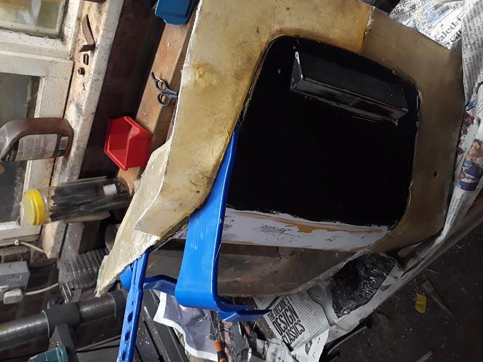

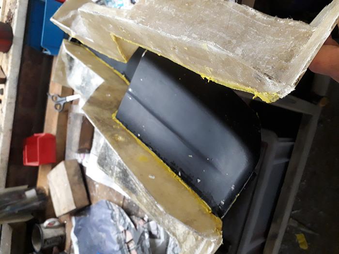

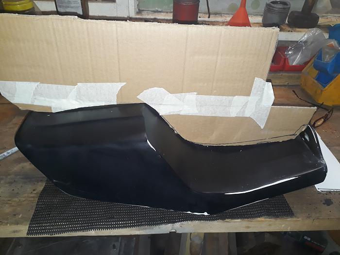

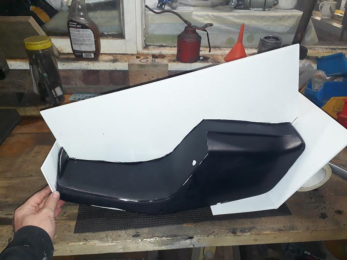

    As it stands, I've got a set of sidepanels from a Z1100 (I think, might be the Eddie Lawson rep), and a modifed tail unit that was created from an ELR tail piece, a sheet of steel and a shit load of fibreglass and body filler, and it weighs a LOT. It was only mocked up to get the short & stubby tail unit that I wanted, and I had originally intended for a blag to get it copied in fibreglass (at that point it was a mag project, and blagging was on the cards).
    As it is now, I'm going to have a go at making some moulds and replicating the tail unit and sidepanels myself. I could fit the sidepanels as they are, but would like to have some of the ides extended to meet the frame rails, and I want them fastened with proper fasteners, and not the standard 'pop in and hope' nipples and rubbers...
ID:	8542Click image for larger version.
ID:	8543Click image for larger version.
ID:	8544Click image for larger version.

    Will start with one of the sidepanels and see how it goes - the tail unit it going to need a three piece mould, so will be a proper headfuck. Start simple...
    I've given the panels a treat with several grades of wet and dry, now it's on to the polishing.
