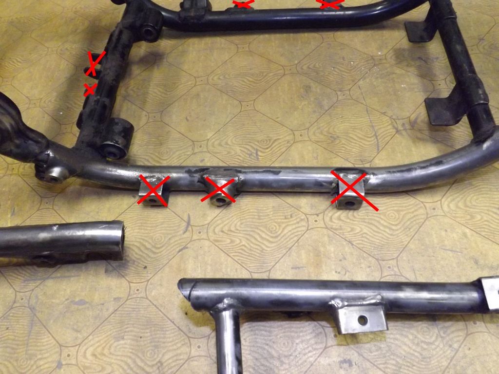

    started to cut off numerous mounts

    so much crap to cut off

    made the seat rails
