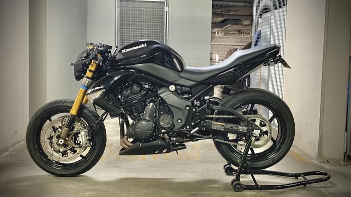

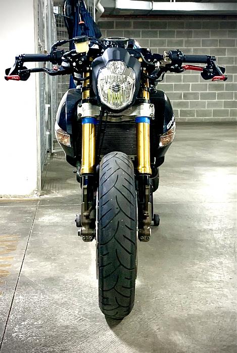

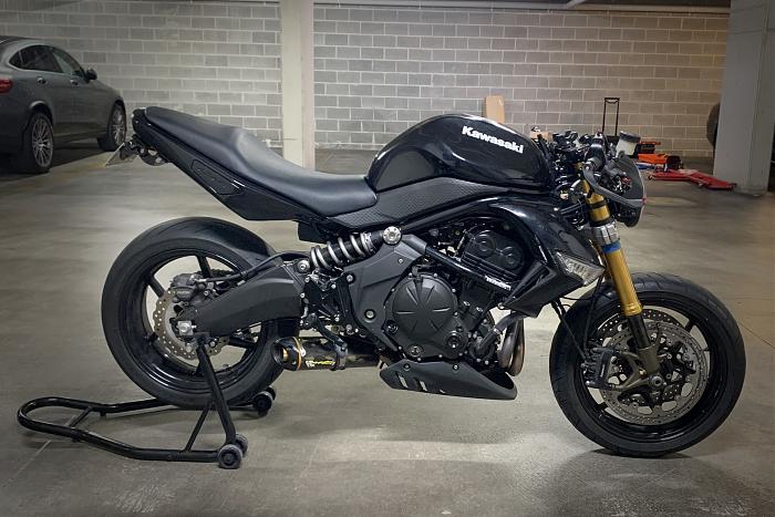

    Hi folks, I thought id share my nugget with you all
    2010 er6
ID:	8497Click image for larger version.
ID:	8496Click image for larger version.
    • 2004/5 Zx10r forks,
      2008 top and bottom triple
      2015 Versys 650 swing arm
      2012 Yamaha R1 rear shock(custom spring and valving)
      Matris steering damper
      Wheels
      Custom 6 inch rear wheel with 180 section rear tyre
      Engine
      Two Brothers exhaust
      Pair valve mod
      MAP sensor mod
      Brakes
      Front
      2016 z1000ABS callipers
      15mm spacers
      330mm Brembo discs
      2017 z1000r 19mm Master cylinder
      Rear
      2015 Versys 650 ABS 250mm rear disc
      2015 Versys 650 ABS rear caliper and bracket
      Ergonomics
      RSV racing rearsets
      Bling
      Billet oil caps
      MT03 headlight with LED bulb
      LED Tail lights
      R&G tail tidy
      Bar end mirrors
      Billet lever protectors

    6” custom rim ?
    I am very proud of my race....the fucking human race...........
    Quote Originally Posted by ozzy1100 View Post
    Very nice 
    6” custom rim ?
    Yeah, you can use a Zx6r rim but they’re 5.5 inch and you still need to machine bits to make it fit. I sourced this fron Indonesia no less. Its specifically cast to fit on an er650. I spose maybe not custom. Dont know how else to describe it.

    Quote Originally Posted by Auser6guy View Post
    Cool, in drag racing they used to cut and weld in sections to make them wider lol
    Great solution, I didn’t even know they existed
