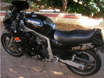

    It will be a 7/11 with the base being an 87 GSXR750, my question is which gsxr1100 or bandit motors will work for this build?

    This is the bike now,

    89 to 92 oil cooled 1127 motors will fit the 92 motor has shim adjustment on valves opossed to tappet in earlier motors

    Thanks geesexar any idea on bandit motors fitting?
    I am guessing by your comment that the 92 is a better option re the valve adjustment?

    I like the one out of the "powerscreen" GSX1100F tourer.
    Plenty of grunt, would go well in a little 750.

    All oil cooled 1100 and all oil cooled bandit will fit

    Yep, Deano's on to it. The slabby frames were taller weren't they Deano? So no tight fit like the slingshot 750?
