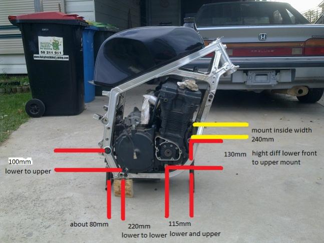

    What measurements on the GSXR400 do you want bloke ? I have a frame with a RF600 motor sitting in it atm (RF600 bottom end is just a oil cooled gsx1100 motor cases modded) and slightly larger than the gsxr400 motor but not by alot as far as the cases are concerned.
    I don't have the motor anymore (but can take measurments off the frame for you) , It went to yoda but I belive he sold it on to someone else.

    Pretty much the usual stuff mate ie width of rear mounts distance from rear to front mounts, height of upper monuts in relation to lower mounts etc etc.

    Ruff measurements Click image for larger version
Name:	ruff measurements.jpg

    Thanks heaps Red !!! thats a decent starting point now to measure up the little 250.....
