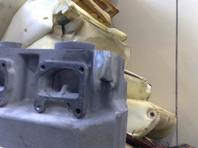

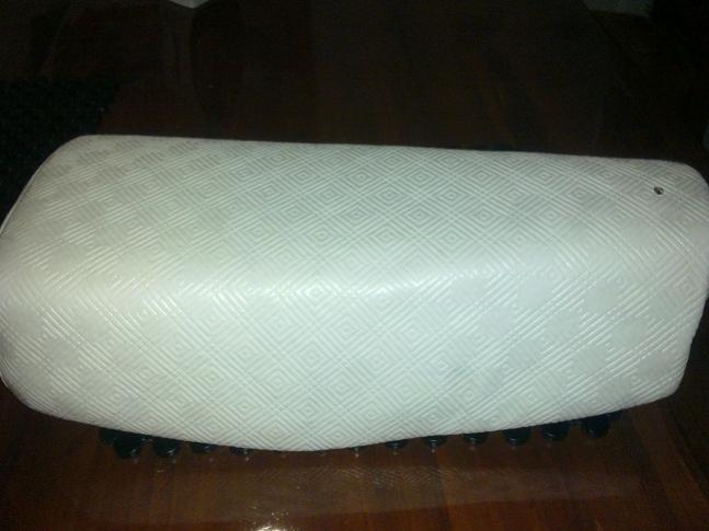

    Did the seat in some table protector foam to see how it would come out.

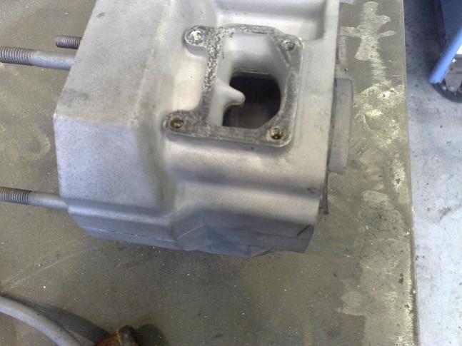

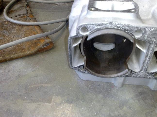

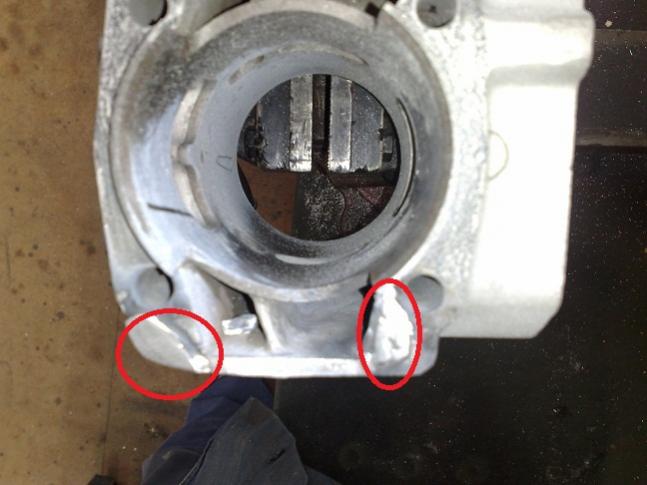

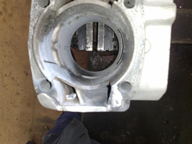

    Did a bit of poking about at work today with the welder
    Before welding.
ID:	2128Click image for larger version
    After , sorry the photos are crap got a new phone and the camera is worse than my old one, doesnt seem to focus correctly.
    As you can see in the third photo I've added some weld to the outside of the barrels to stop the crankcase being open the the air when I rotate the barrel 180 deg . I've also filled the start of the transfer port on the opposite side, a little work with the die grinder will smooth things out a little later (prob on the weekend)

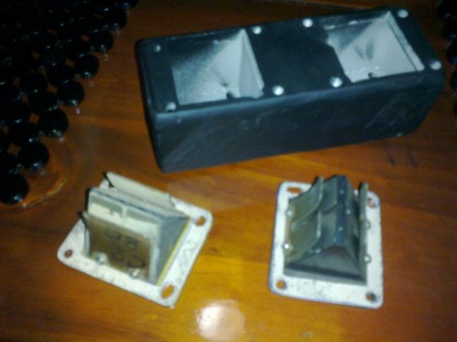

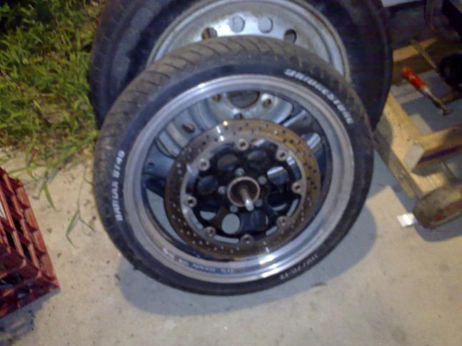

    Picked up a front wheel today along with some reed valves , will make a reed box/adapter to bolt them up to the motor.

    Also picked up some extra reed valves for the pulse jet today and found one of those wide rear tyred dragster pushbikes, might get it finished before the drags with luck.
    Thinking carbs are far to easy for this beast , might have a bash at an electronic version of mechanical injection. Sort of pore mans electronic fuel injection and run Meth instead of petrol based fuel atm. That way I can run two maps one for meth and another for petrol , so I could run meth to race then once the day is over switch fuel tanks and run petrol though the motor to clean out meth at the end of the day, or to just to putt putt about.

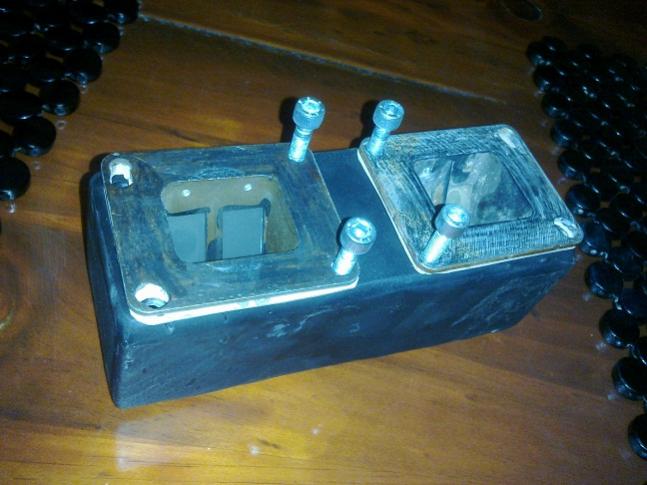

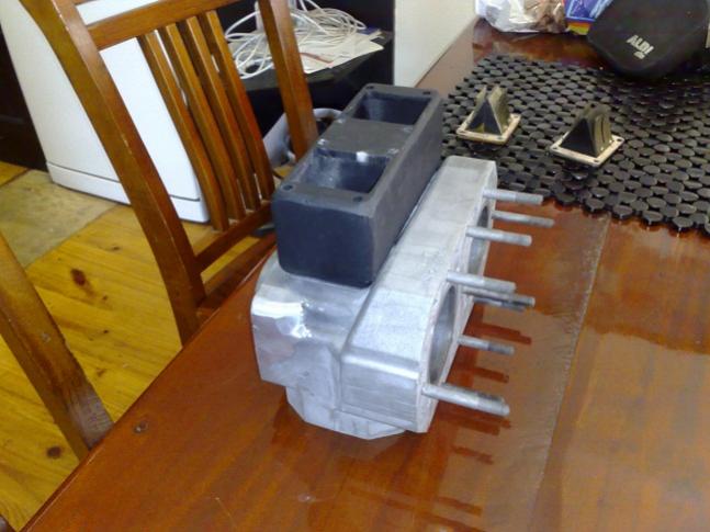

    Fucked about at work today (for 6 hours) and a reed box emerged at the end of it, funny how such a little box took so long to make.
ID:	2139Click image for larger version
    Still got to fill it with resin and "match port" it. Now on the hunt for a pair of tb's around 40mm .
    Fuck that second photo is blurry . New phone is crap went back to the old one, seems the old one doesnt work to well when you've had half a bottle of turkey lol

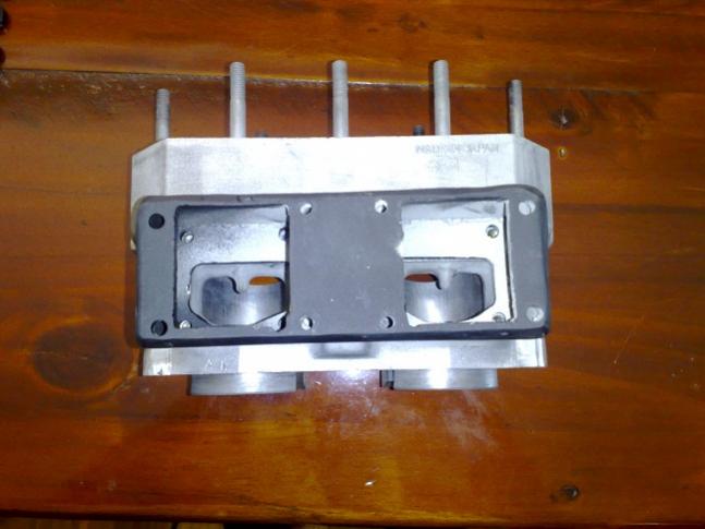

    Took a few more photos of the reed box on the barrels today
ID:	2144Click image for larger version

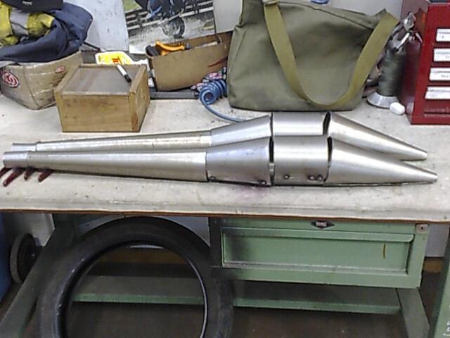

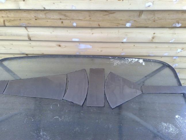

    Misses has given me the weekend to play in the shed so might get a bit done to the pig , seamless tube came in today ($160 for 6m talk about ripped off lol).

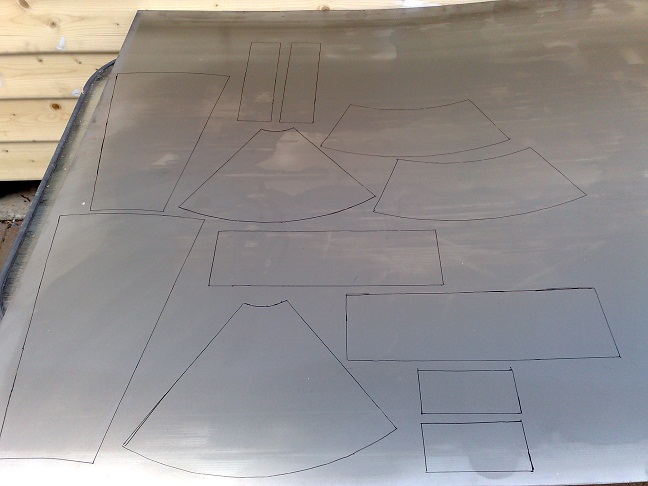

    Designed the tuned pipes with consultation from 2 stroke guru, and then puter spat out the specs, even printed the pattern so everything was mm perfect, then used a black marker to set out, followed by chopping the crap outa all that smart stuff with a 5 inch grinder.
ID:	2146Click image for larger version

    Rolled the pipes today , had to do most of it by hand n hammer as the roller at work doesnt go tighter than about 70mm. Tacked a few big bits with the mig but the whole kaboodle will have to be tig welded at home 0.8 mm is no fun with 1.2 mm wire and a big mig. Had to roll the end pipes by hand as there about 20mm dia by 300 mm long.

    Its amazing what you can do with a vice long bit of 18mm bar and a ball peen hammer mate.

    Photo makes em look prittyer than they are mate , but once I tig the sucker up I'll give then a tweek. Prob weld up the ends and fill them with oil pump then a little with a porta power (with luck I wont blow the fuckers at the seams)
