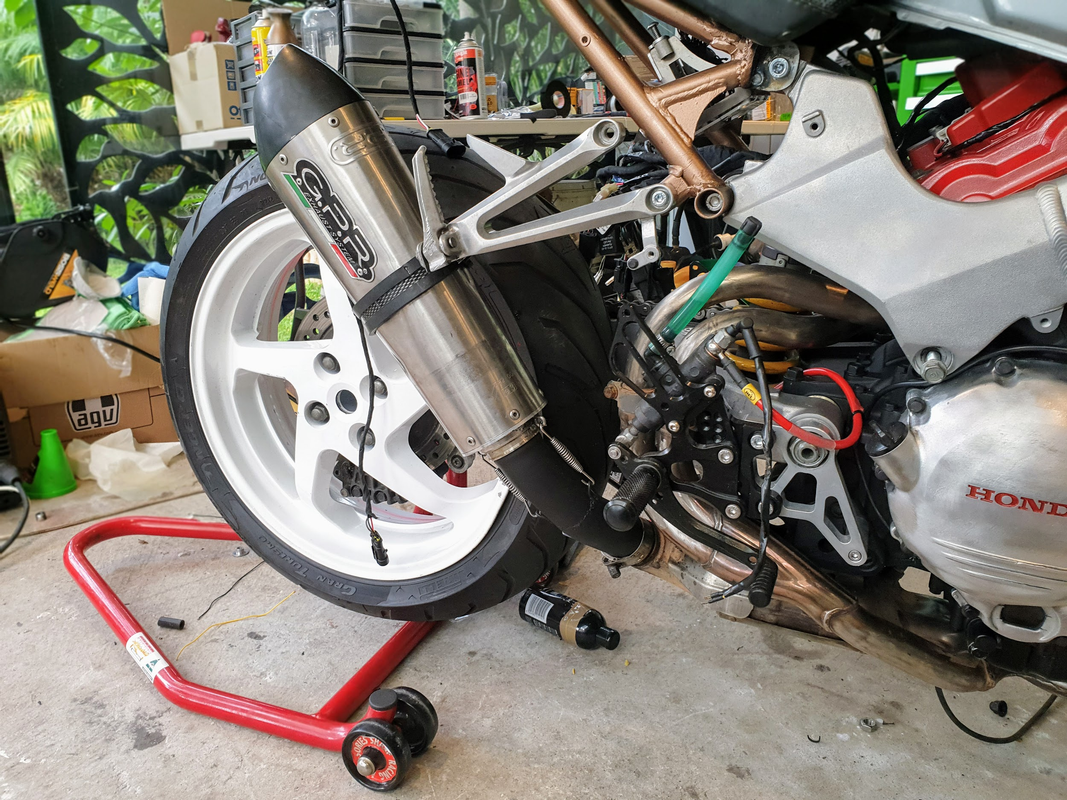

Shortened the mid pipe and cut a thread into the pillion peg to secure the muffler onto

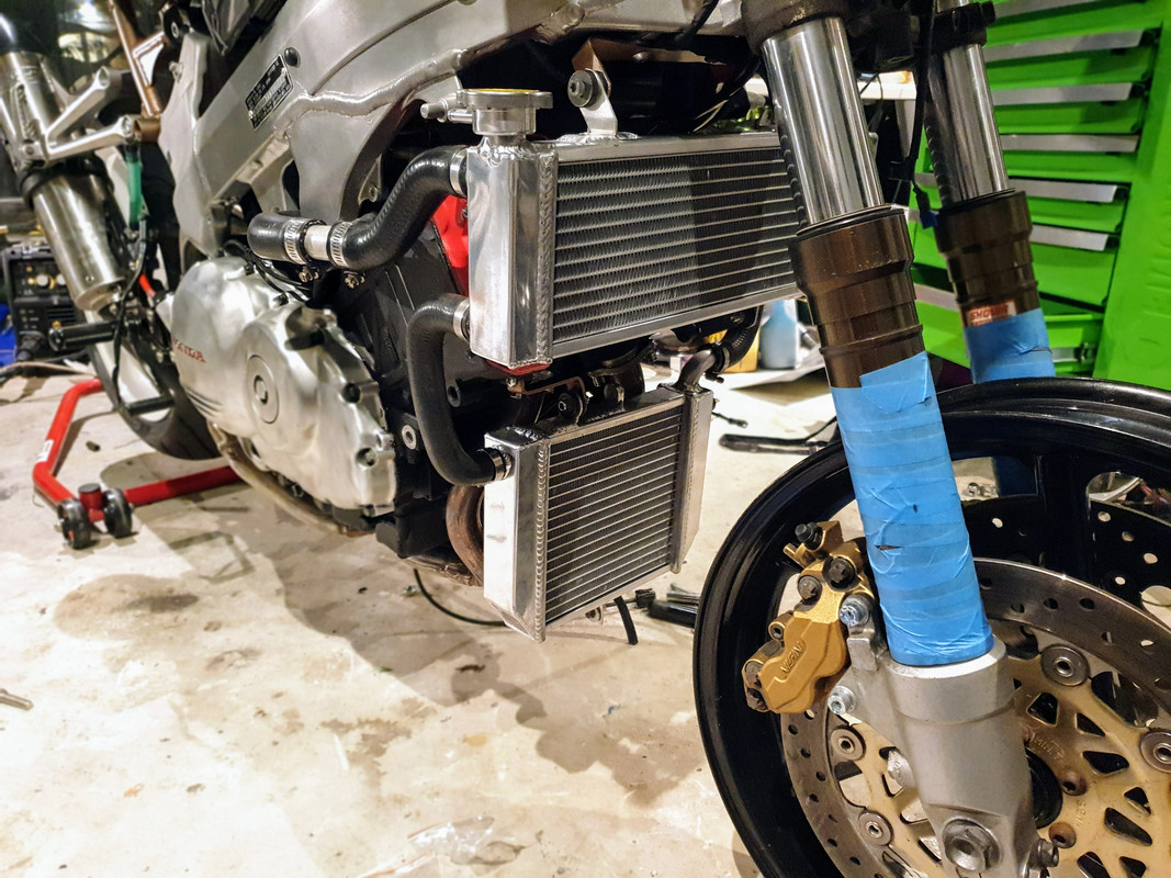

New radiators on and looking shiny :)
https://i.postimg.cc/CKSp9kr1/20190527-193408.jpg
Still on a roll mate. Good stuff.

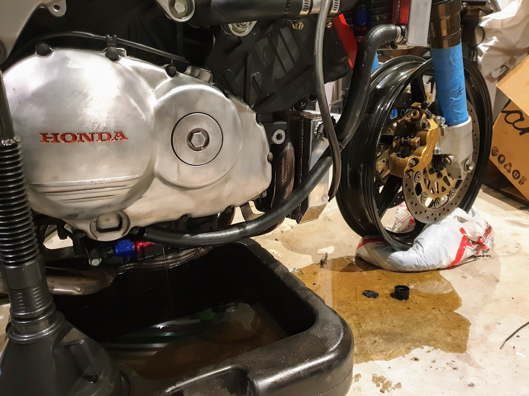

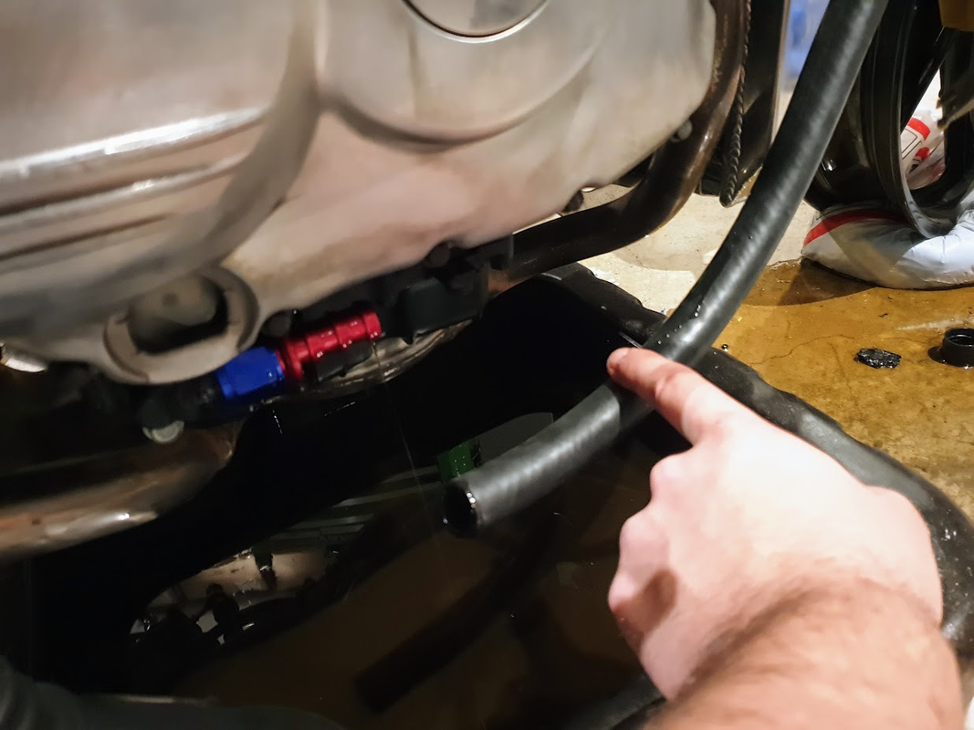

Well that's what I get for buying cheap Chinese fittings, they blew off immediately under pressure.
https://i.postimg.cc/pLH1XdJC/image.png
https://i.postimg.cc/Mpm3c8sS/image.png
Unsurprisingly the genuine Pro Flow was leak free
https://i.postimg.cc/QMN41nPW/image.png
Hopefully some genuine fittings will sort it out.
Age old story mate!
I don't think I'd be using pushlok type fittings on an oil cooler.

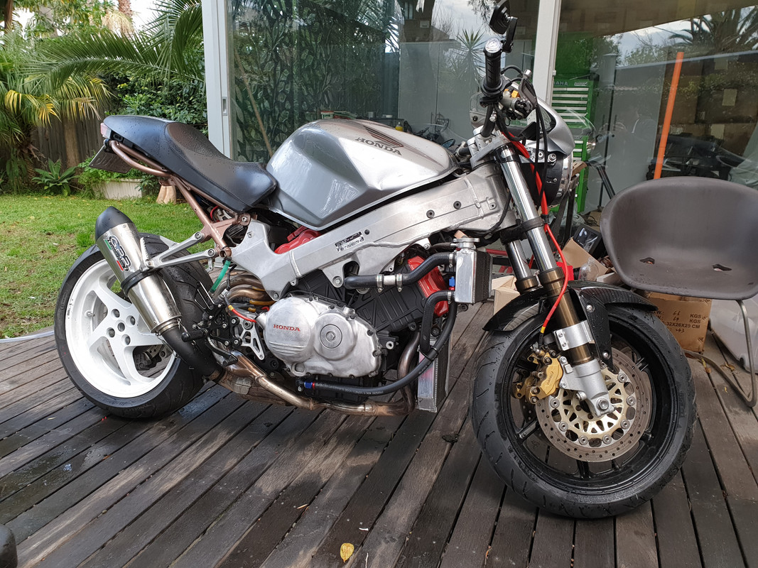

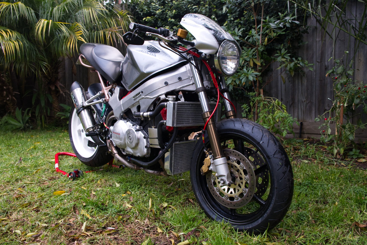

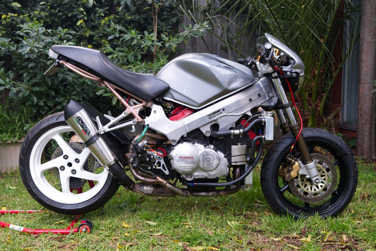

Been a bit slack on updates but here comes a biggie, the bike is running, rideable and registered so I dusted off the good camera for some shots :D
https://i.postimg.cc/rsRDSyWC/1.jpg
https://i.postimg.cc/mZPjdQyV/2.jpg
https://i.postimg.cc/hjjzt1tY/3.jpg
As with any project it will never be truly finished but for now I'm content to just enjoy riding it until I work up the motivation to tear it down for paint :)
I reckon I'd just strip and clear coat the tank and call it done...
Looks nice mate,

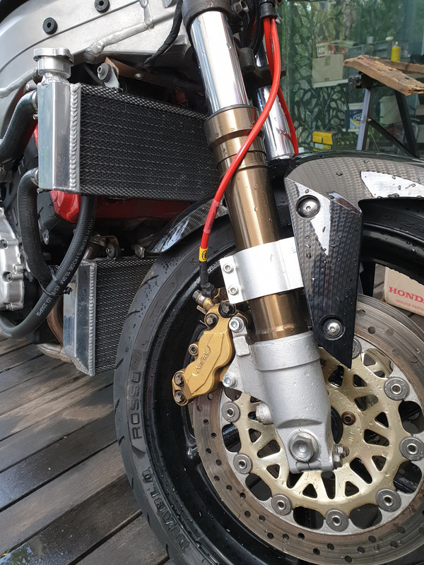

Found a brand new OEM CBR650 carbon fibre style fender for $40 so I set about finding a way to mount it as the CBR900 forks have no fender mounts (they use a clamp system with the standard fender).
Found a solution with a set of 54mm clamps intended to mount lights on a bull bar. Bolted vertical brackets to it and voila :D
https://i.postimg.cc/TPcY9DYD/20190807-163604.jpg
https://i.postimg.cc/NMJGhvXG/20190807-163618.jpg

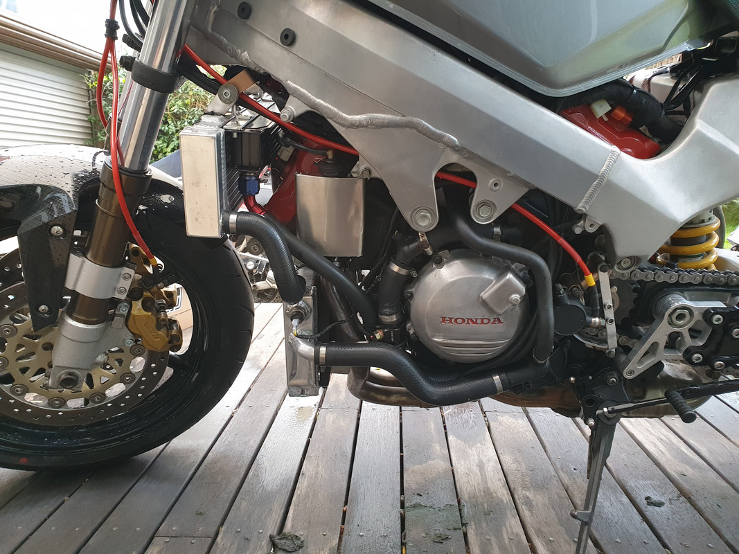

I also added some shielding to the radiators
https://i.postimg.cc/k4XMhgBh/20190807-163627.jpg
And made a quick and dirty bracket to mount the overflow flask on the left side of the bike. Also added a spare overflow cap from my R1 for the OEM look :P
https://i.postimg.cc/T13ymcV1/20190807-164011.jpg
Nice one mate.
Those clamps are a neat idea for the guard. Good job

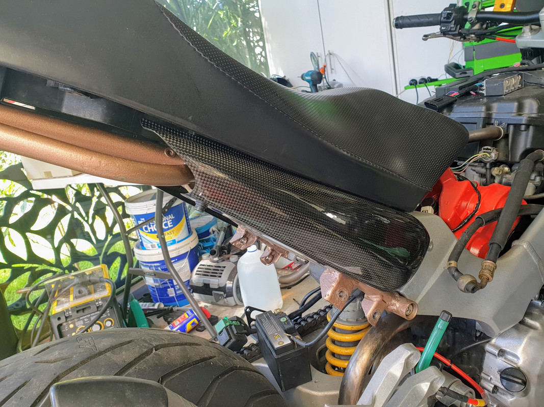

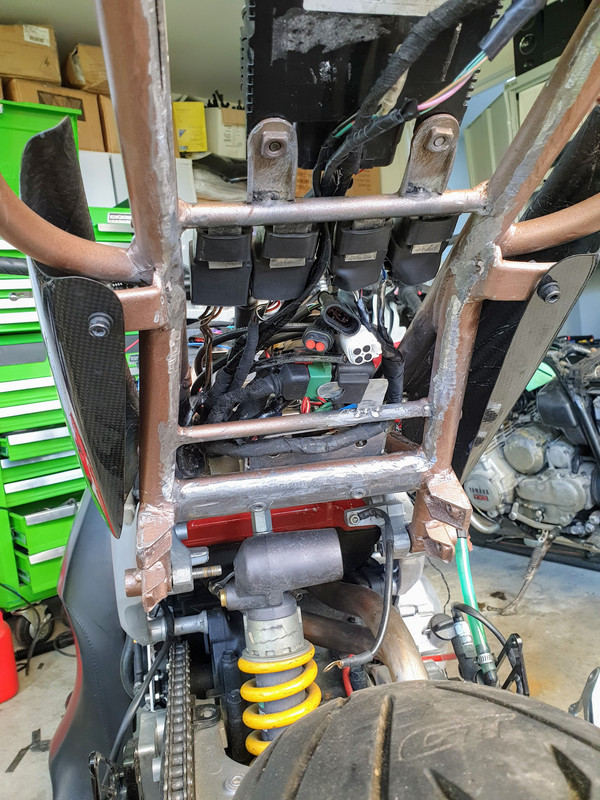

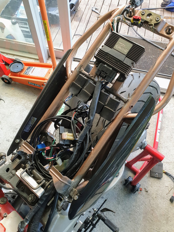

Picked up a set of carbon fiber panels off eBay for a steal so I whipped off the subframe to weld on some brackets and make some fitment adjustments.
https://i.postimg.cc/FKrqc1Gv/20190826-121426.jpg
https://i.postimg.cc/PxcFByHf/20190826-121432.jpg
While I was in there I cleaned up my wiring layout and welded on some proper brackets so my components are no longer held on with hopes, dreams and zipties.
https://i.postimg.cc/cJFzcZ5n/20190826-153341.jpg
https://i.postimg.cc/W3tHWKQf/20190826-153352.jpg
The fairings do a great job of hiding the wiring :)
https://i.postimg.cc/4xbqmp6w/20190826_160759.jpg
